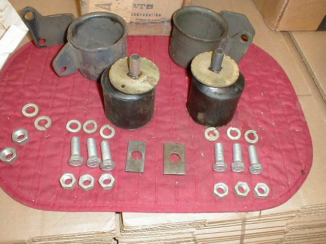

I got a picture off the internet. The bracket attaches to the motor and the rubber mount goes in it. It faces with the stud facing down and gets a large washer with a bolt to tighten it.

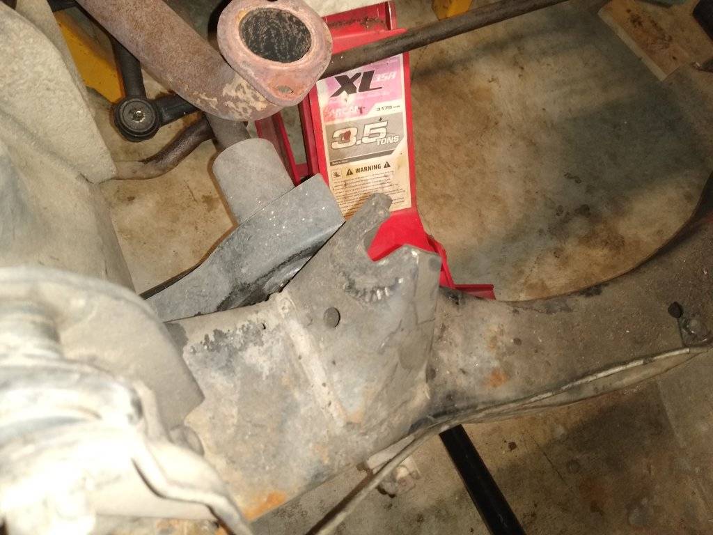

They go on the block and engine frame horns a certain way. Otherwise the transmission mount won't fit and the engine is too close to the steering box. Fury 318:
