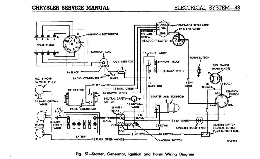

I could be wrong with this, but I looked at some '57 and '58 FSM wiring diagrams and that's what I'm seeing. I don't have a '58 Plymouth FSM, but this is from a '58 Chrysler FSM.
I couldn't remember if that was the case or not. If this truly is the case, then the issue is not the ballast resistor. The current ballast resistor's state can be measured right now by a multimeter.

There's really just one circuit, no separate run and start. From looking at the FSM wiring diagram, I think the key switch also is the starter switch (as opposed to a separate button) so it's possible the ignition switch is a problem, but I kind of doubt it.
I think the easy way to test would be to eliminate the ignition circuit and run a jumper wire from the battery to the coil and see what happens. That would bypass the entire ignition circuit, including the BR, so not for any use past trying it in the driveway.
