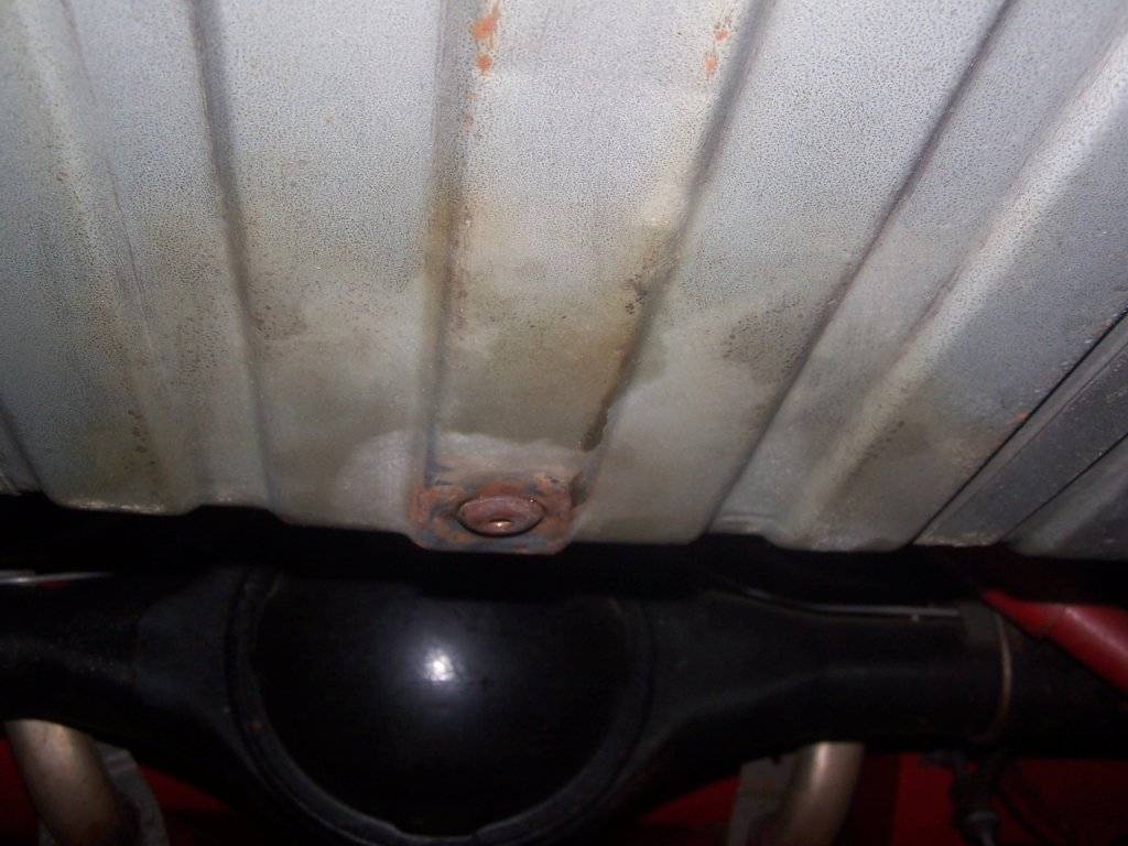

No help for you but My 60 Dart has a drain plug. I drained it once back in 1983 years ago when I restored the car. I do not remember what if any seal was there but it has not leaked or been a problem. Maybe yours was just loose. Here is a recent pic.
Thanks for the photo of the tank with the plug. At least we know what the outside looks like. @WikedPlymouth , we need a photo or two of the plug and where it seals against the tank to be able to help here.

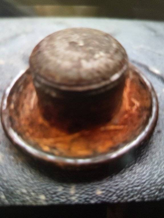

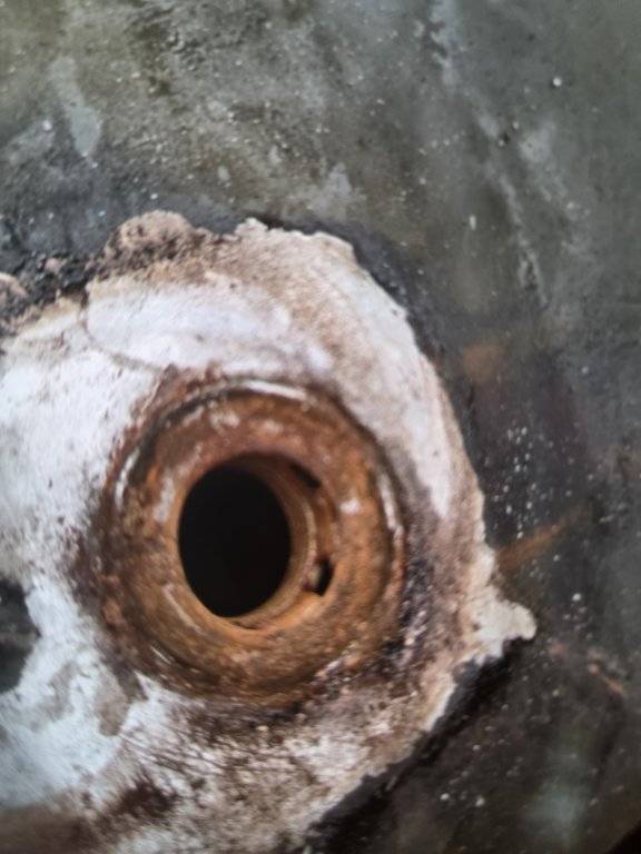

Attached are pictures of the old tank drain plug and threads. These were exactly like the replacement tank I got from Big M Auto.
Are you referring to the ridge around the outer edge of the drain plug? The old drain plug had a very crusty and dried gasket of some type that filled in the concave area under the drain plug head. It was where the rusty orange look is on the drain plug.
