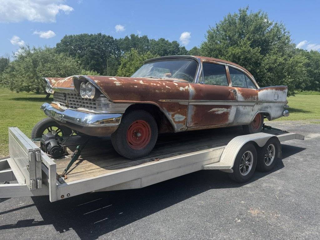

Hello fellow Mopar lovers, I recently picked up this 1959 Plymouth Savoy, no engine in trans from Arizona pretty solid car. It has a few holes in the floor and trunk and the passenger corner needs repair. What I’d like to do with this one is keep it stock looking. I wanna switch out the 14 inch rims for 15 inch hubcaps or dog dish style, i’ve got a 392 four barrel from a 1958 that I’m gonna put in it and build it like it was a 1959 superstock car if that makes any sense not that they made one from the factory, but maybe they did know about it that’s what I’m looking to do. I’d like to upgrade the brakes to the front. I would like to see what Mopar rims are interchangeable to put on this car. I’d like to run skinnier in the front wider in the back and any pointers as to bolting the 392 or what I might need engine mount wise to do that I have a 1964 Dodge with a 361 and a push button Tran. I don’t know if the trans is interchangeable , this 1959 Plymouth bill so I’m just getting familiar with the “C” bodies.
Thanks in advance
That 59 is a forward look car. The first C-body was 1965.
If swapping the trans use one with a slip yoke for the driveshaft. A727 will not bolt up to that 50's hemi. Trans adapters can be bought but are not cheap.
