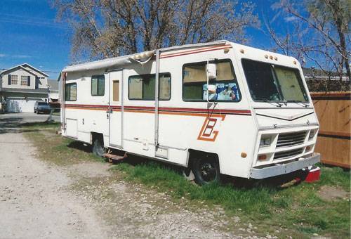

14000 lb GVWR dodge chassis... Georgie Boy shed put on it... All pieces riveted to the frame nothing I saw looked "unoriginal", the rears had no park brake provision.... here are tonight's bad pics...

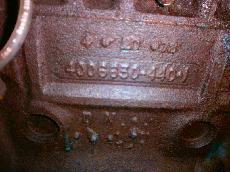

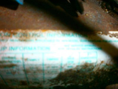

the first is the really washed out pic of the 1978 date on the emissions label... on the V/C because it was a bare chassis from the factory. the second is the block... and yea... its a440-1 ... isn't that the steel crank everyone wants? Seriously, not a thing appeared out of place for original... class a just got the on dash cable shifter... I 'm thinking I want to get under a PB car to see if my length is the same... and I don't usually want to measure.

nope, FC ... it was very similar to this one. 28ft dodge chassis... everything looked like it was there from day 1... I did a lot of work on this mess and even lived in it for 6 months in Naples 4 nights a week. never saw a thing to make me think something wasn't original crap motorhome... caused me to buy a bus it drove so bad. the frame had a small 6ft or less extension welded in... we striped it to the frame to build the bus and the thing look all factory built.
The emergency brake on that trans should work. It might not be a direct bolt up, but it doesn't seem to me that it can be too different.
I remember having a 67 D100 with a cable shifter, but the trans itself was nothing like the 65 and earlier were the cable hooked directly to the valve body (I am a little fuzzy in remembering the exact configuration).
It may be shifted with a cable but it isn't a cable shift trans. The last year for those was 65.
The only way to put a 440 in a pre 62 car and keep the pushbuttons and the parking brake is to use a 62 trans.
