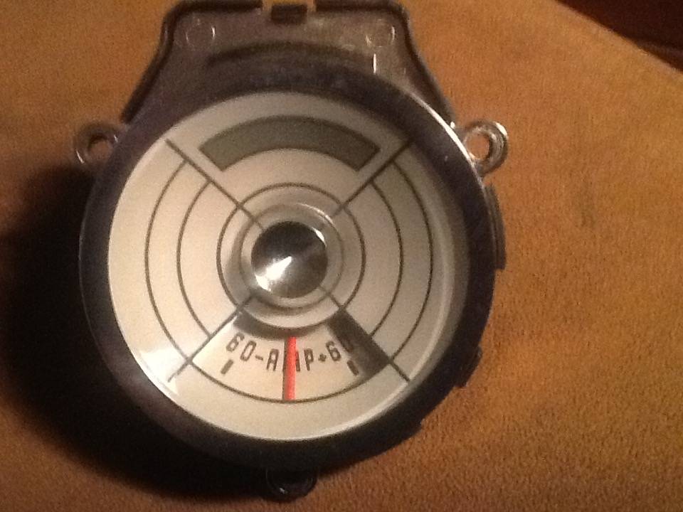

l got this NOS amp guage from AMS auto. I didn't notice in the pics it has the 60 amp vs the D/C one that are In my 61s? Is this for police cars or export?
60 amp is pretty high, so you might be right about a heavy duty application.

I have a original 61 alternator on the way from a 318 61 Plymouth. I'm sure it's a standard 40 amp.
Do you guys think it will be OK use 60 amp guage with 40 amp alternator?
It'll be fine as long as you don't expect it to register full scale...... :poke:
[QUOTE="SGT FURY,
Do you guys think it will be OK use 60 amp guage with 40 amp alternator?[/QUOTE]
Yes.... But as stated above, the gage will read a little lower. Should be in the mid range of the gage with a full charge.

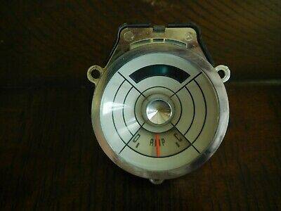

I think it best to use the original C/D gage and make the HD gage available to someone who needs one.
