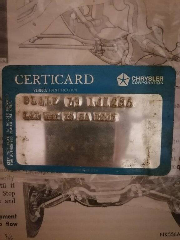

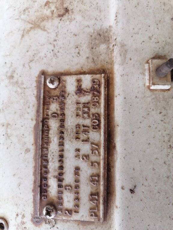

HI Bill please excuse me for high jacking this thread, I reside in Durban South Africa and have my late dad's 67 Plymouth fury 2 sedan 4 door with the paint code WW 1.
Which is stamped on the plate on lefthand side wheel arch however there is also a card in a plastic pocket just behind the battery with completely different numbers "unless I'm reading it incorrectly" which one do I refer to in general?
