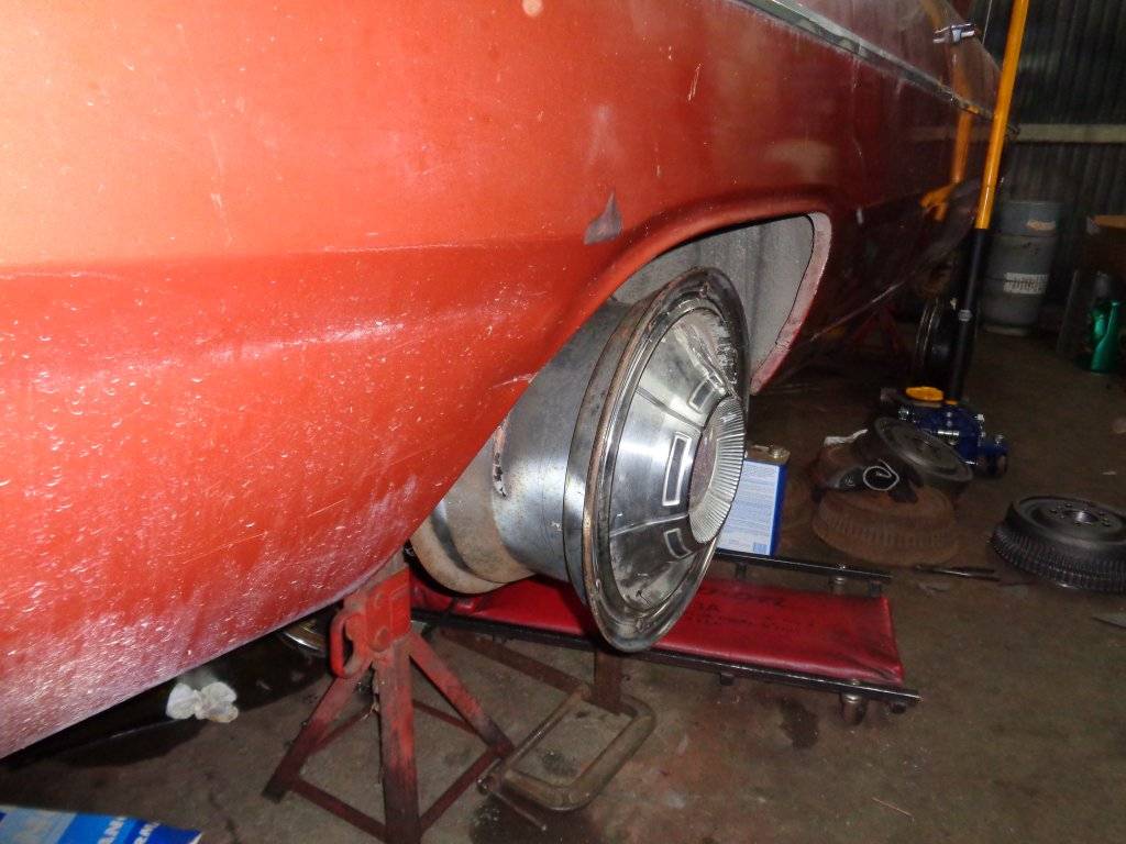

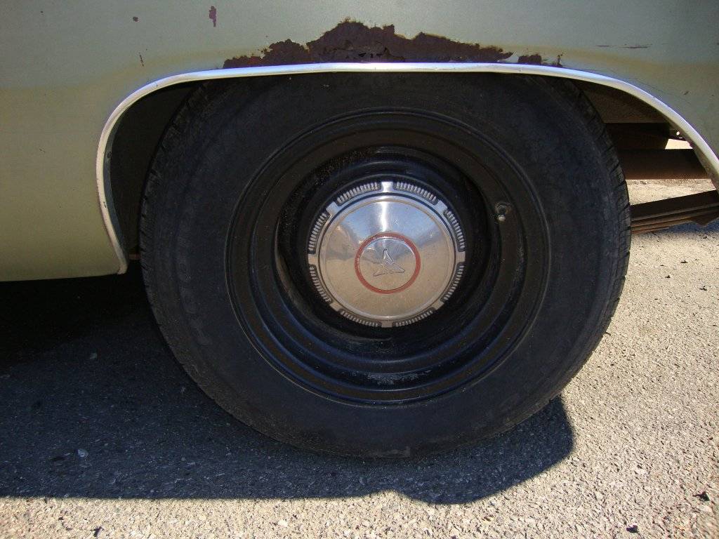

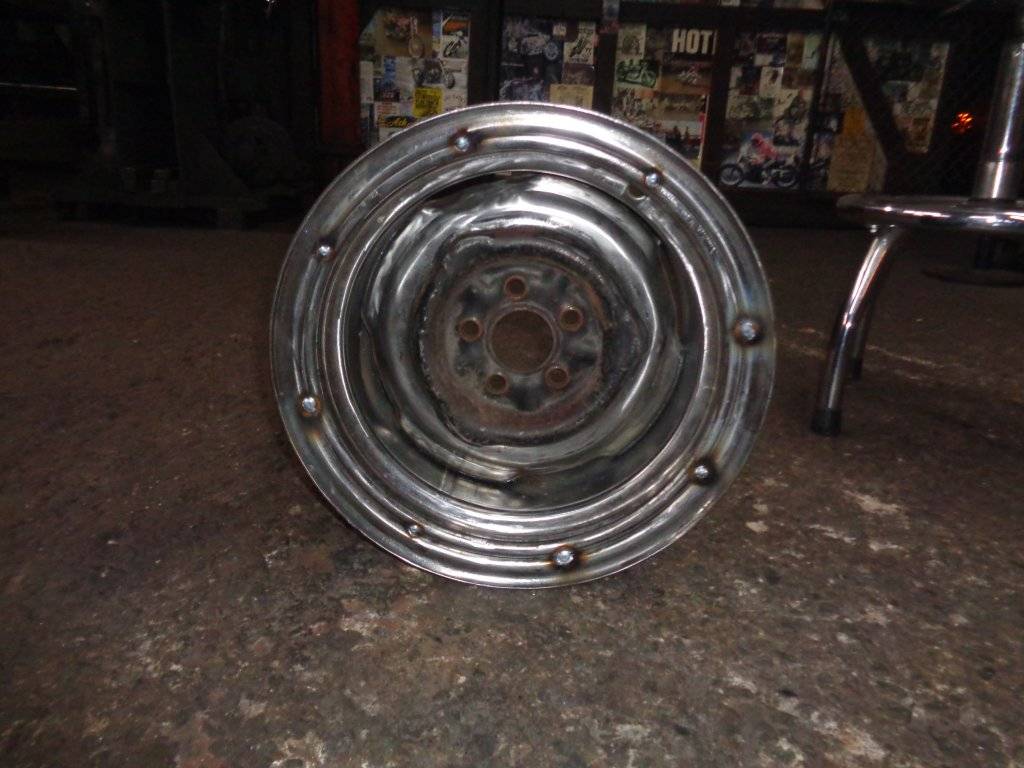

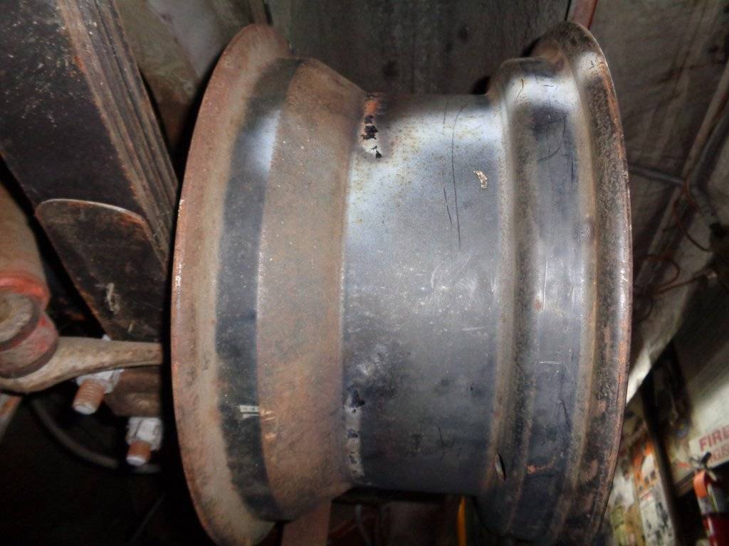

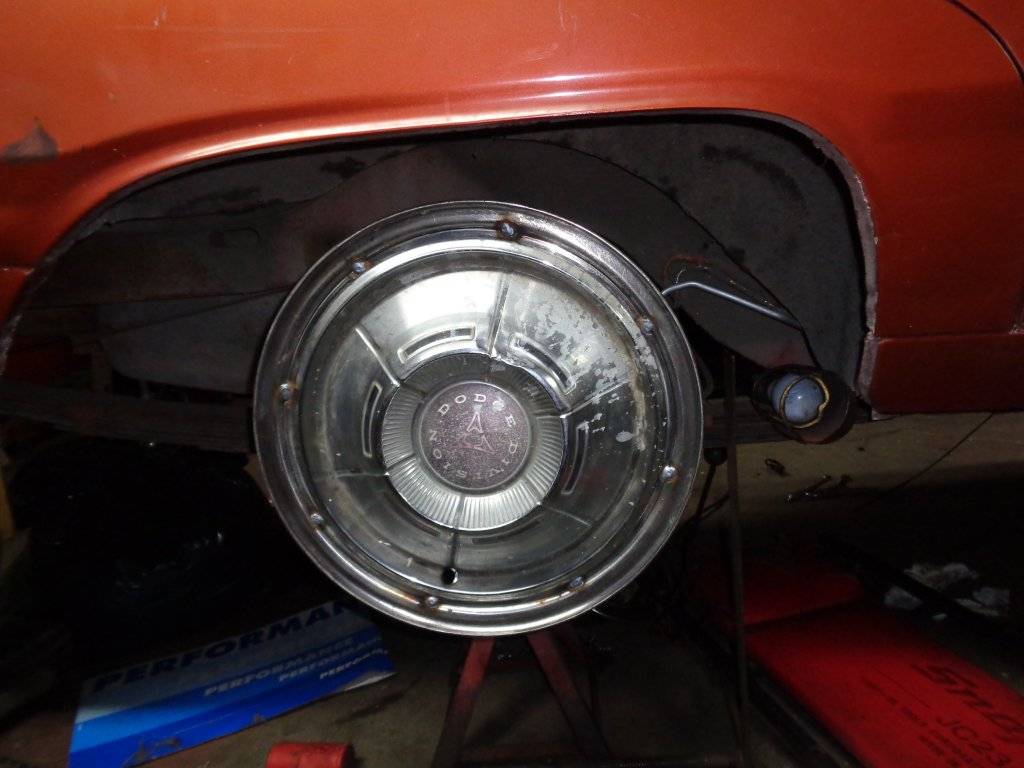

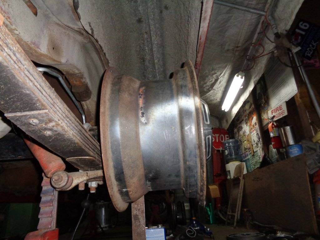

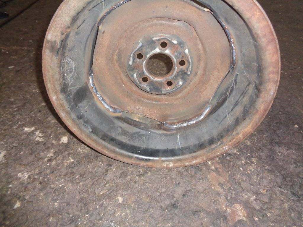

okay , the 75 imps are 11,75 , i like your idea of 72 chrysler rear drums , used them on a modified dana 60 in a 70 dart more door , customer wants to run his stock wheel covers , that's a 14''cover and we made some 15x8's for the rear of the car since there is a hp440 under the hood we needed to get some tire on the rear , so i built some custom rims so we could run his covers on the car . and because he choose the 4'' bolt pattern we used the 14'' rim centers and the part that holds the wheel covers off and made our own rims .
yes that's a tight fit , did the same rim bands on my 69 dart gt very tight on the springs , but never an issues even on a twisty road through the mountains .
Nice job on the wheels.
