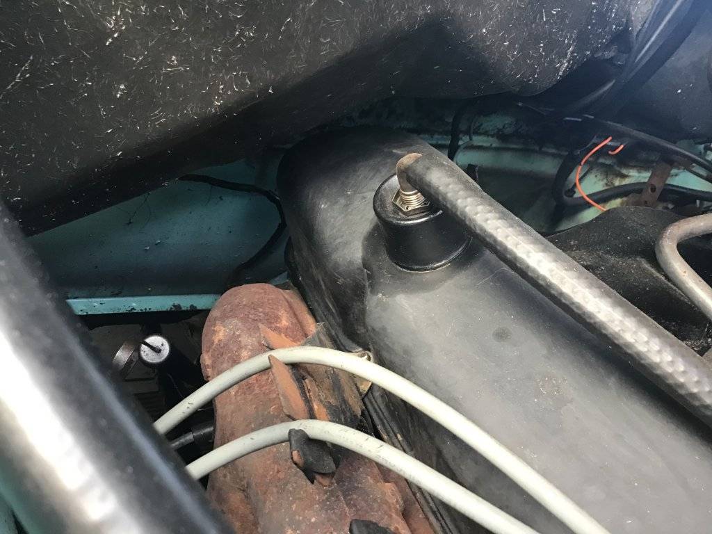

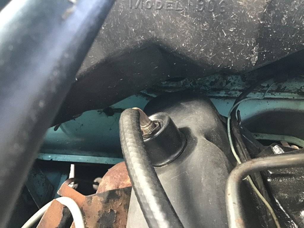

Here is a 61 Chrysler with AC, this one came off with very little wiggling of the cover, not a problem. Do you have this much room in the Imperial?
I was able to remove the valve covers off the 440 in my 66 when I replaced the gaskets years ago.
"On air conditioned cars, rotate the crankshaft until the number eight cylinder exhaust valve is open, to allow clearance to remove the right bank cylinder head cover and the heater housing." This really works, you get the cover loose, move it up and twist and pull sideways and it comes off. Or, you can lower the back of the engine an inch with a jack under the rear mount and remove the six bolts holding on the frame cross member. Or, you can remove the heater core, careful not to crack the housing at the bolt holes, run a dull knife around the butyl seal and off it comes.
