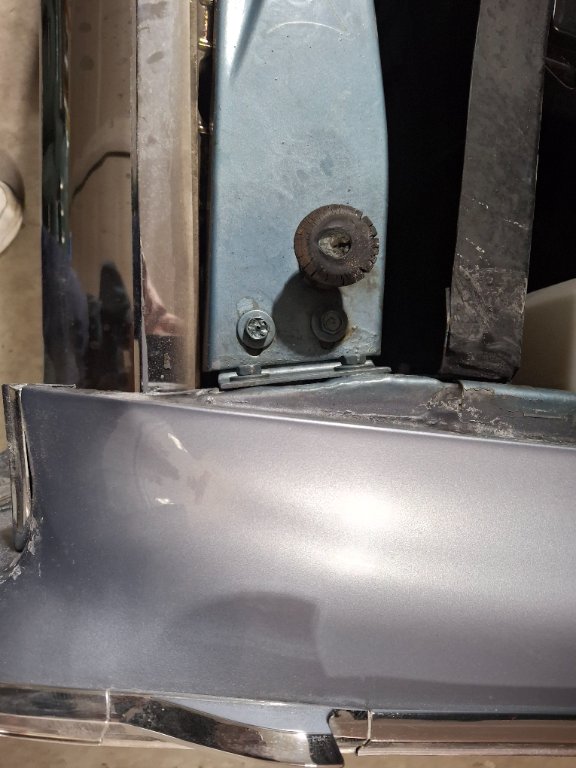

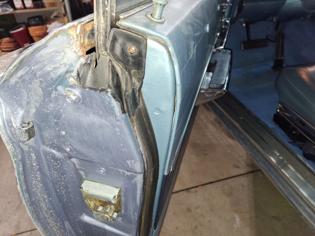

My car is originally FF-1 Mist Blue, and was repainted a bit ago (unknown) some nice blue color that I don't know what it is. Clearly not re-painted Mist Blue, as you can see the original color in the engine bay and part of the door jambs. I will be taking it back to the original Mist Blue. I want a good #2 job, not a 100pt resto. Seems Laquer is not recommended, although that's the original type, yes? I don't want a BC/CC, as that looks artificial vs. what these cars used to look like back in the 60s. Then theres the primer, etch, etc. etc. etc.

looking at TCP Global's auto paint library for a 65 Chrysler I wonder if they repainted it 66-1 mauve poly? I think the area of the door inside the rubber weatherstrip is the original color...different interior colors were usually on bolt on parts like the dash...I don't think they would bother to mask off the door and just spray that small section an interior color, it would be the same as the rest of the door
I would agree. I have found a local shop that does restos and will be getting it repainted in the original Mist Blue in a couple of months. Thanks for all the help folks!
