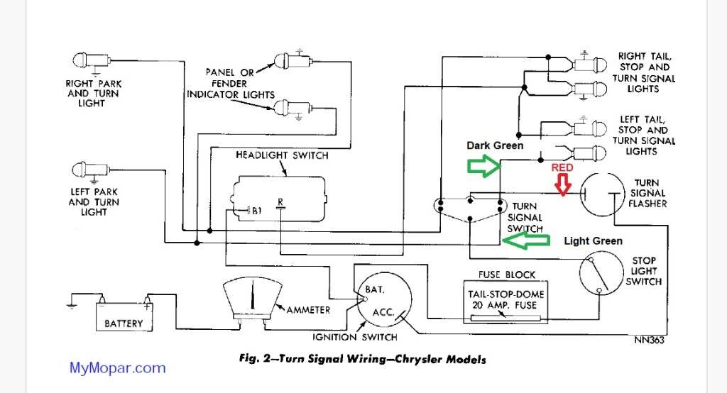

I unplugged the flasher and with a test light I had power at one terminal but not the other, no matter if the turning signal lever was moved to the right, left or middle. Based upon my last two responses do you think it is the switch at the steering wheel?
You'll only have power going to the flasher. On the output side of the flasher, you will have pulsing (on and off) power, but ONLY if there is a load (that is a working light) on the circuit. Flashers don't work without a load on the circuit.
To check the switch, turn on your ignition to accessory first and then turn on your right (working) signal. If they are working, you are getting power, the flasher is working, the switch is getting power, and that side of the TS switch is good.
Now unplug the harness, turn on your left signal and check for continuity between the dark green and red, then between the light green and red. Those are coming FROM the TS switch. I have marked the wires for you in this picture.
If no continuity, it's probably the TS switch.

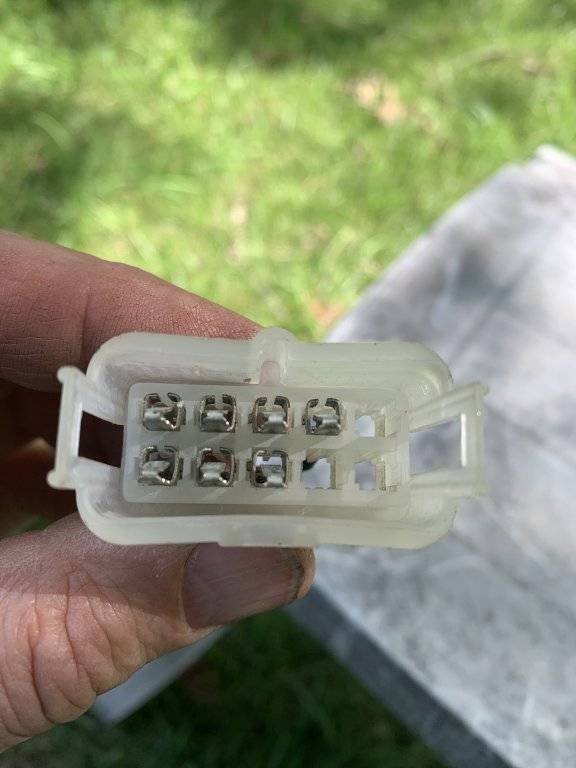

It is the switch. How do you get the plug off of the end of the switch in order to pull it through the steering column? I can’t seem to get the male prongs out of the white plug.
How do you get the wires out of this plug?
That is how to do it with the tool. It will start about 7:36.
IIRC, (it's been a while) you can stick a pair of needle nose pliers in there and squeeze the square piece as you pull the wires out.
