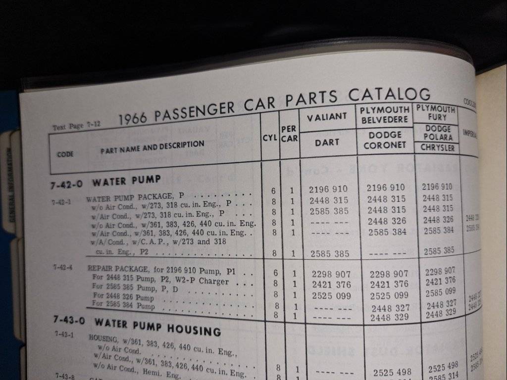

Does anyone have the factory Mopar water pump on their non-A/C, non-California 383 1966 Fury that can look at the casting number? I am looking to confirm what the original casting number was for my '66 Fury III. Per the parts book, it appears it should be *part number* 2448326, but that is not going to be the same as the casting number on the pump. The shop manual says it's 10 blades 4.38" diameter for 383 2 bbl and 4 bbl cars without A/C or CAP. I am looking to identify a proper original for rebuild for my survivor car to replace the aftermarket one. Finding a core isn't difficult once I know what I need. I am not interested in an aftermarket solution. Thanks in advance.

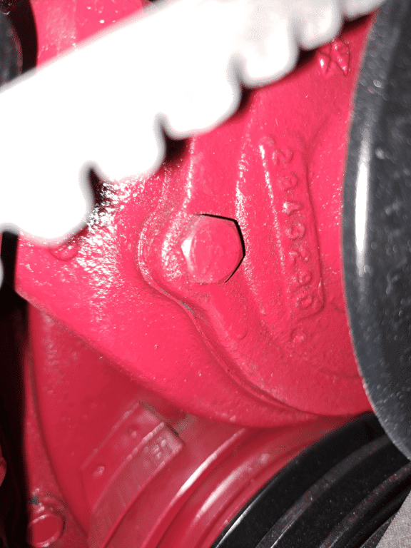

I will try to get a pic of the water pump on my 440 (which would be the same) - I know it's been replaced with another Mopar casting, but I can't guarantee if it's a later or correct part number.

2843 290 is the number cast into the water pump on mine. It's genuine Mopar as indicated by the pentastar above the number, but the number indicates it is a later model year version, most likely 67 or 68.
I looked in my 67, 68 and 69 catalogues, and nothing comes up for that number. The water pump part numbers are the same for big blocks without AC for all 3 years.
I think you're right, and in this case the casting number doesn't go with the part number, due to the casting working for both AC and non AC applications.
