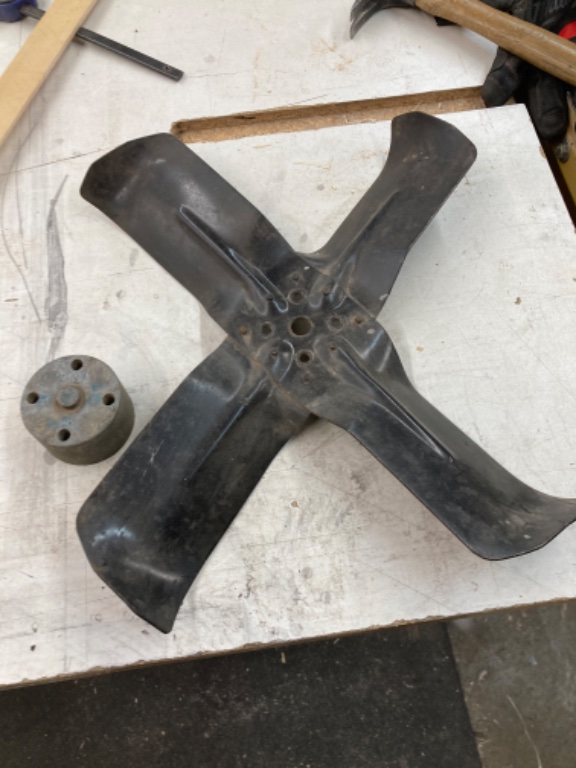

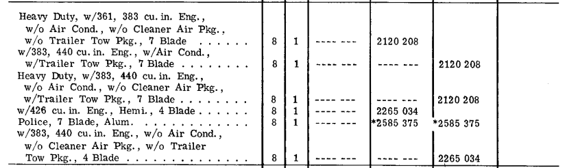

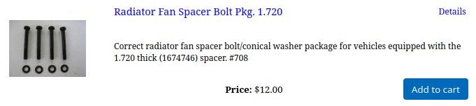

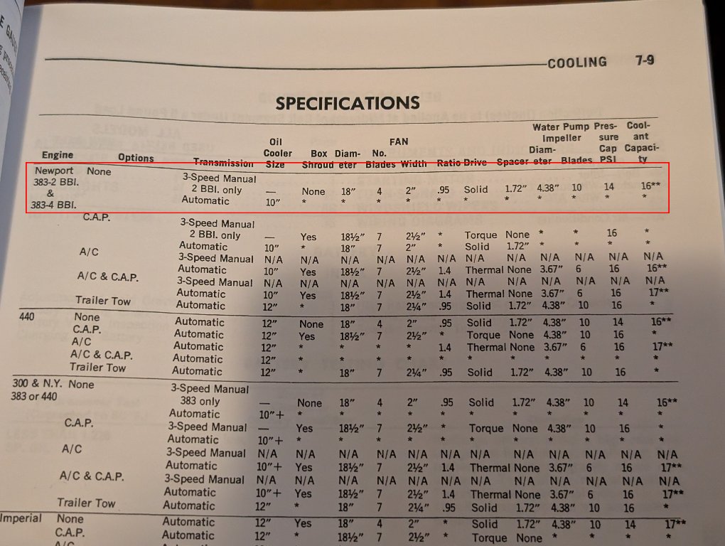

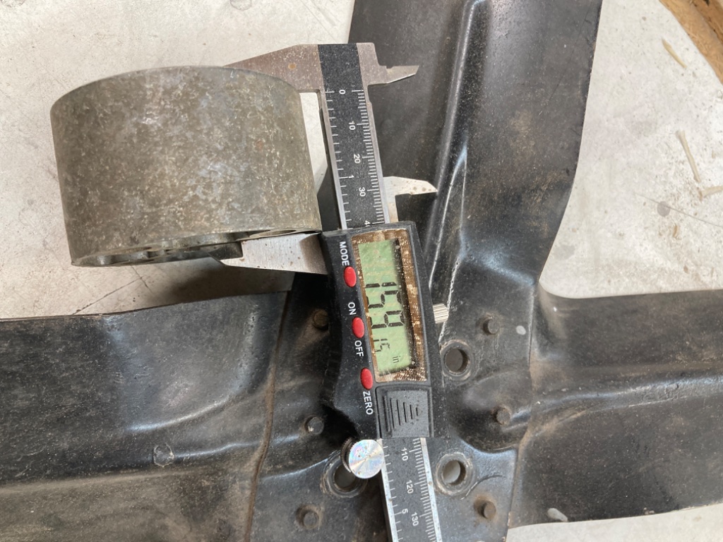

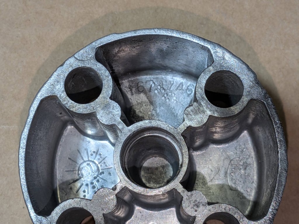

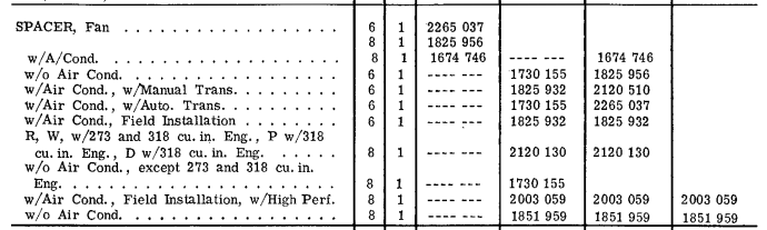

Anyway, about a week ago I found the complete fan setup on eBay. It included the 4-blade fan (PN: 2265034), the 1.720" thick spacer (PN: 1674746), and the factory hardware.
According to the factory parts book, these should be the correct parts that originally came on the vehicle.
I may still upgrade to the 7-blade setup down the road, but this will do for now.
I’ll let you guys know how the 4-blade install goes.

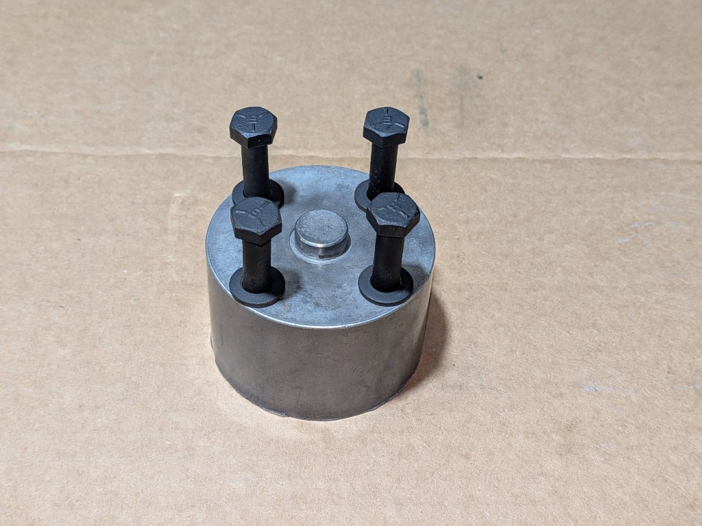

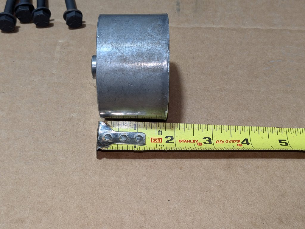

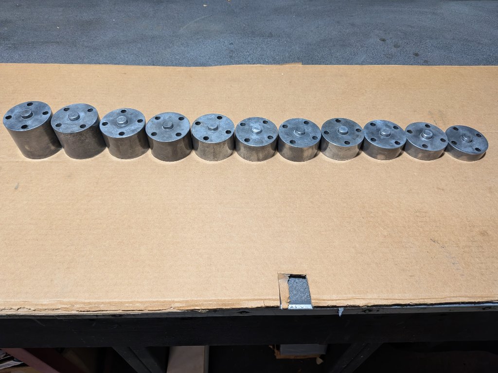

Measure the space between the pully and the radiator. IMO I think the closer you are the more air you will pull.
Okay, I got the new fan setup installed. The distance between the leading edge of the fan and the radiator is about 1 7/16". Even with the biggest spacer (2"), the gap would still be well over 1 inch.
