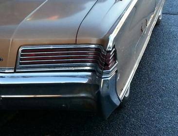

My first question is: Can anyone tell me if the tail light assembly is one piece or two? And does anyone know where I can get a replacement for this passenger rear? Thank you in advance.

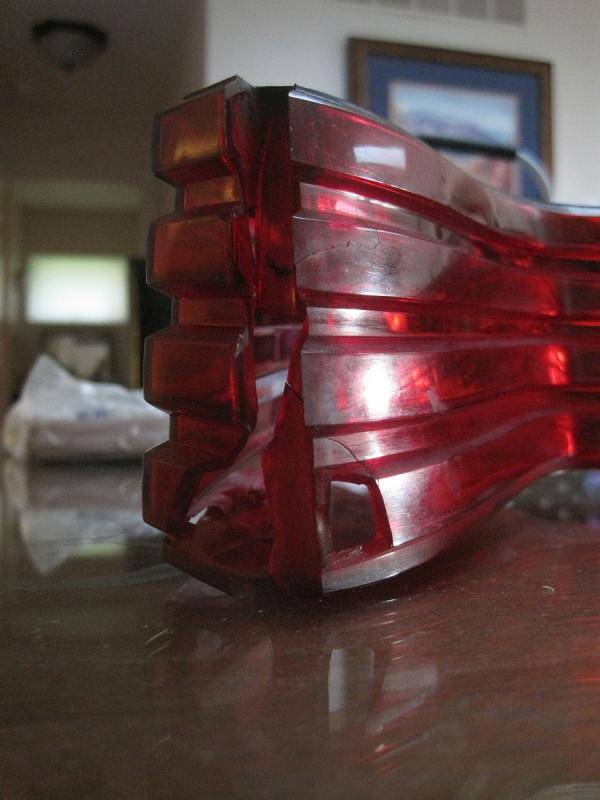

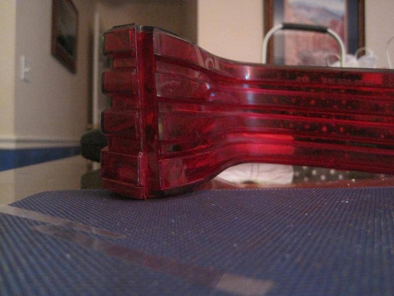

Been there, it is actually 2 pieces you don't want to know the price if you can even find one. To repair the lens you need to take the bumper off to get to the screws. If I remember correctly the cheapest I have seen the rear lens is $650 per side. The part of the lens that is broken is the section that is always broken. The second piece is the flat portion towards the center of the car. I did a repair on the lens that I am very happy with.
Here is a link to my repair. http://www.forcbodiesonly.com/mopar-forum/showthread.php?7082-Repairing-the-rear-lens
