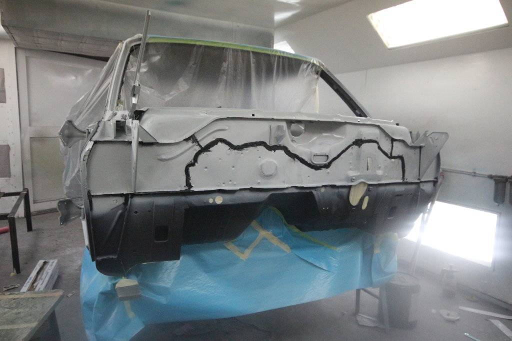

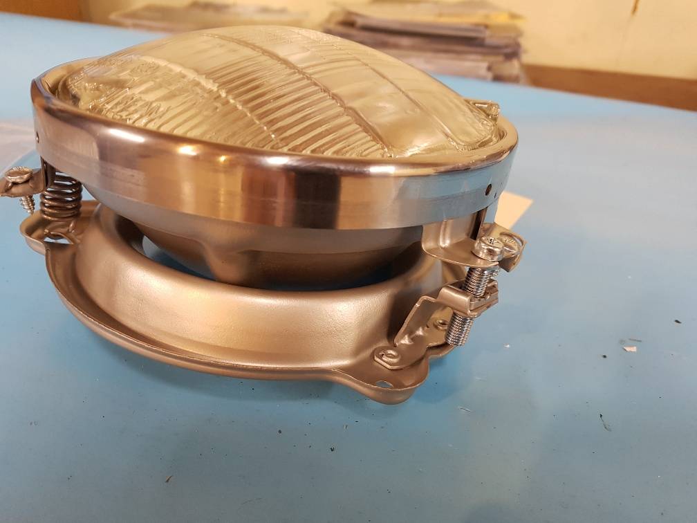

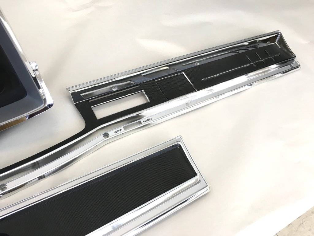

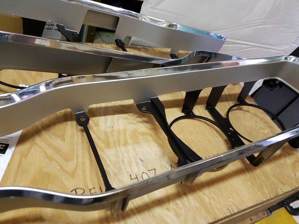

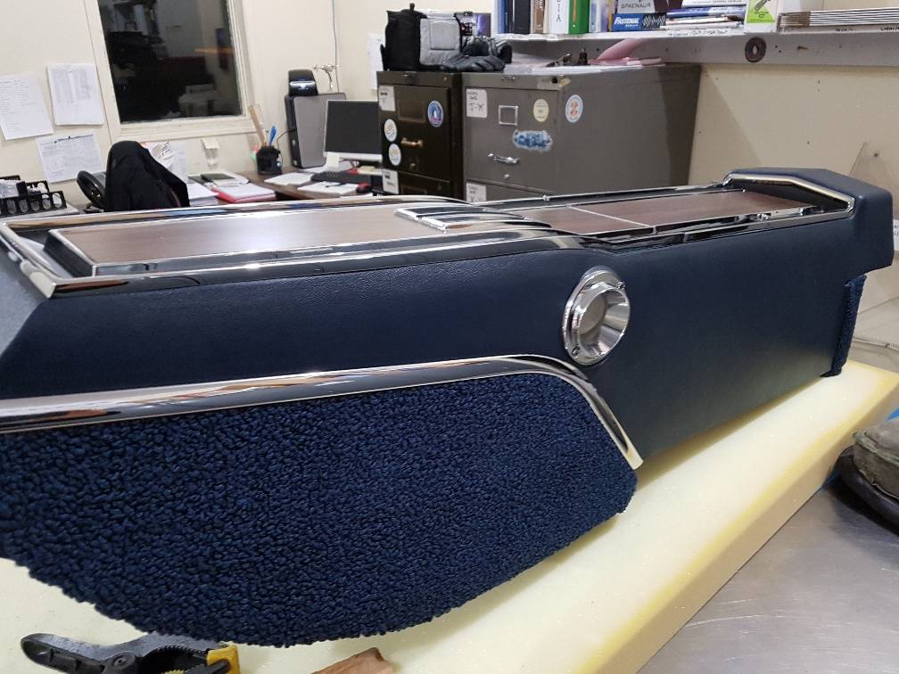

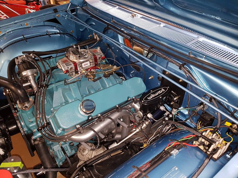

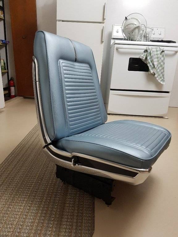

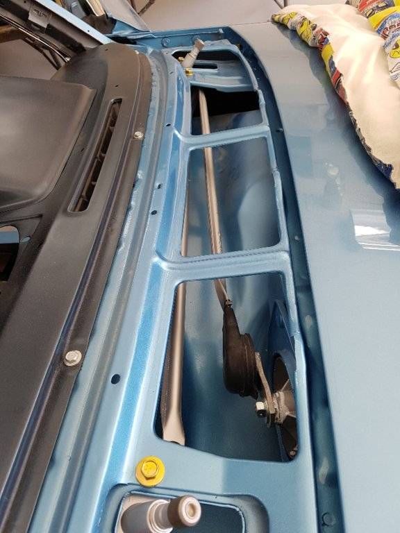

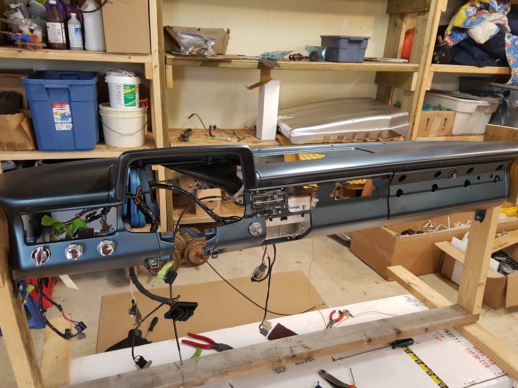

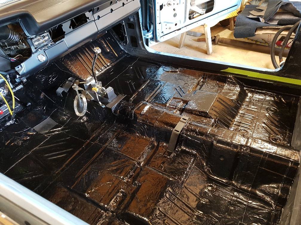

Here's some more pictures of the resto - Some little tricks I did was the lower column support bearing is fabbed from stainless instead of the brittle plastic, upgraded to Borgeson style u-joints when I converted from Power to Manual steering and for the front seat trim pieces and rear taillight bezels that originally were painted in black
, I used black vinyl from a sign shop and it turned out pretty slick

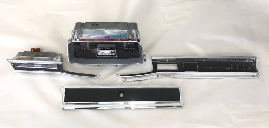

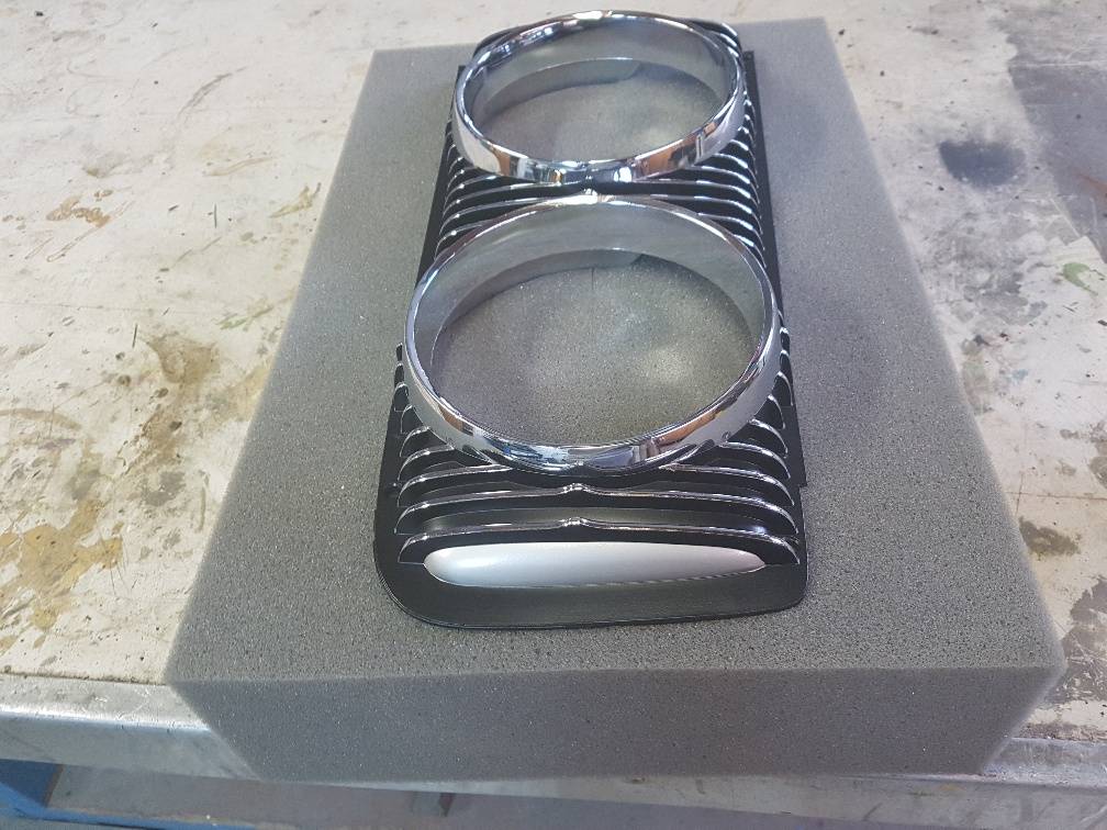

Fury Pursuit - Here is a better picture of the Radio/Clock delete plate. I searched for a long time to come up with a factory setup as it was a key part to my "Less is more" theme of the car. The radio portion is molded in from the mfg, but the clock delete is a plate that is fastened from the backside. One of the many parts that the guys at National Moparts helped me out with.
