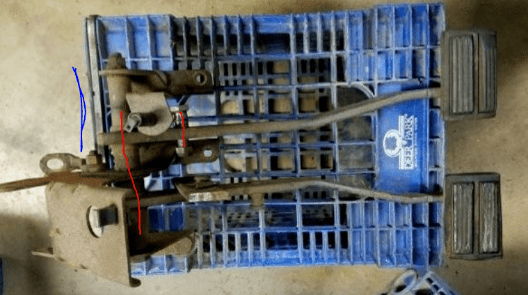

I know from previous posts manual and power pedals on these mid 60's C bodies are different but why is that exactly?
It's all about different leverage points between power and manual brakes. In the pic below the LH red line is the pivot point, the RH red line goes to the MC pushrod. For PBrakes, the pivot point would be raised near the blue line, to reduce the leverage. (that is sometimes hard to visualize)
Of the Fusey pedals I pasted earlier, I cannot tell in that pic if for PB or MB.
