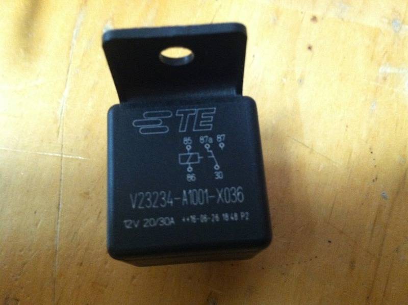

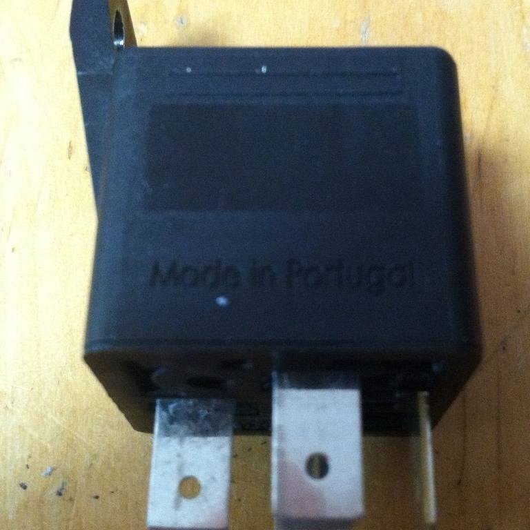

The only relays to buy are the Bosch/Tyco brand. The relay should look like this with the word "TE" (Tyco Electronics) and should have "Made in Portugal" on the side.
I buy these: https://smile.amazon.com/gp/product/B000P61E36/ref=oh_aui_detailpage_o02_s00?ie=UTF8&psc=1
These are the genuine Bosch/Tyco relay and made in Portugal.
The Chinese relays aren't worth bringing home.
I buy these: Amazon.com: Metra Install E-123 Bay Tyco Relay 12 Volt 30 Amp Each: Car Electronics

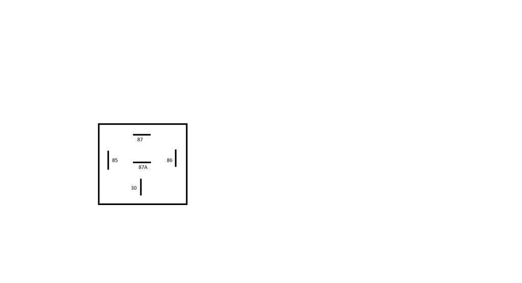

There's a couple ways we can check this. First is with a simple test light or a volt meter. I know... You are "electrically challenged".. I'll be gentle. We'll use a test light.
See the attached diagram. Remove the relays and clip the test light to ground and probe into #30 and #87. Light switch off.
One or the other (not both) should light the test light. Remember which one did. Let's say it's #30. That checks for battery power for the headlights.
Now clip the test light to the positive pole of the battery and now probe #85 and #86. One or the other should light the test light. Let's say that's #86. That is checking for ground.
You can check all the relay sockets like this.
Assuming that the two outside relays are low and high from your description, you are going to check those one at a time.
Switch the clip on the test light back to ground and now turn the headlight switch on and probe the other slot. In our example, that will be #85. If it doesn't light, hit the floor switch and see if the test light lights. If it does light, hit the floor switch and see if it doesn't light.
If it's wired like I think it is, the center relay will work (light the test light) when the high beam relay works.
The last step checks the connection to the headlight switch.
