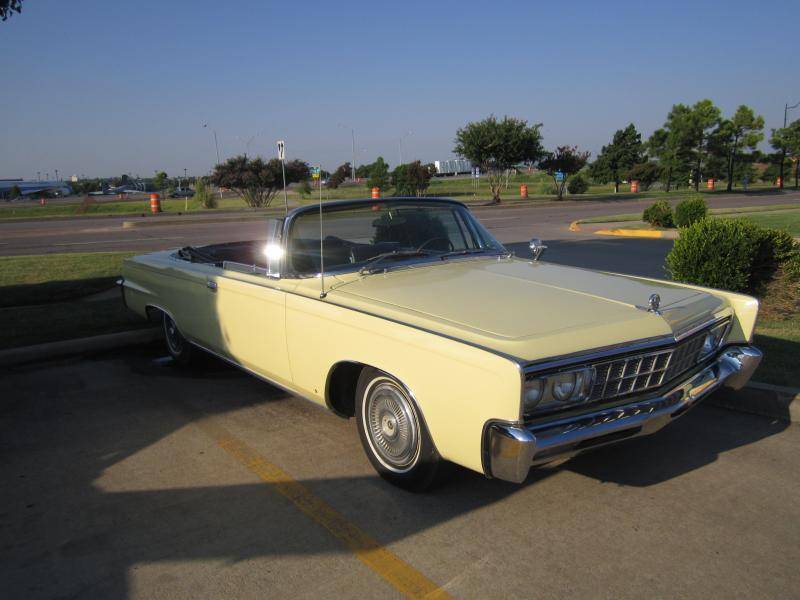

Went to Cars-n-Coffee today and had the top down...had a ball! Imperial at cnc01.jpg
