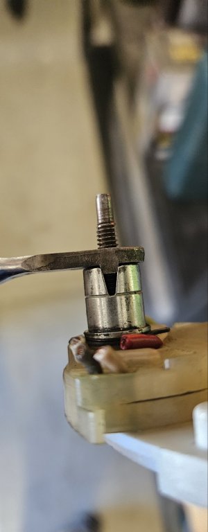

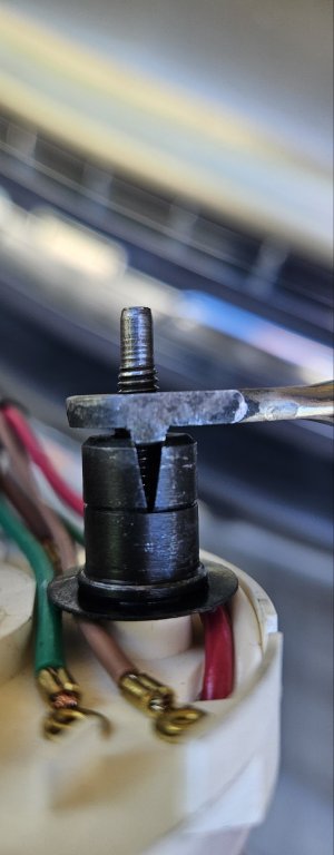

I had 2 of those switches and the problem i had with each one is the tabs on the lever didn't fit into the 2 slots on the back of the switch like the original switch, which caused the the whole mechanism to not work properly.
I just pulled the same one I have off the shelf (long story how I ended up with it) and it looks like it's a pretty easy fix. I'm not sure if hardened, and if it isn't, about 3 minutes with a small file would make it work. If it's hardened steel, 2 minutes with a dremel tool.
I thought about taking a dremel to it but considering some places won't take an electrical item back, I figure if the part doesn't work AND it's been modified, they for sure won't take the part back. But, I may have to bite the bullet
