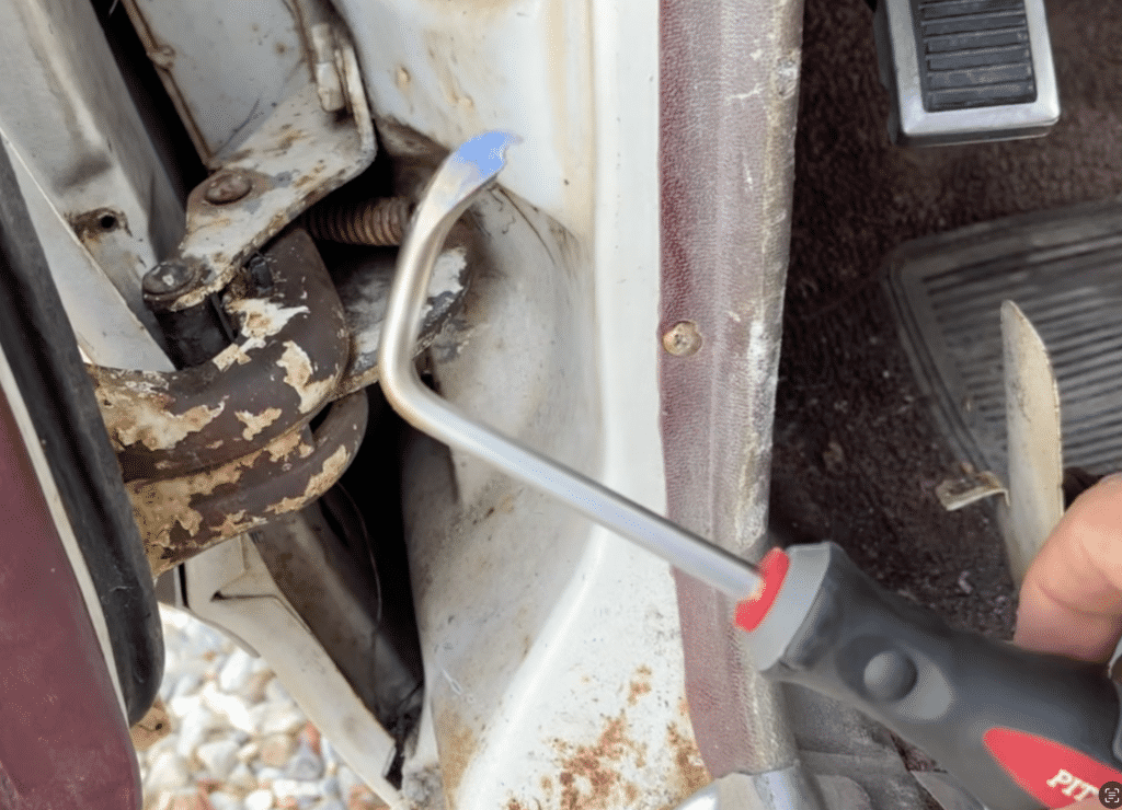

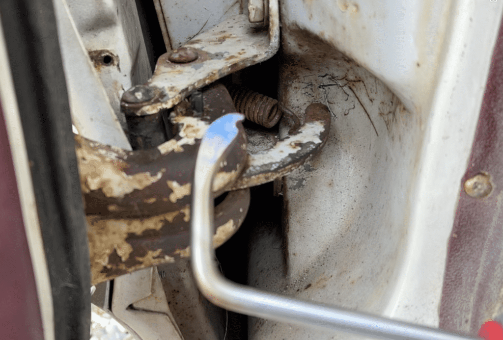

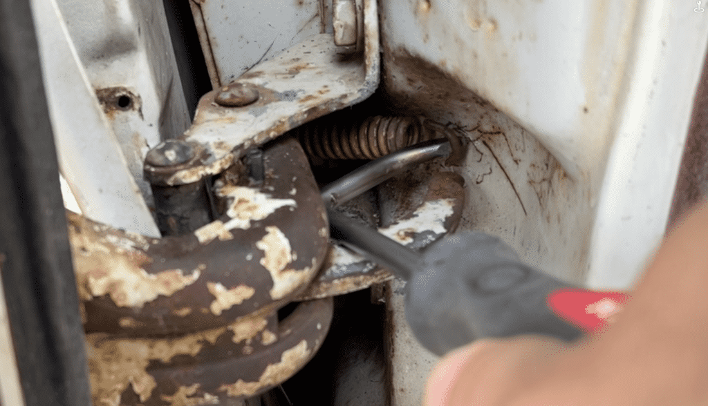

Then stretching the spring was the real nightmare. After trying to pretzel myself into position to actually get some leverage to pull on the spring, I finally fought through the red haze of fury that was descending over my vision, and had the presence of mind to just go ahead and make a tool to hook the spring and lever it into place. I took a large screwdriver and ground a notch on the side of the tip and then bent it at the appropriate point. Basically a tiny crowbar.
If you want I could probably send you this tool I made, because I sure don't ever plan on or want to go through doing that again! If my pain can help others avoid the misery and frustration of installing these springs I would be very happy. But I tell you, the luxury of finally having doors that stay open and not hit you in the leg every dang time or slam shut every time you turn your back was worth it!

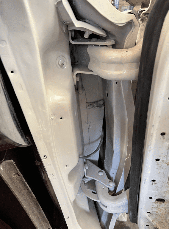

(Last photo is after I finally got the jambs painted)
I was thinking it would take a little ingenuity to get that spring stretched to the arm without having the hinge clamped in a bench vise. Your tool looks to be the ticket. Thank you for sharing.
