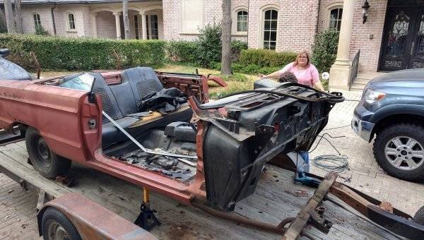

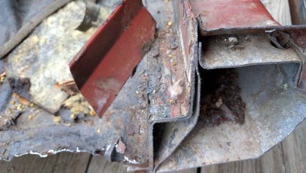

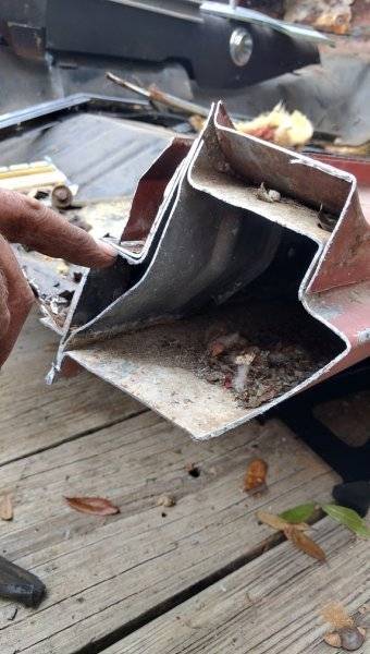

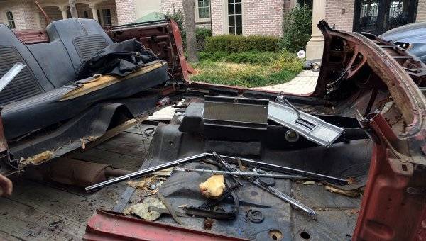

Now, back to the car! The floor pans that we bought from Classic2Current weren't enough metal to fill the holes! Mary is rusted out pretty badly. We considered using Gecko's floor, but, it's badly thinned out in a few spots and someone used POR-15 to trap water on it years ago. So, we used it to learn how to cut one apart without bending up the floor too badly. We supported the center of the car and pulled the K-frame. Then we cut off the top. Then we cut the flat section of the floor where the rear-seat passengers' feet go and opened up a hole by the rockers to allow the tip of the sawz-all blade to clear as we cut through the rockers. The floor and cowl fell free and, if we were to use the floor, we'd then cut the cowl off and start peeling back at the rockers.
We next unbolted the rear springs and pulled the rear end out from underneath the back half of the car. What's left is pretty much scrap!
