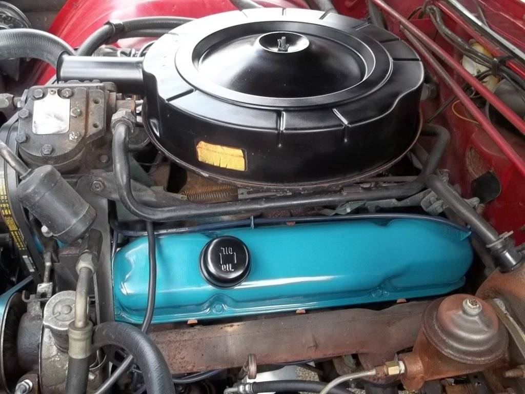

During a break on Friday, I pulled the valve covers off to have them hot tanked. I was surprised by how clean the rocker arms and underside of the covers were, but the drivers side had some pieces of valve seal in the oil rail. So a valve job is in the future.

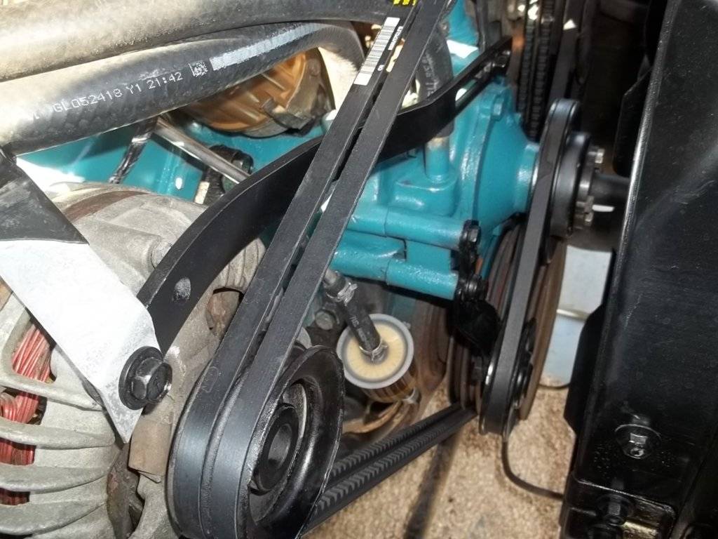

Anyway I got the valve covers back and while they are oil and paint free, there's still gasket material and rust to remove. So I've fired up the wire wheels.
The front cover hasn't been worked yet, the rear has about 15 minutes of wire wheelin'!

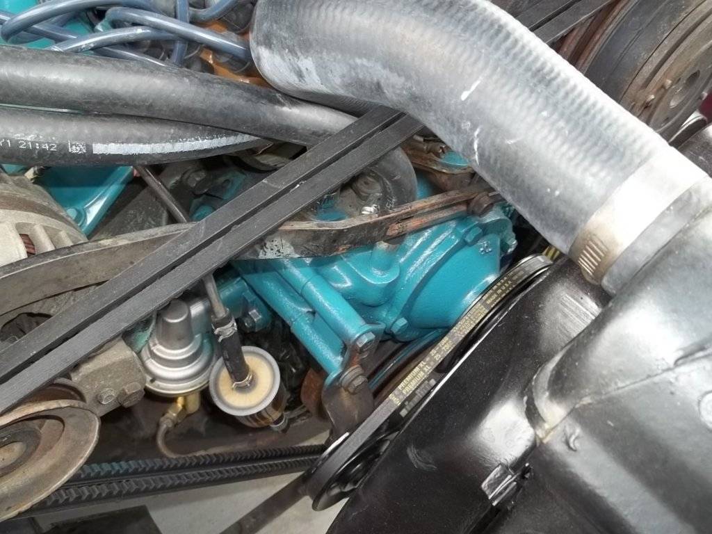

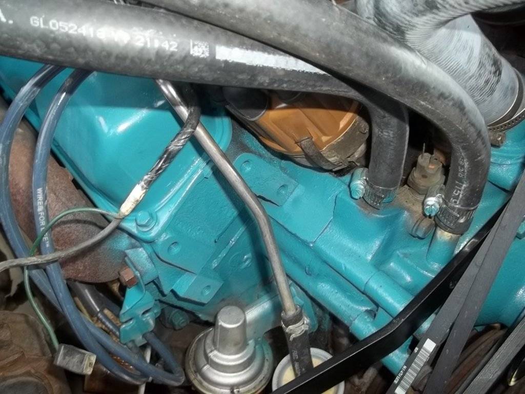

The valve covers were installed. A fuel leak (my fault ) sprayed gas on the rh cover and caused some wrinkles in the fresh paint. Sanding a re-shooting on the car were moderately successful. Hoses wires cover it as well.
I also resprayed the oil cap, polished the fuel line to give it a like new look and washed and sprayed the air cleaner top. I also re-shot the earlier attempt at painting the water pump.

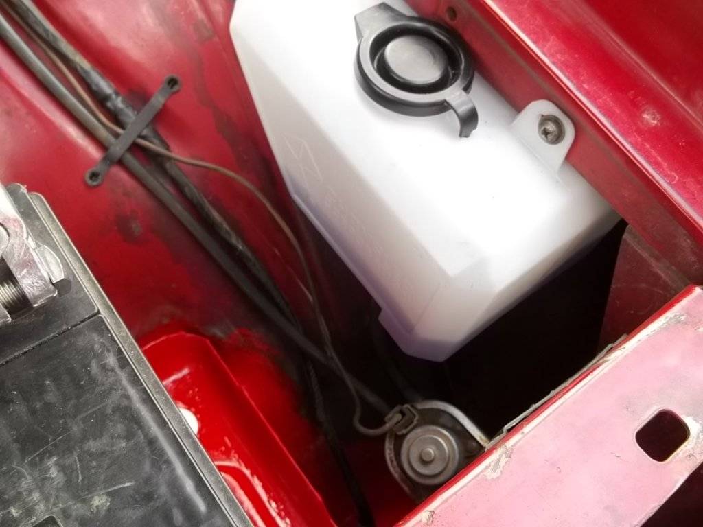

I ended up using a universal Trico pump and hiding it under the bottle.

I'll replace mine with the Mustang pump, same as the Mopar repop but 1/3 the price. The original pump sprays great but also leaks while doing so.

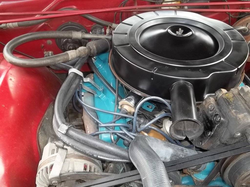

This is a little detail project I started yesterday and finished this morning. It improves the engine area immensely! The next project will be painting the steering pump.

Looking great:thumbsup:

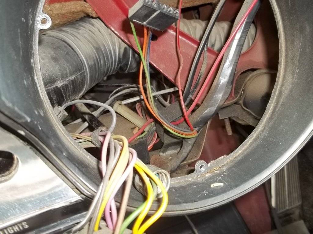

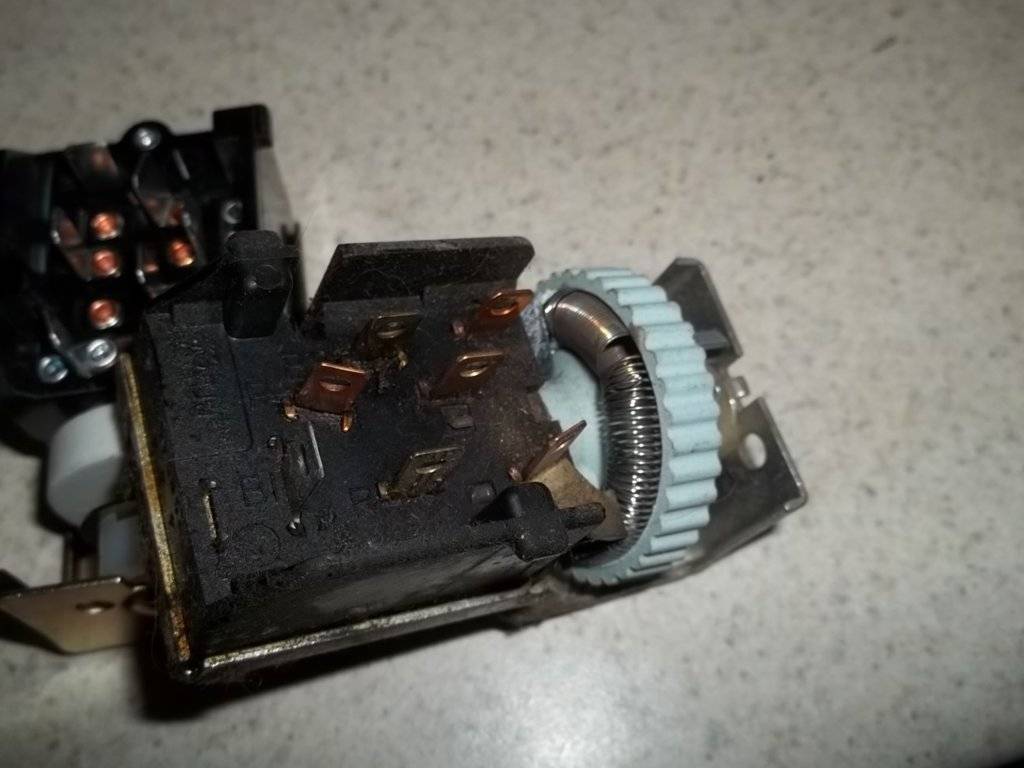

I took out the gauge clusters and replaced the headlight switch. Now the interior lights work and the courtesy lights function without opening a door.
The cool little tool I bought doesn't work for the switch nut but I found something that did. However it will remove the antenna and convertible top switch.
The clusters each got new bulbs and the ammeter terminals were cleaned.

Photo of the original switch shows the problem.

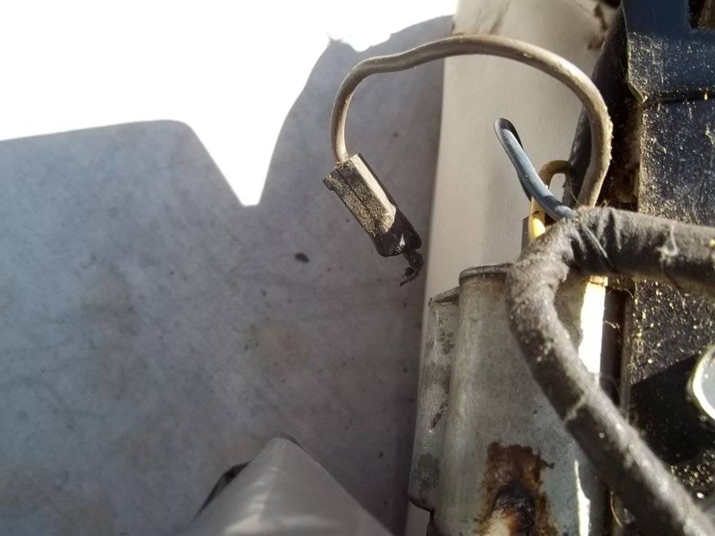

I just spotted a mystery fuse....oh crap!
Here's the terminal before I cleaned it.

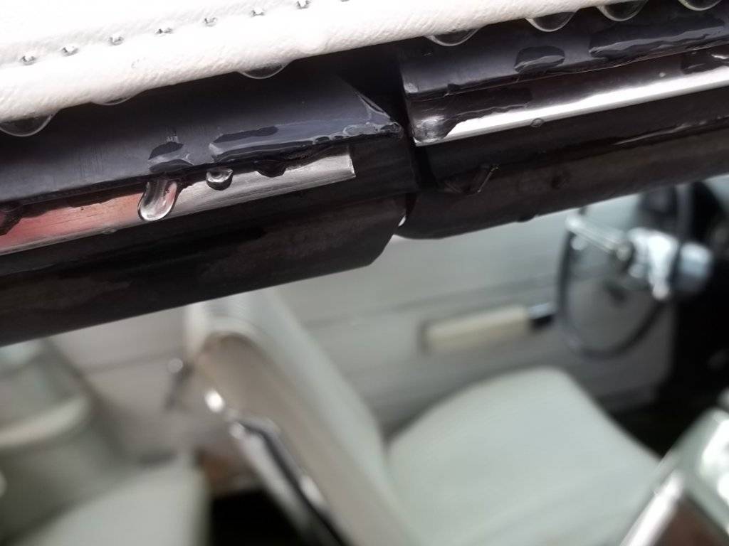

A brief but heavy Oklahoma downpour tried to turn Miss Ruby into an aquarium!
But now I know where the leaks are, and boy will fixing 'em be expensive!

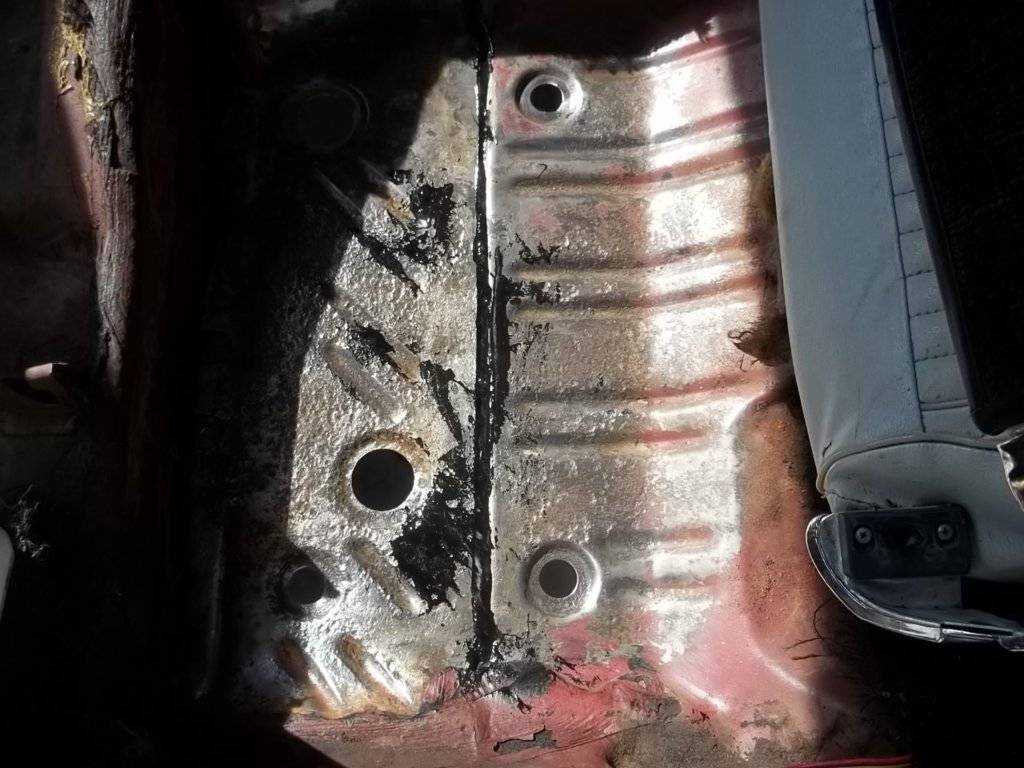

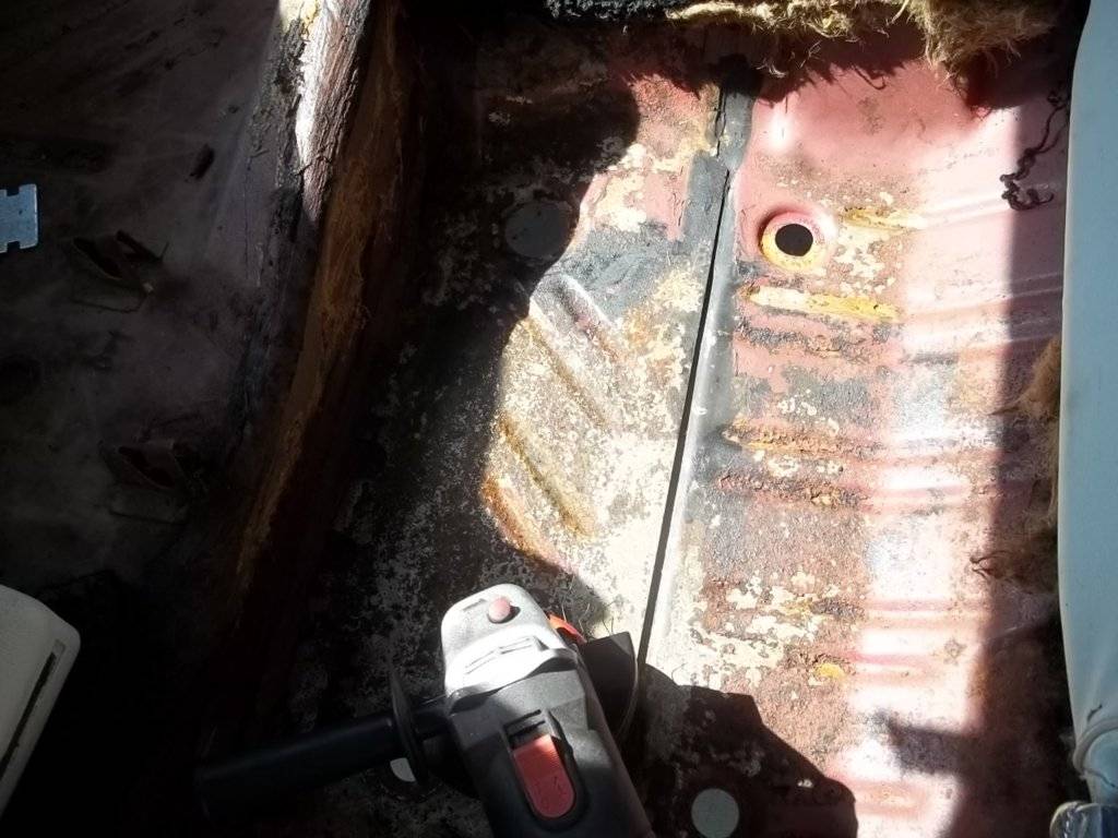

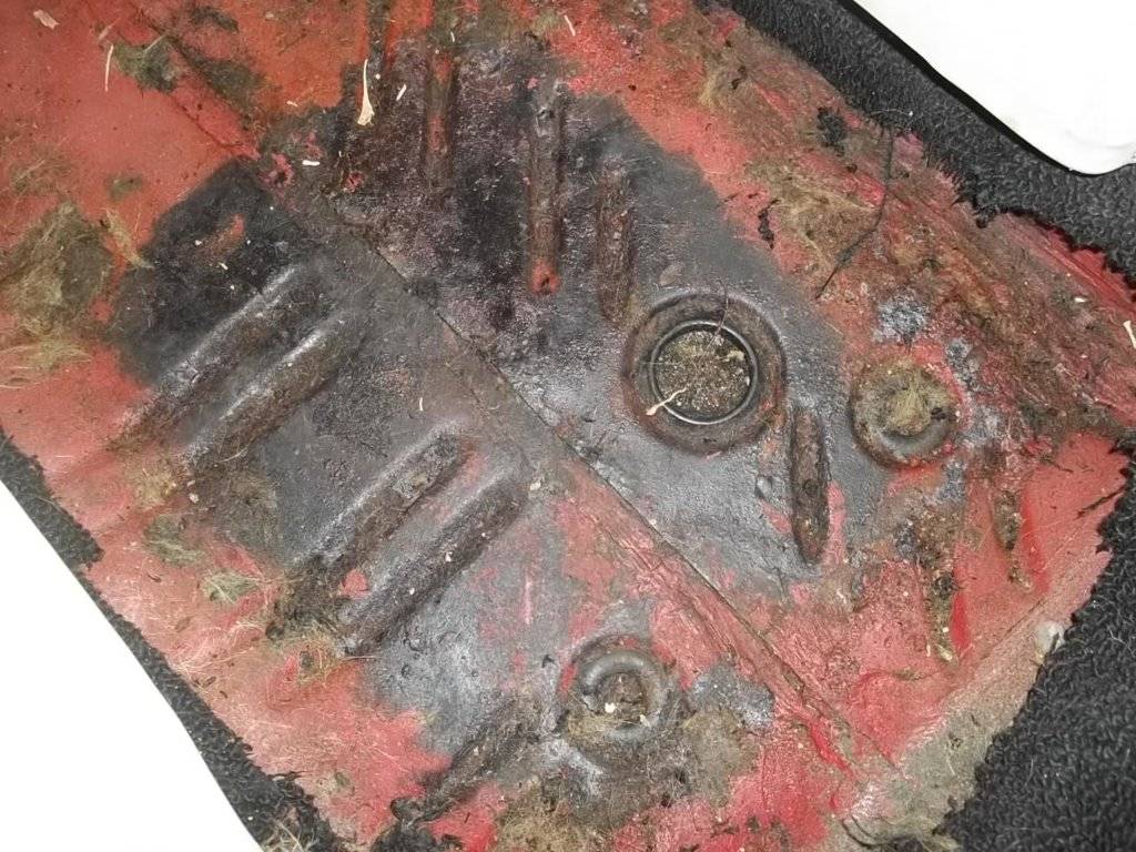

Today I started to deal with the worst rust I found on Ms. Ruby.
I'm glad I didn't wait any longer.
The pictures tell the story.
Driver's side
I used puppy pads filled with Apple Cider Vinegar laid on the floor for about a week. I changed them out once.
Here's the results before and after wire brushing.
2 coats of Rust Bullet red.

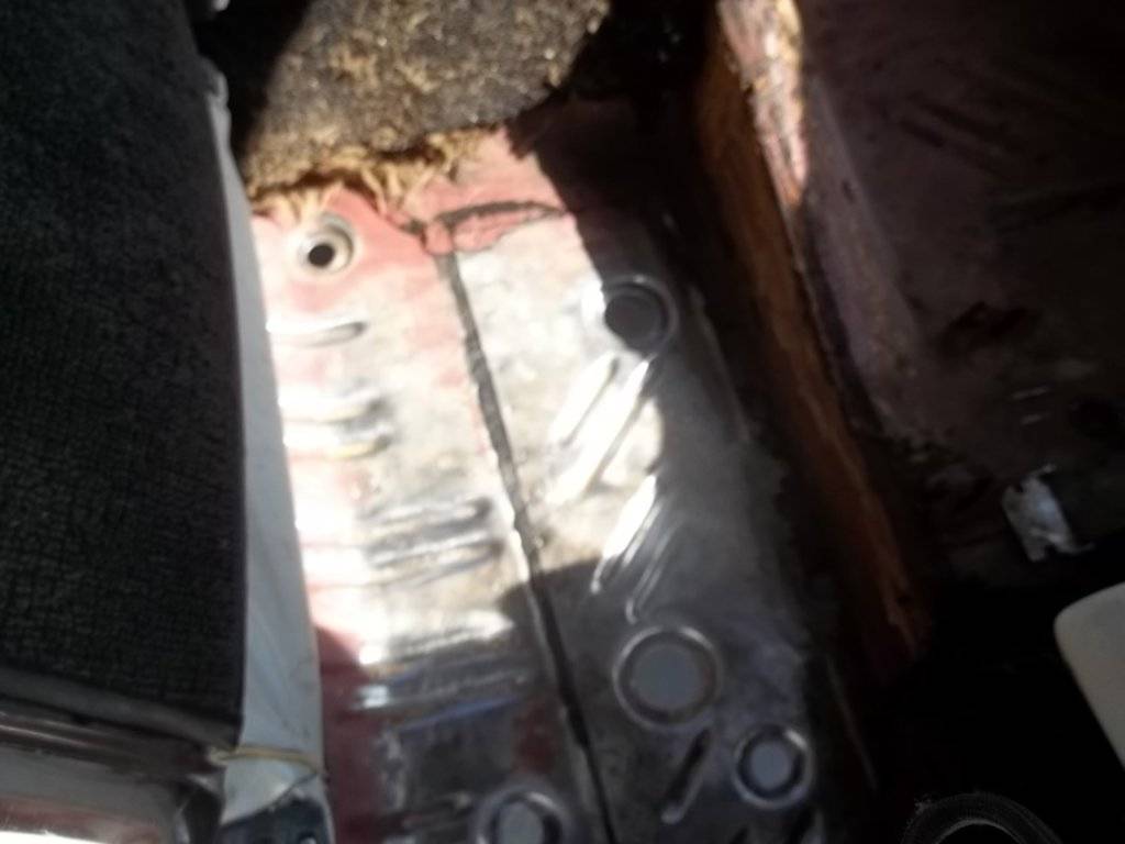

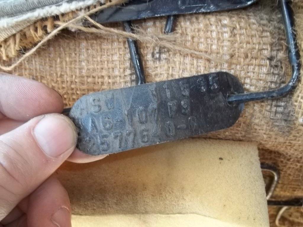

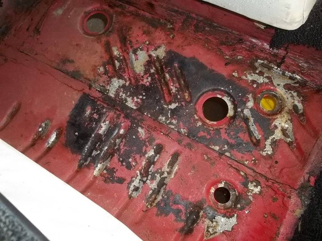

The passenger side was a lot worse. There were a few pinholes. Someone on one of my other posts about dealing with rust suggested using fiberglass mat as a patch if the holes were not too large. That's what I did, but I also filled them with some POR-15 patch, which is about the consistency of spot putty. Then I matted them over.
Before I got carried away I removed the rear seat bottom. No build sheet, but I know the bottom was made 11/5 of 1965 and Auto trim works in Ontario was the vendor!

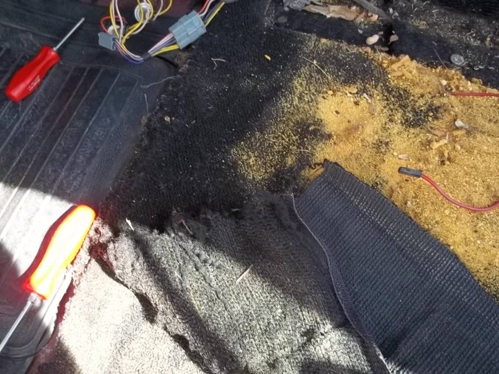

Anyways, I decided to kick *** and remove the front seats and the rest of the carpet.
I started on it right before lunch because I spent the morning putting an aftermarket throttle body on my Ram.
I removed the drivers seat and figured out why the seat wont go up or down...:( :(
That won't be cheap! :'(
I got the seats and carpet out, Fixed an insulation issue, and ground down the rust on the drivers side front. The old carpet was tossed.
