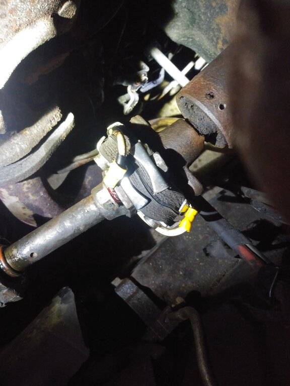

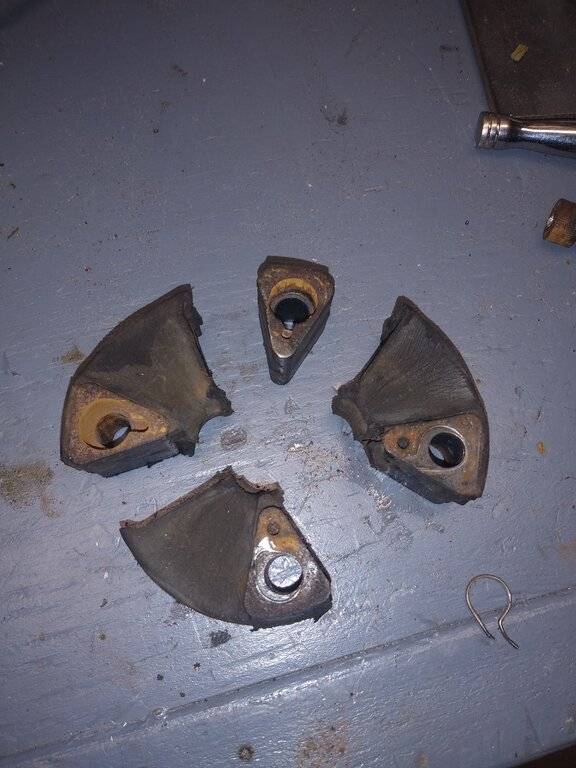

Wow. Just wow.
Just a reminder, kids. If you ever buy a 55 year old car, expect to find this kind of stuff keeping you from certain death.
Sincerely,
A very lucky guy.
My 1966 300 was almost that bad. Yes you are lucky. Going to church this Sunday? Let us know what you use to repair it with, and most of all, PICTURES.
All fixed. I used 2 of the Dorman 31002 rag joints (I think they're for a Lincoln of some type). The holes don't line up perfect, but they're large enough to work it into place. I used 2 of the original Allen head bolts to thread into the column, they weren't long enough to put the cotter pins back in, so red Loctite is the substitute.
Also made a ground wire for the horn, which is what got me into this whole mess to begin with. Best of all besides a working horn again, no slop in the wheel any more. Feels real nice. Parts cost me about $51 here in Canada, but I'm sure they can be had for much cheaper if you look hard enough.
