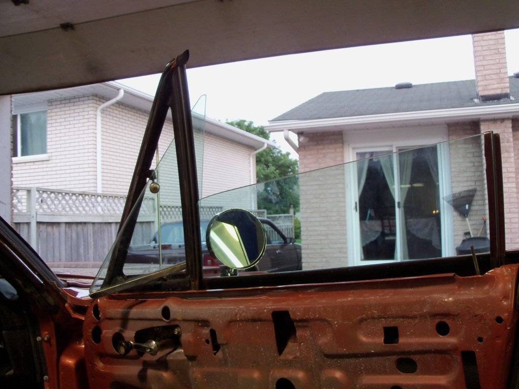

I'd really have to dig to find the remaining set I have stashed, but if you really need the info let me know. Keep in mind the replacements, whether Mopar OEM or aftermarket, are one size-fits-all-cut-to-length, so Nigel knows what/where they are. Keep in mind also he is literally swamped with business (a good thing!), so he may not be able to get back to you right away. I got the OEM Mopar ones from Nigel and they worked perfectly, and were not too tight as described above by Leaburn.
