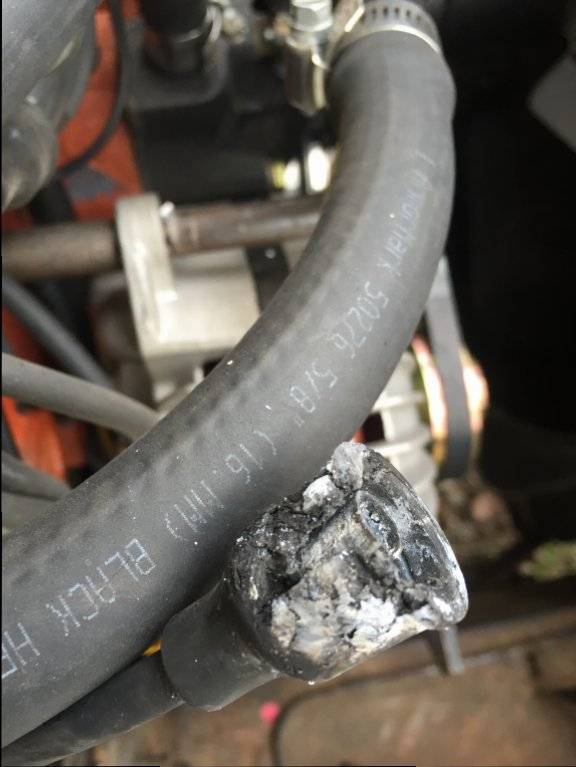

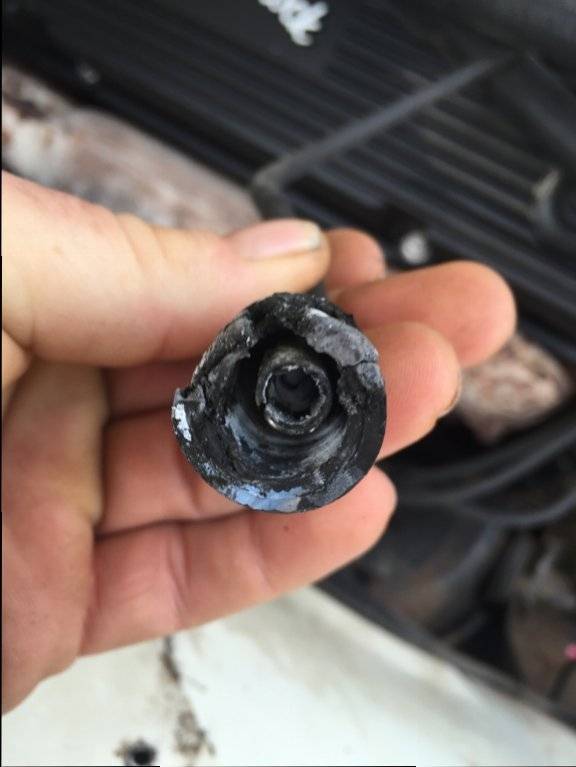

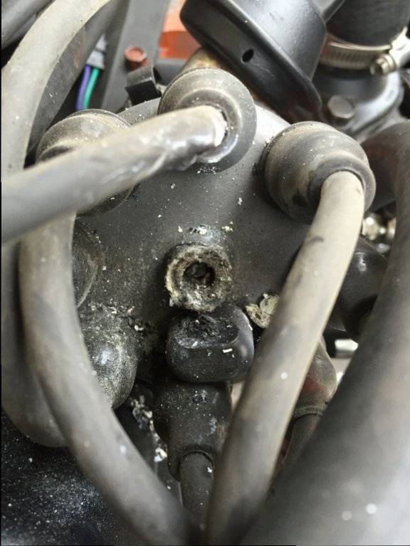

Here's a couple pics of the coil wire/ distributor damage. Cap and wires are new. It has been suggested to me that maybe the blaster 2 coil and the msd6al might be to much for 7mm wires. Still in the air on that one tho.View attachment 78582View attachment 78583View attachment 78584
Looks to me like you have to hot a spark there. I know you have spent a ton of money on this, but I would use the factory electronic set up, good for 7,000 rpm and you can use the factory wires.
It's possible. But too hot for what? The cap,the wires or both? I'll probly end putting an msd distributor and wires on before I go back to a stock set up. Not that I'm above the factory ingnition but as you stated I'm already pretty deep with the 6al set up between the box,coil and the wiring that I've done.

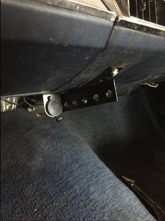

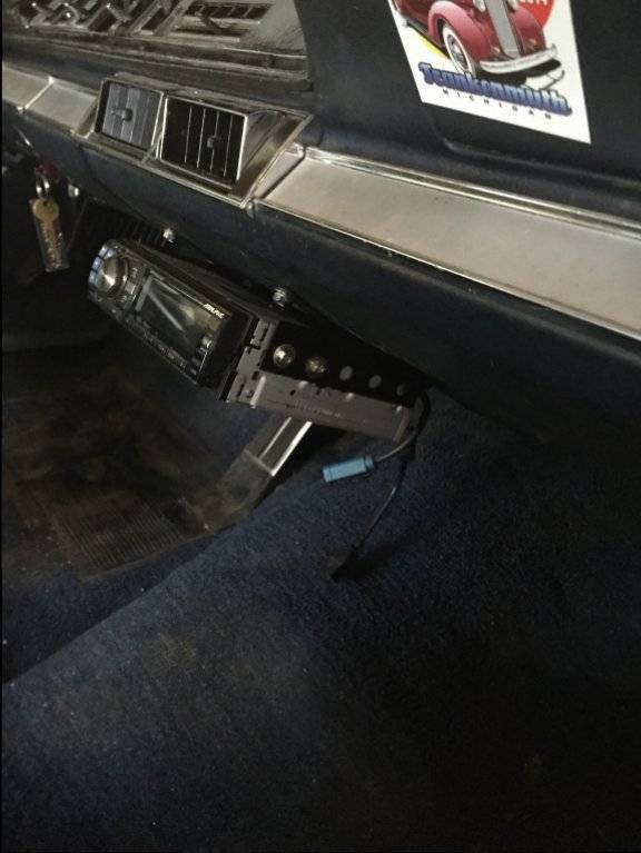

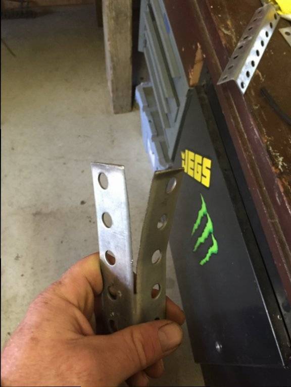

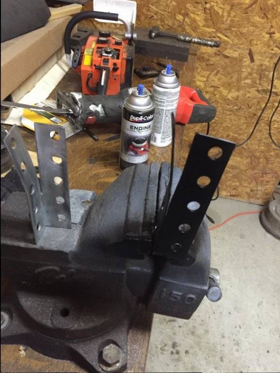

Today's project: I've been battling with radio placement as of late! Eventually the radio will be going in the dash in place of the 2 center vents. For now I've fashioned a rudimentary mounting system . It's not as pretty as I like but will do until I pull the dash.....at which time I will weld the holes I just made,rebuild the harness and make my spot for the radio. Here's a few pics of my mess!
Started out with a couple pieces of angle
Split emdown the middle to follow the contour of the dash
Painted both sides
Mounted them to the bottom of the dash
And finally mounted the radio
Almost perfect ;)
I'll probly come up with something to cover the ugly on the sides.....for now this'll do! Now I can listen to some zz some cash among other things.
