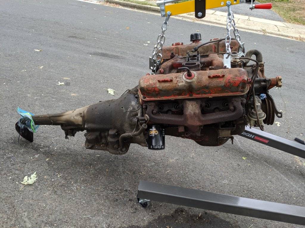

I was able to remove the engine and transmission yesterday! Taking it to the engine builder tomorrow.

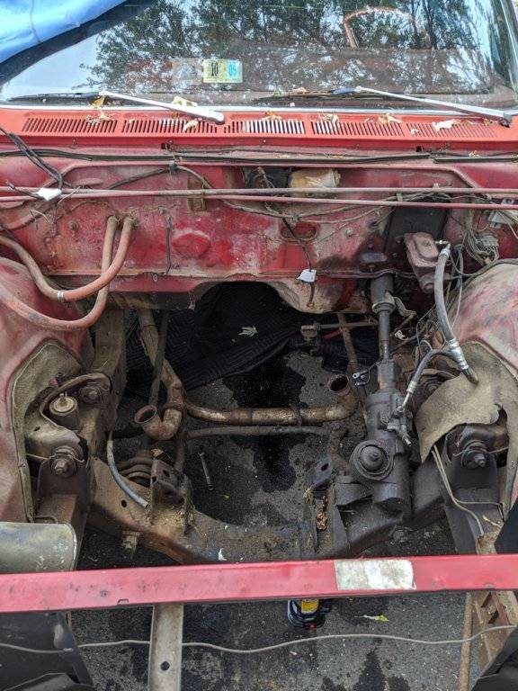

Time to start cleaning up the engine bay, removing the front suspension to replace the bushings and replace the master cylinder with a power booster.

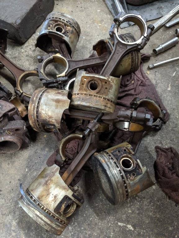

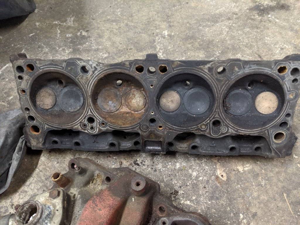

Well, received some bad news today...my 318 is toast. Talking to the builder he said he thinks water might have got in it somehow, so he would want to magnaflux the block. Then the heads would need a valve job, new pistons and rods. It all started adding up and he just thinks I'd be better off buying a new engine than sinking a ton of money into my 318 just to get it back to normal.
