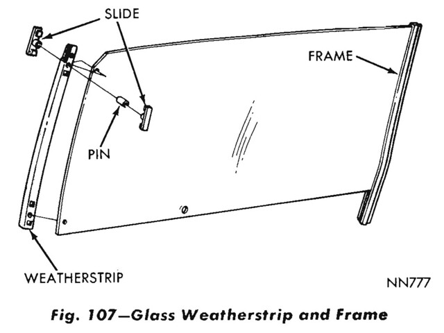

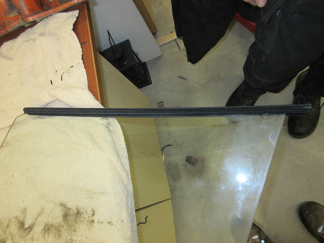

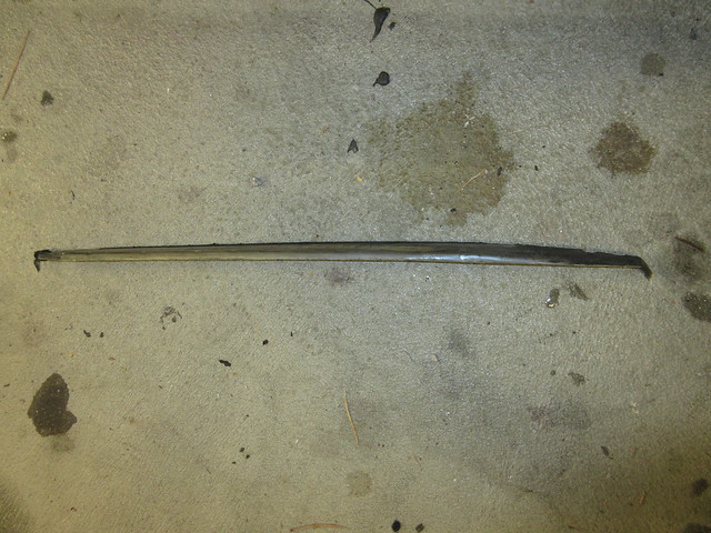

Last spring I decided to get back to everyone's favorite topic and fine tune the windows and ran into new things I had not taken care of. The window weatherstrips were pretty much shot.
Luckily there were new weatherstrips in eBay. They came even with new slides and pins.
Installation was easy and windows move now smoothly

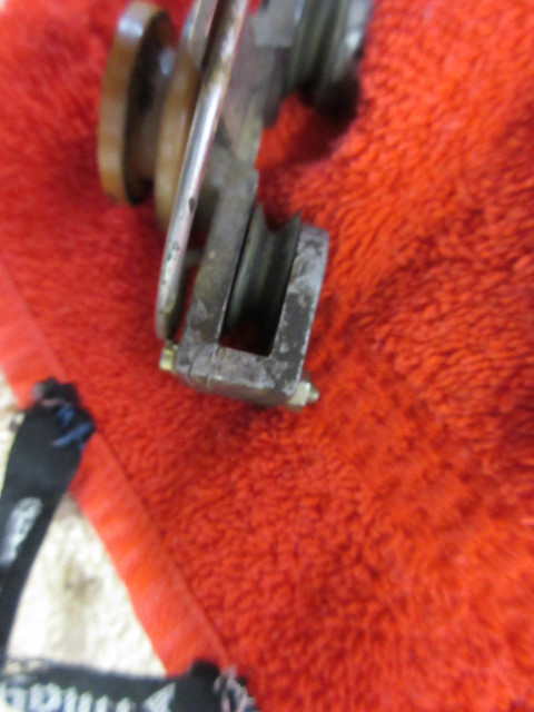

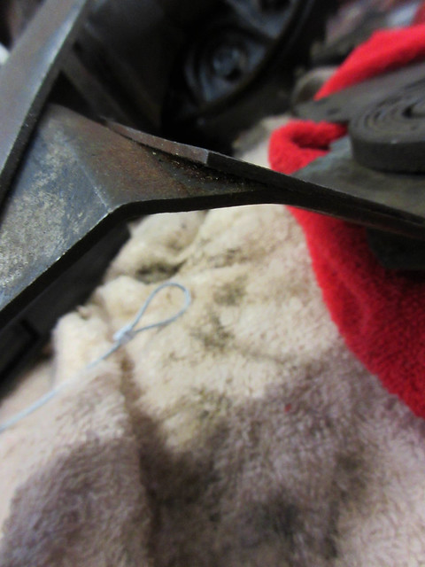

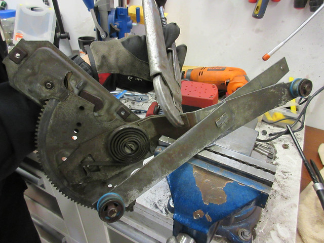

A while backwards in this blog I posted about the broken guide part in the quarter window. Well, the glue did not hold and there obviously was something wrong with the regulator. I had to take both sides' regulators out and compare them and tadaa... The left side regulator had bent so that it could not have worked. Either it has happened a long time ago or then the first painter who I ditched had bent the part when dissambling the car.
Now a new fix with tiny tiny bolt
This should be pretty straigth connection, it required really heavy bending to get it back. Someone had really abused it earlier.
