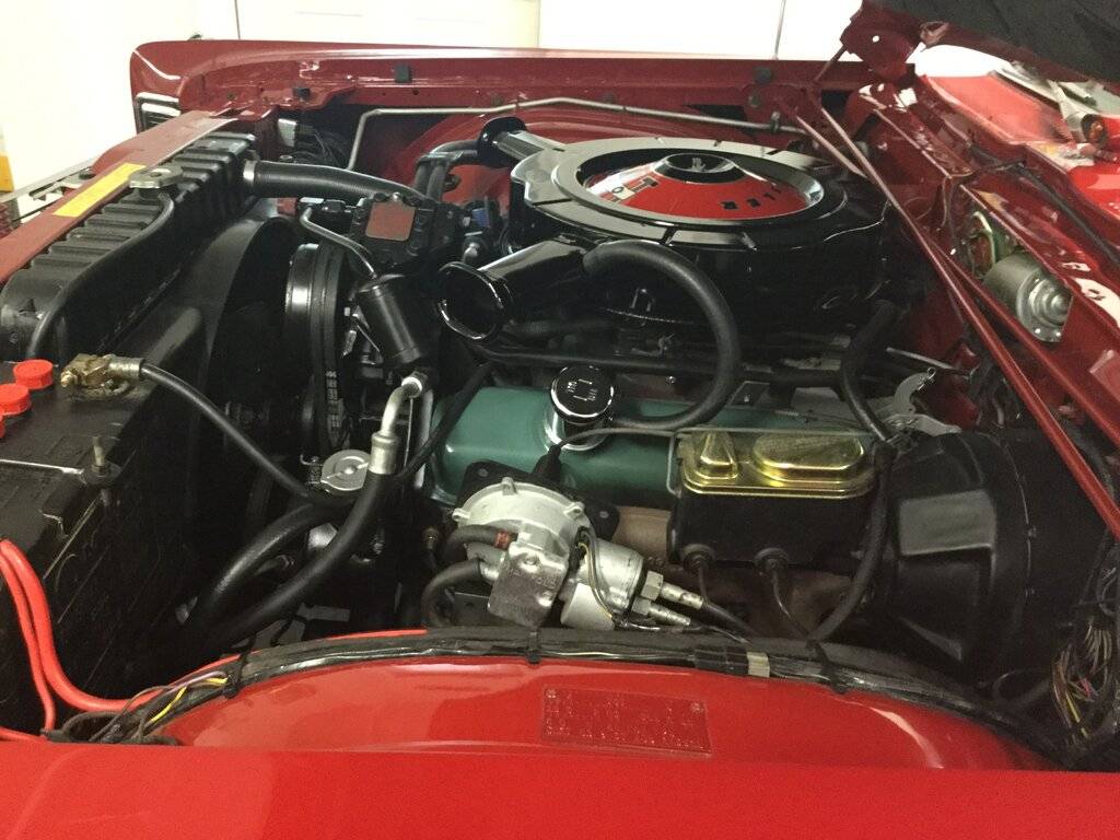

2. Run you Data Tag on Fender thru a Fender Tag Decoder. You can try MyMopar.com , Yearone www.drivinithome.com , or other site.

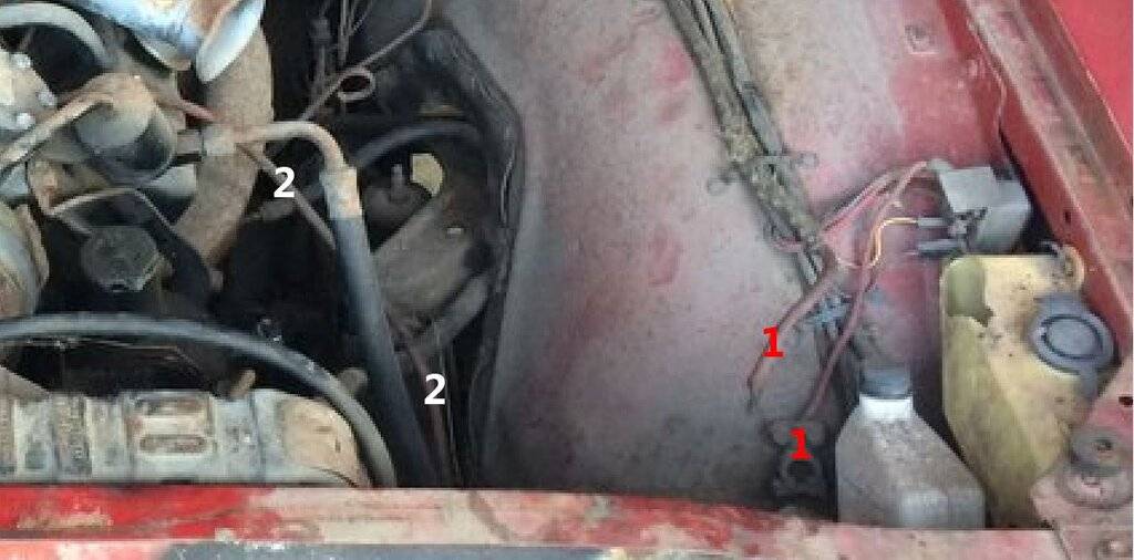

3.Red Cable is almost always Positive/+ . Picture shows it running to Starter Solenoid Relay on Fender. The ground wire is Black....Negative/- and normally runs to the engine block. My car is grounded on my AC compressor.

1 to 1 should be attached this is Battery positive.
#2 is most likely your ground and should go to a intake manifold bolt. If the cable is red in color it should be change to the correct black color cable designating the Negative so that no mix up of proper connection to the battery or when jump starting the car.
You were spot on with the cables, the ground is a red cable. I didn't see it till you pointed it out.
Once they were correctly hooked up and all the terminals were cleaned the starter came to life.

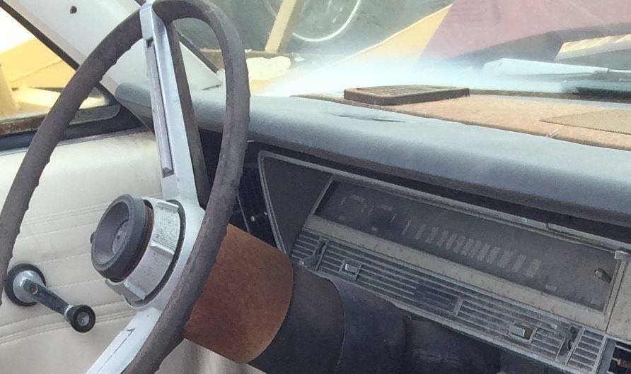

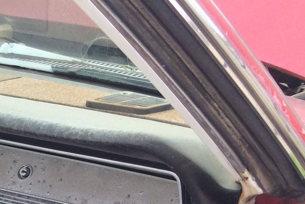

I'd like to see how they added the two additional speakers to the dash. Thanks.
Here ya go grumpy cat...
:lol:
Geez Louise, nice what looks to be a original condition car, but you got your work cut out for ya!
I think figuring out what that little knob on the dash is the least of your problems.
heh, simple 2 little screws, pull it out and see what/how many wires are attached.
BTW I'm seeing quite a few vert's like this in the Plymouth department, same age range and shape on Craigslist listed in the $1,500 to $2,500 range depending on the amount of body rot and all have the trashed out interiors just like yours.
Seriously.
I can see it now.
Part way into the 68's final year with all the engineers now working on Fusies, the douche nozzles from Marketting walk down the hall and say, HEY! We're adding two more speakers to the dash.
And we need it by Friday.
:BangHead:
Betchcha they ran out to Radio Shack and bought every type of speaker grill they could find.
Seriously.
I can see it now.
:BangHead:
Same speaker grill used on the B bodies. Not as integrated as later models as the dash was not designed for stereo speakers. Figuring the 67 models were probably in design back in 65 & 66.
