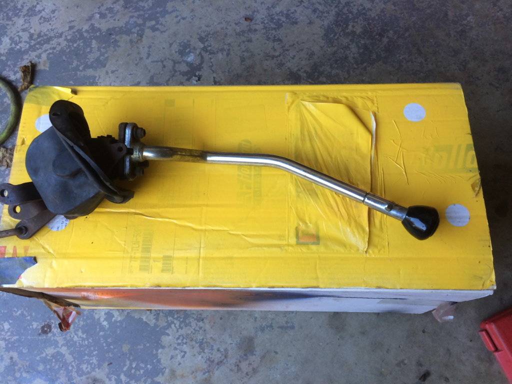

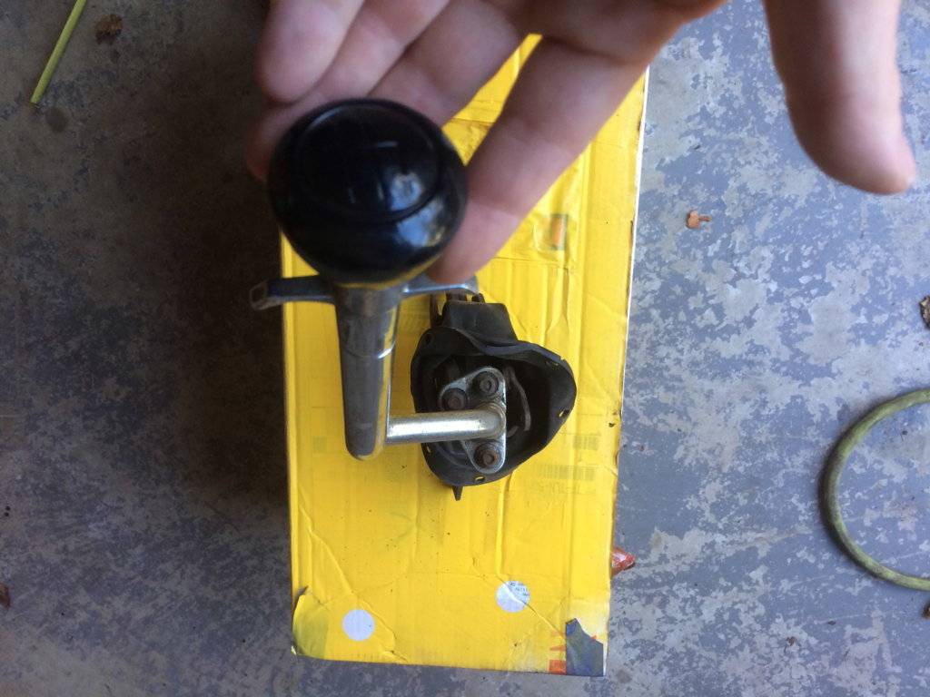

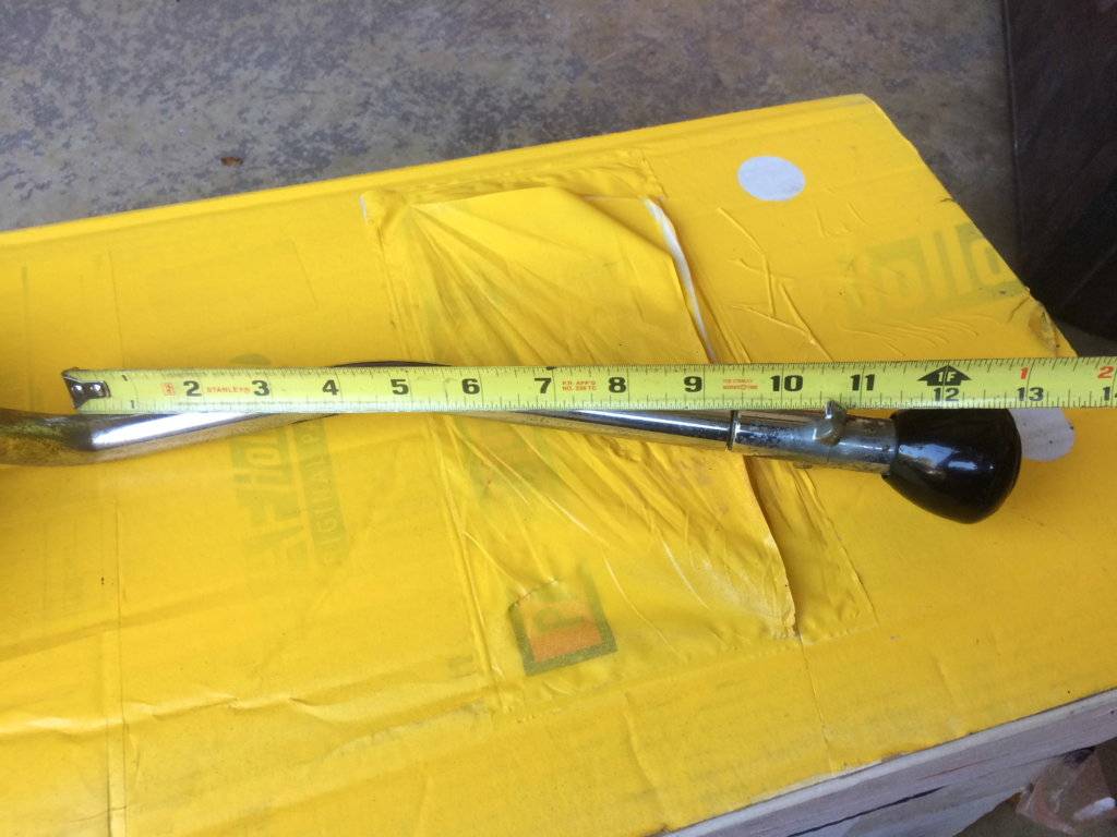

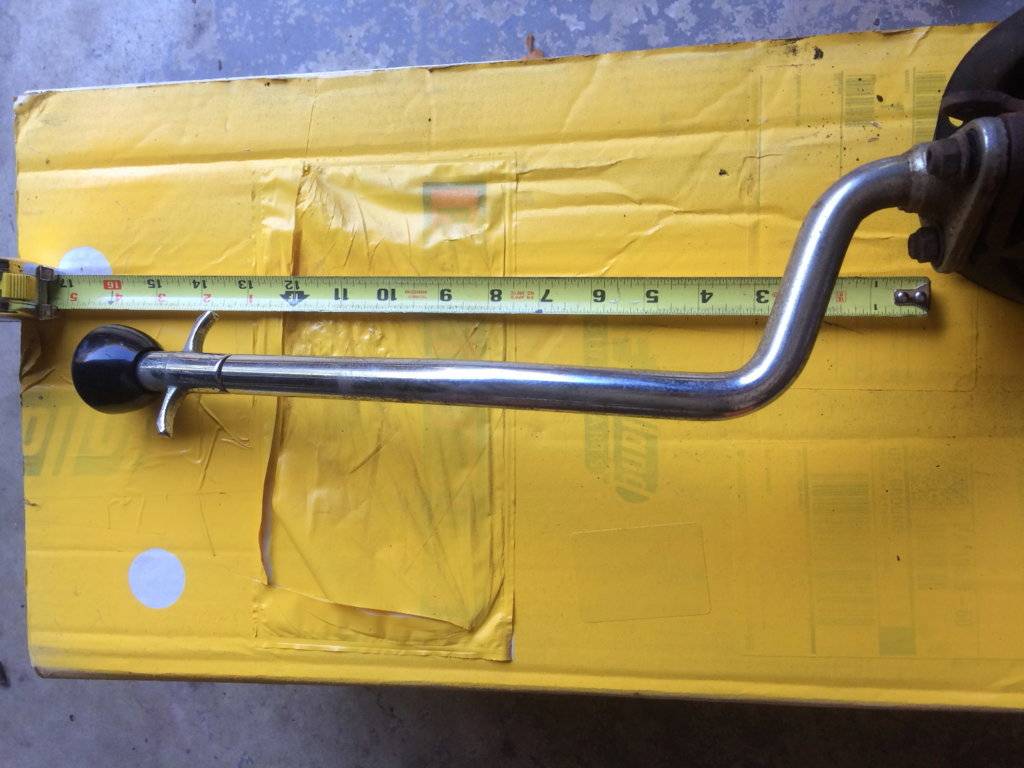

I believe the C-Body shifter is a bit longer than the B, maybe 2 inches or less. I will see if I can get you a pic of one for a C this evening. Stay tuned.
This shifter came out of a 1966 Sport Fury with a factory installed 4 speed and console.

That is almost an exact copy of what I was looking at but just wanted to be sure things didn't change between 66,67 and 68. I had also suspected it might be longer in the 68 C Body as I found a few pics that showed a longer handle that were listed as a CONSOLE shifter. Straight floor non-console were clearly a different animal. Dang!! I thought the B and C Body consoles were the same with the only difference being that the 4 speed and auto were built differently with the shifter hump. Finding a C Body 4 speed console is going to be a tall order.

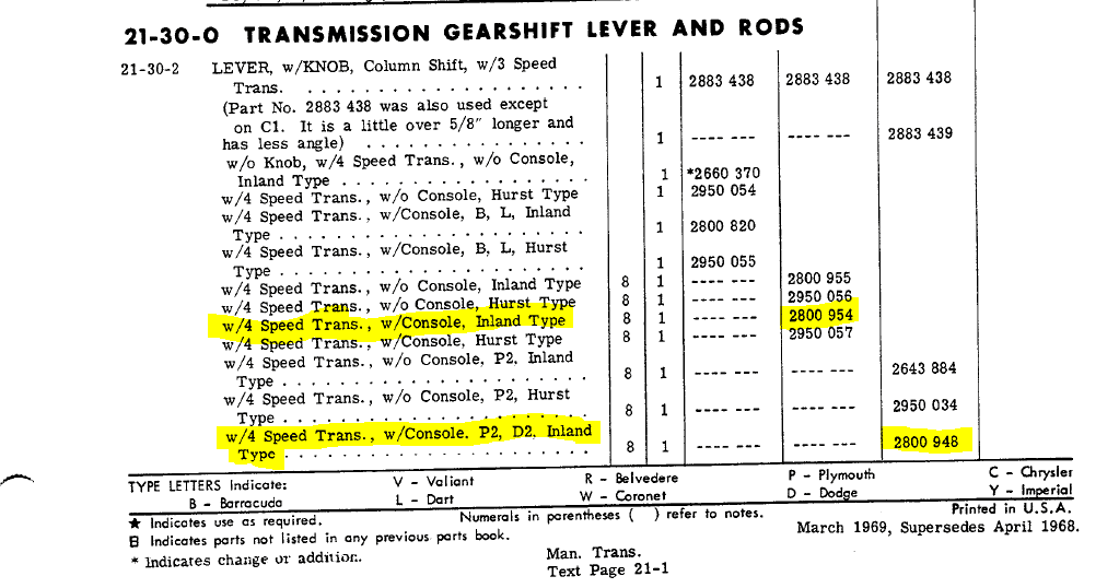

I checked my 1967 parts book, and it's listing the same part numbers for B and C consoles. The odd thing is that it's showing different part numbers for GTX and Coronet R/T consoles vs the other B-Bodys. :confused: I'll have to consult with the local B-Body expert on that one.
Something else that I noticed: The book implies that you couldn't get a console in a 4 door hardtop Dodge or Plymouth in '67, but you could in a Chrysler. It also implies that you could not get a console in a 4 speed Chrysler.
More info found: While the main part of the console looks to be the same between C and B, the carpeted hump on the left side is definitely different. I wouldn't think that it would be a huge deal to modify that part to fit the car. It's only fiberboard.
