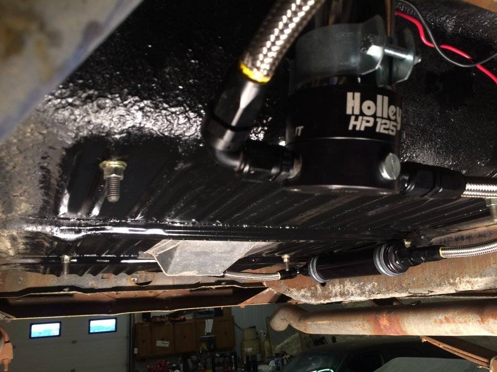

After buttoning the fuel system up yesterday, setting fuel pressure, and some tuning completed, there is now more work to be done in the engine diagnosis.
The fuel system needed an upgrade, and received a Demon 750 carb. Then the entire fuel system ahead of the carburetor was upgraded to compensate for the small factory lines and weak MP mechanical pump.
