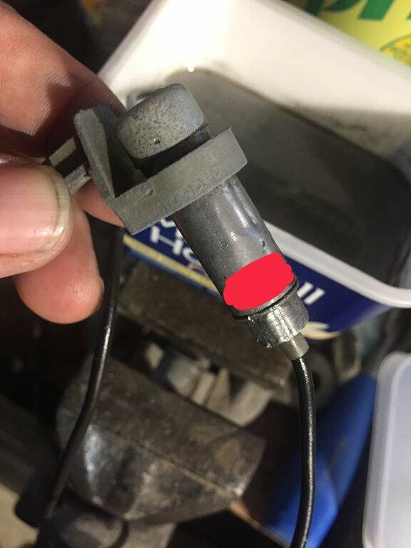

I've changed my bulbs of my 68 Newport a couple of weeks ago. Can't remember the bulb number but I can probably look it up this weekend.
I've used tongue and groove pliers to apply a little bit of force on this (red) part. Just to deform it a tiny bit. This broke cracked it loose for me. I had to turn it a quarter of a turn a couple of times in the pliers to crack it fully loose so I could slide it out
After I got the bulb out I got a bit of scotch bright in there to clean it up. And reinsert it with a bit of oil or grease so you can get them apart in the future.

Soaked mine in some penetrating oil spray for a few hours.. i was able to wiggle the connector free. Now working on spraying and freeing the bulb. I do like the idea of using the LED bulbs. Gonna order some and give em a try.
