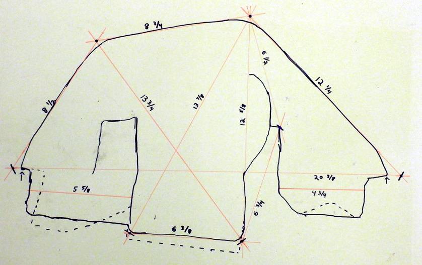

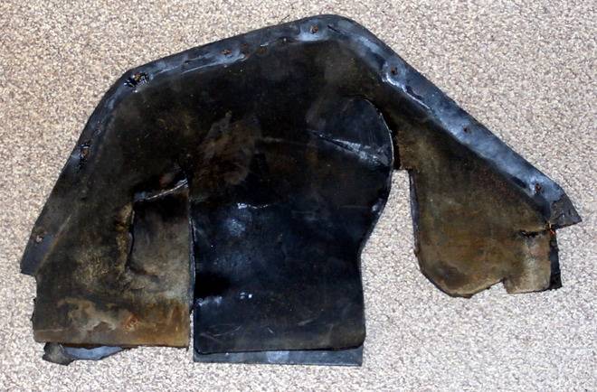

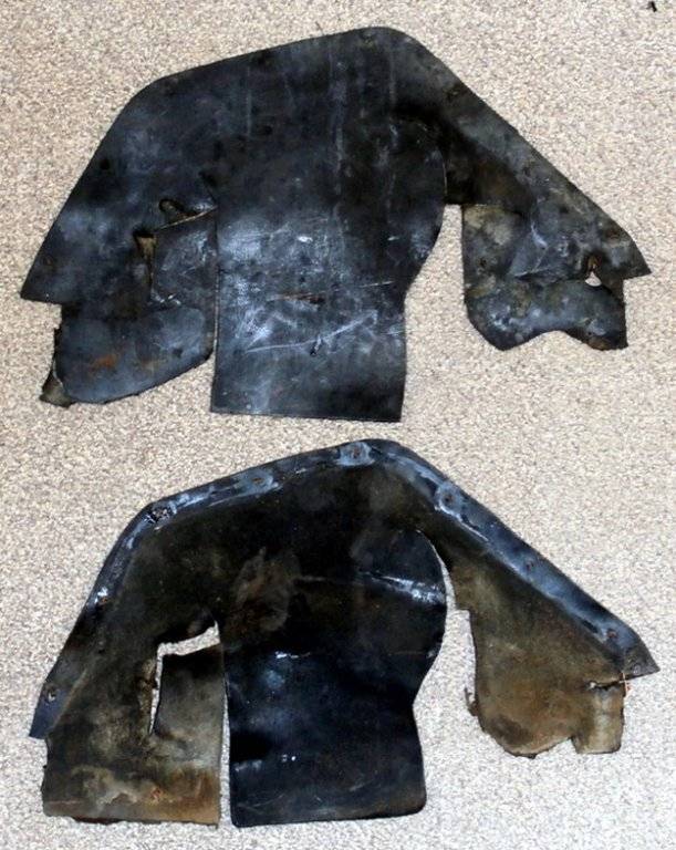

I can measure my old ones tomorrow and post the results here tomorrow evening. So don't send them back yet until you compare them to my measurements.
@RKC - here are my shields:
Laid over top each other:
Traced out, with measurements:
I'm a little fuzzy if these are the originals, or if I cut them out of some reinforced rubber sheet material my dad had. The cuts into the center match both shields, just the lower edges have some differences.
Let me know how these dimensions match up with what you got from DMT.
The ones that I plan to send back measure larger in several places that your detailed drawing.
