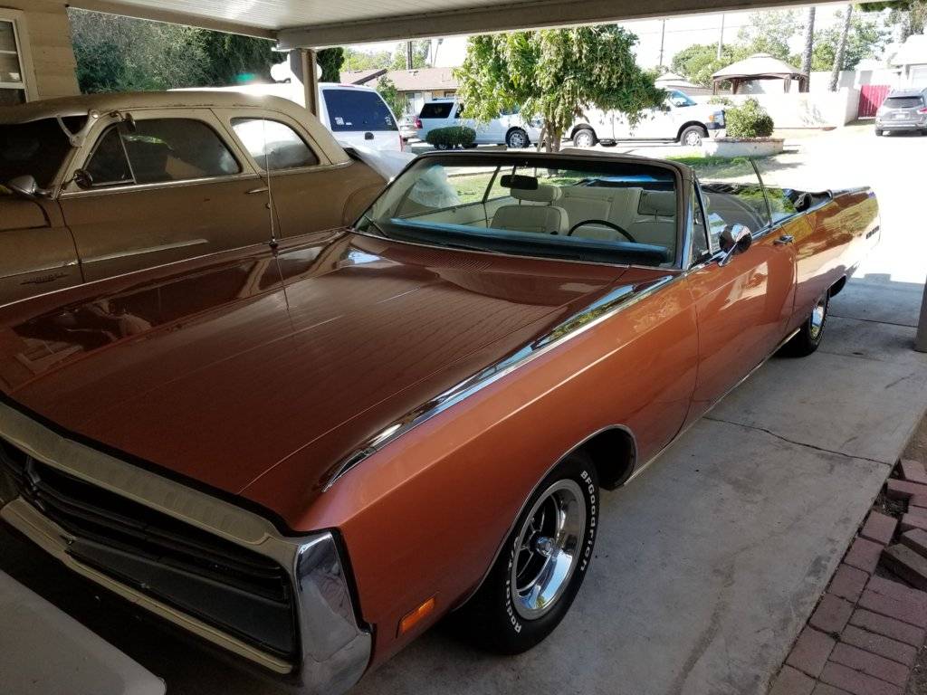

Well, guess I'll be sticking around awhile! Went back and looked at this car, figured for a numbers matching car, and at 12k, not too bad of a deal. Drove about 30 miles home, 88* outside, mix of freeways, city streets...drove like a champ! No wandering, stops straight, doesn't pull to left or right when cruising. Manually shifted car couple times....soooo smooth, don't even feel the shift points. No smoke when started, or when getting on it that I could see or smell. Miles are at 67000 approximately. Not sure how accurate, but shows that on title, and old maintance records seem to back that up.

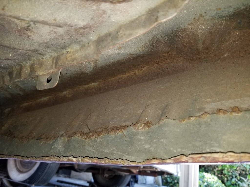

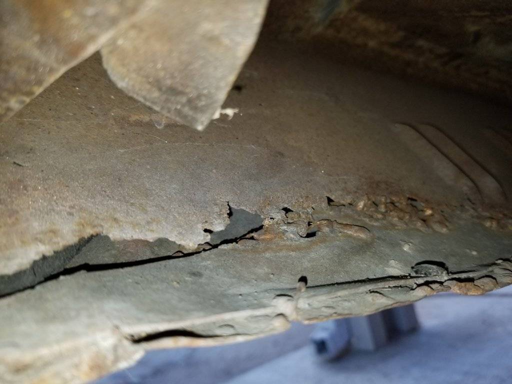

Relooked at rust areas, only rust on rear lower corners where convertible top drains from top I think. No rust showing from the paint side, but backside is not pretty, (see pics). Looks like someone welded in patch panels, but didn't cut out the old stuff very good. No rust seen in frame, floor pans, front fenders or doors that I could easily see. There is a small bubble on right rear above trim over the rear tire. Rear springs are nearly flat/straight...no arch. Got to fix that.
Pics...or it didn't happen! This is how I got the car, I didn't do any of the things like painting motor etc, this is how it came. I will attempt to fix any flaws pointed out. Thanks!!

If that car is as straight and slick as the pictures, you did OK. If the rust pics you showed is all it has, don't worry about it. Those repairs could've been done in 1982 for all we know. You're not going to drive it in the rain or snow, so it's only going to get wet when you wash it. It'll last a long time. If things do get worse, those pictures only justify some skilled patching, not full-bore panel replacement.
