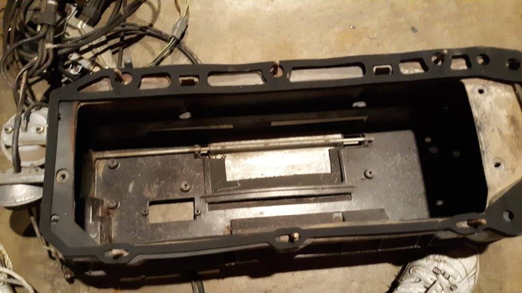

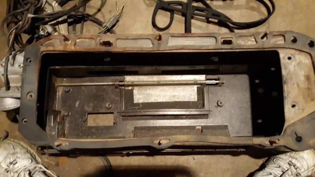

While repairing the fiberglass pivots in my heater box I noticed that the replacement gasket from the heater box to the firewall was not the same as the original. As you see in the photos there is quite a difference on the driver side portion of the gasket. Is this an missed shipped item. If so, what is the correct part # or simply a mistake on the part of Detroit Muscle Technologies. These heater boxes are easy to crack hence my requirement for correct parts. If you have had this problem please respond. Thank you.

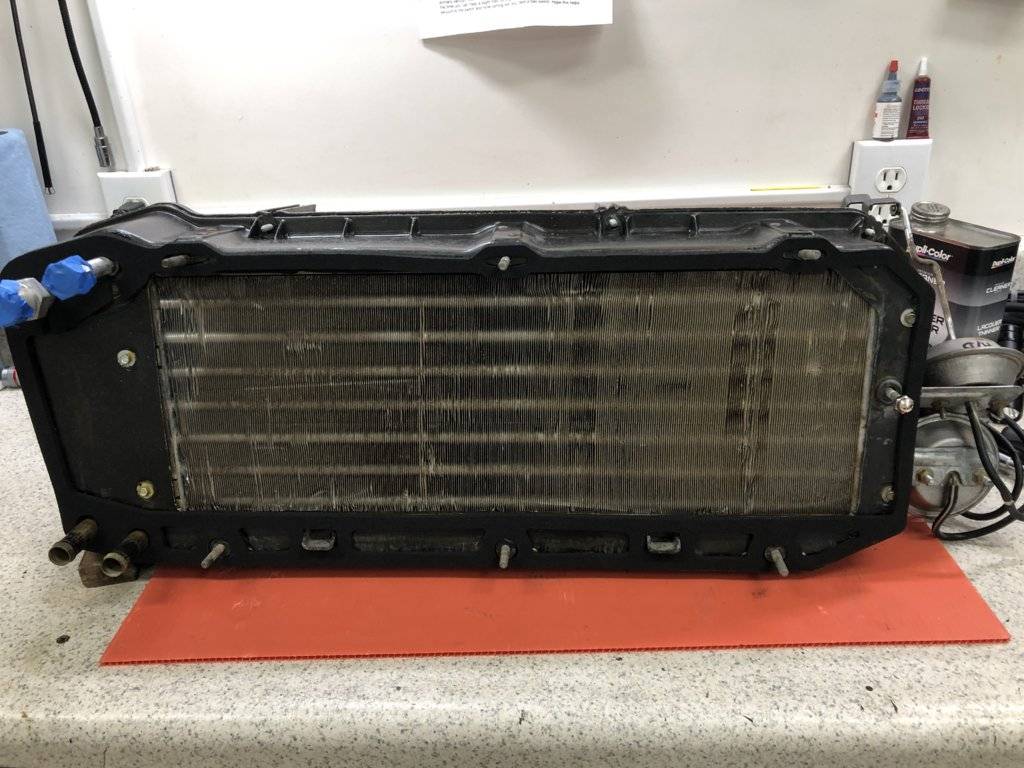

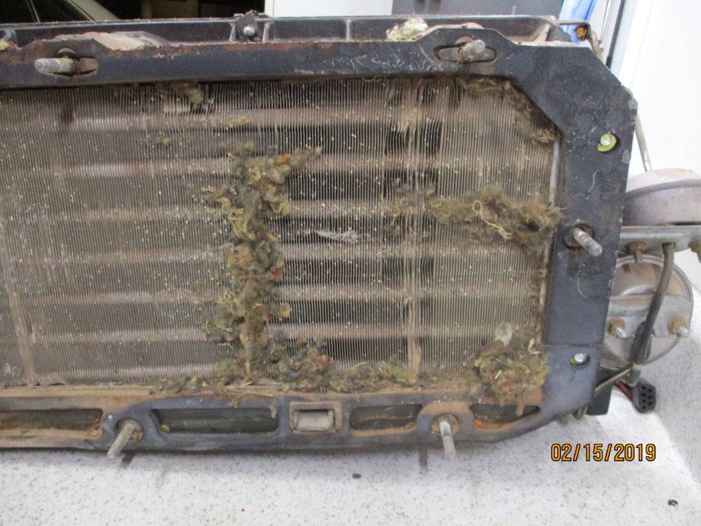

AS REMOVED FROM CAR, INCLUDING MOUSE POOP AND NESTS
REFURBISHED WITH NEW KIT FROM DMT, much wider gasket on driver and passenger sides.
