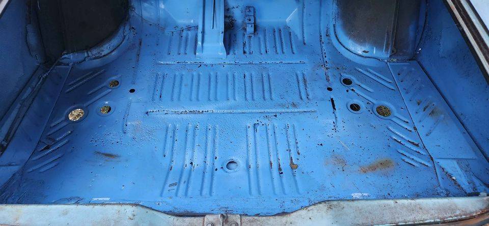

"Tires are old but are in good shape. Price is firm. Clean title in my name. Frame and floor pans are solid. Nice interior. Headlights/ turn signals all work. Nothing else does (seems like a bad ground) it worked a few days ago. Runs and drives. Just drove it 3 hours just fine. Wife hates it"

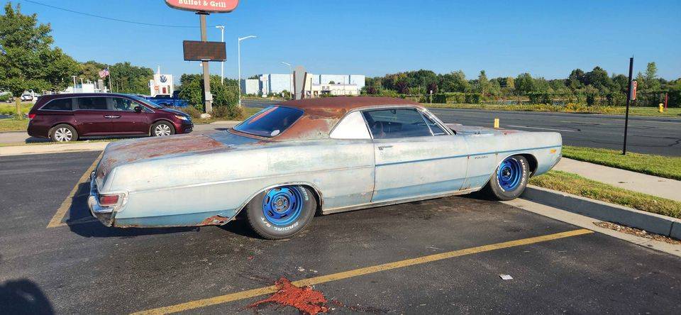

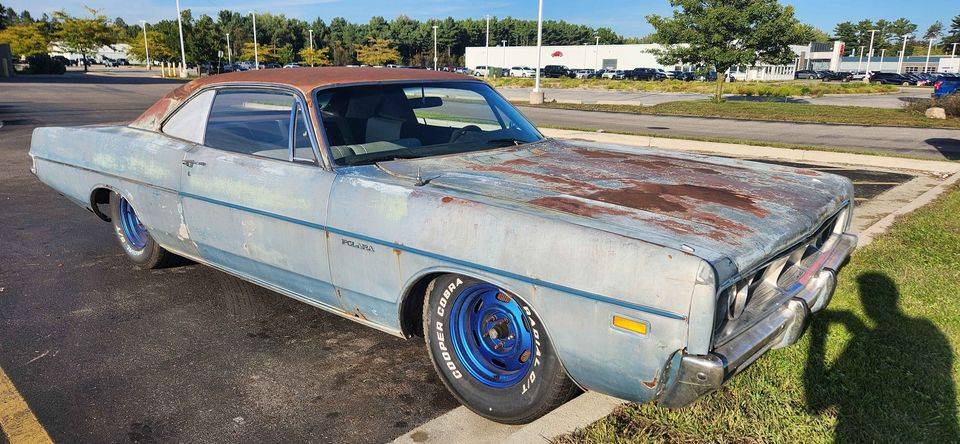

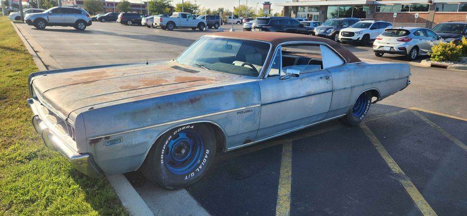

Fresh batch of pics. Wonder about the original color -- B3?

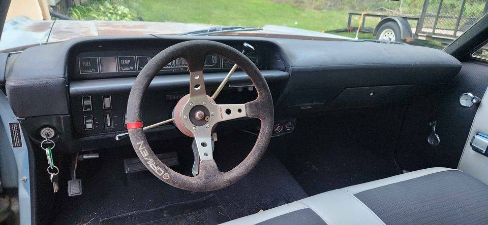

A vinyl top, ride height adjustment, different wheels, and fix up the interior...the car would be giving off badass vibes instead of the POS vibes its giving off now.
People don't know how to dress their Polaras.

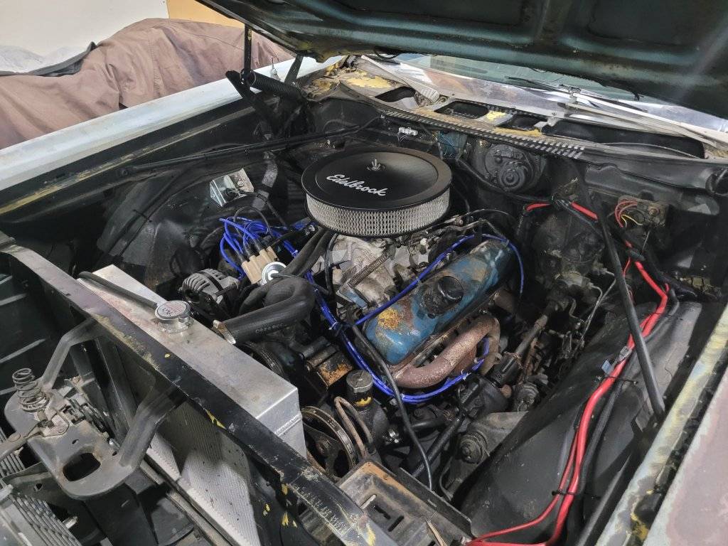

I will be raising the car back to factory height. Rear leafs are on blocks. Front end torsion is turned way down
I have a 440 .30 over with aluminum 440 source heads i will be putting in it

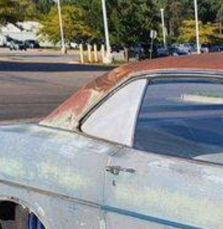

The front yellow paint appears to be spray paint.

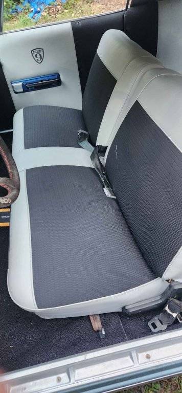

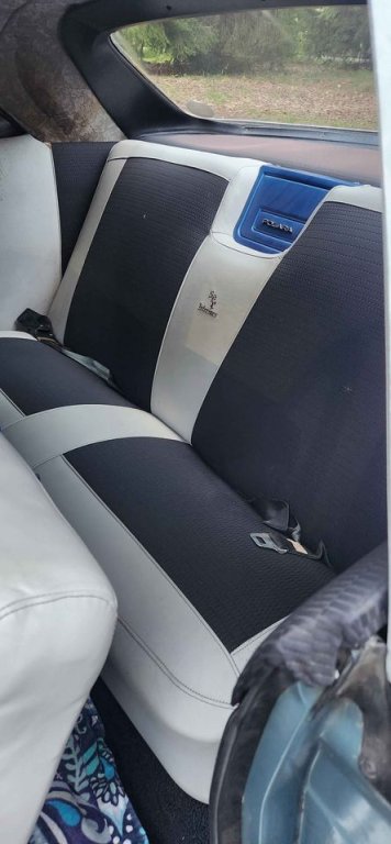

I plan i doing the interior over eventually.
Whoever redid them put new foam so i was hoping someone could direct me to slip on upholstery kits
Welcome, and good luck!
And I mean that sincerely, I think you'll have a gem after some de-pooping.
As for slip-ons, you'll need to google.
Legendary Auto Interiors does a lot of Mopar stuff, I don't know about this particular year/model/bench seat.
But even if so, the re-foam that was done might not fit well with Legendary covers.
The seats might be over or under-stuffed from original.
If too far off-target, the covers won't fit well and/or will wear prematurely (wrinkles and/or stitch-popping).
Unless you are pursuing a factory-correct restoration, you'd be better off going to a trim shop and having them make something emulating the original style based on the new foam.

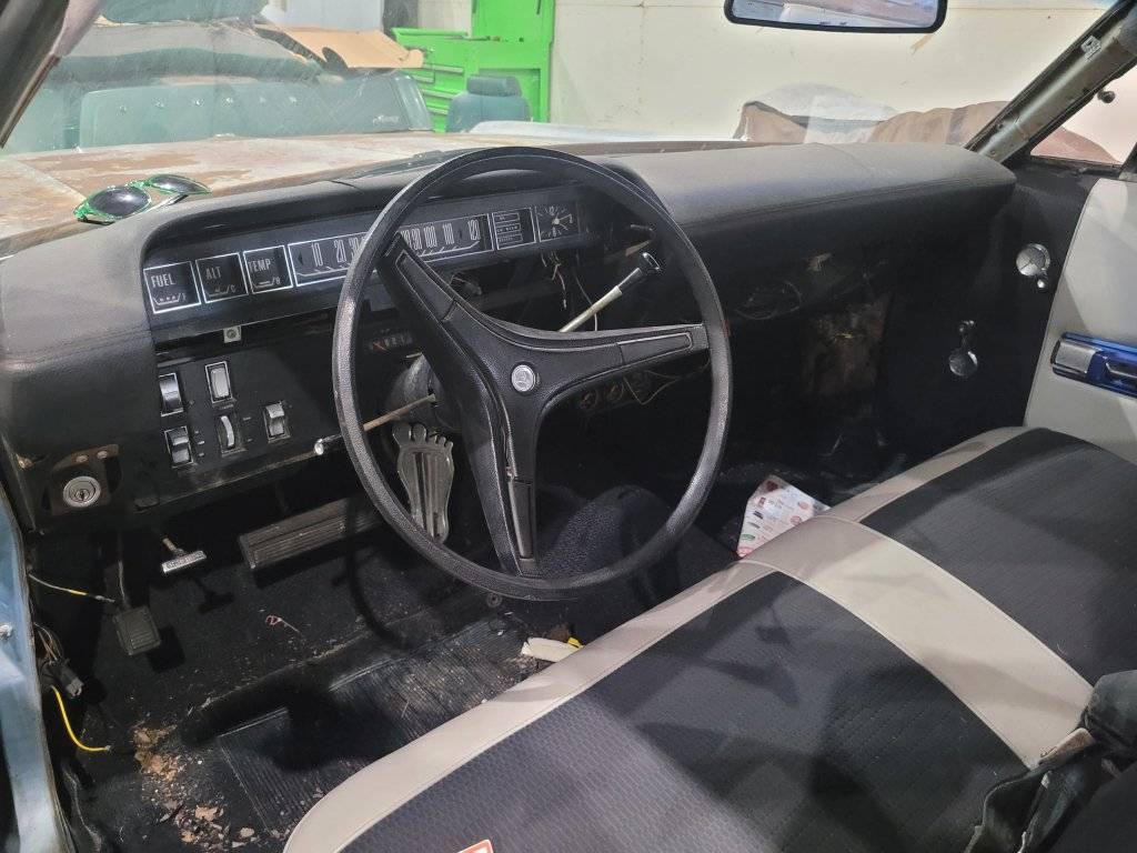

Installed wiring harness from a parts car for dash/engine bay.
Installed alternator with newer type regulator/alternator
Installed new starter
Installed mopar electronic ignition wired correctly to the key
I bought a parts car 1969 dodge monaco 4 door that i got all the missing chrome trim/dash pieces
Changed steering wheel to a 71 dodge charger i believe
