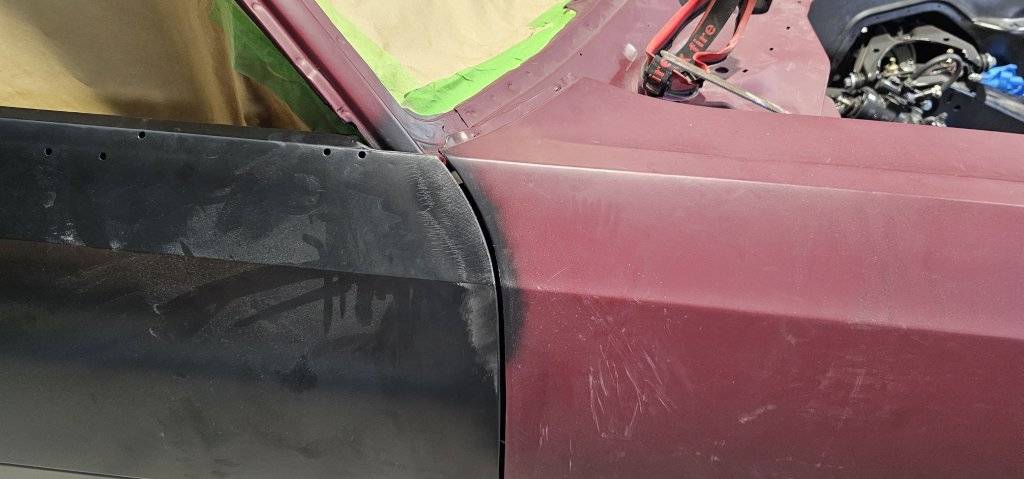

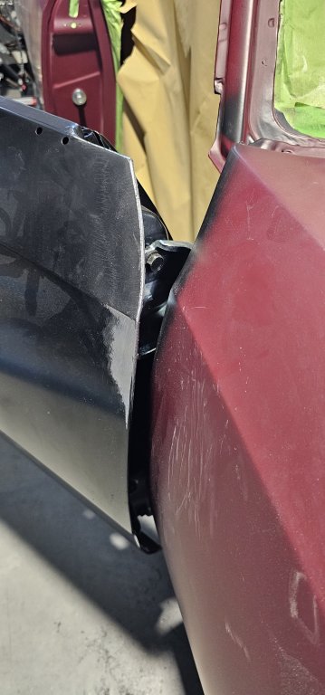

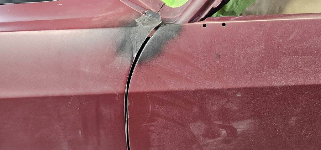

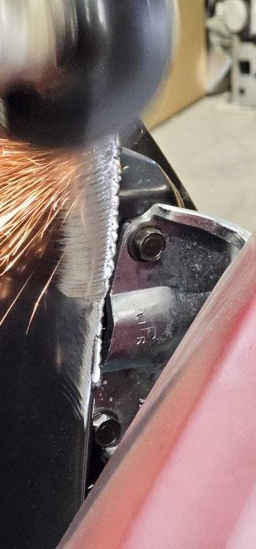

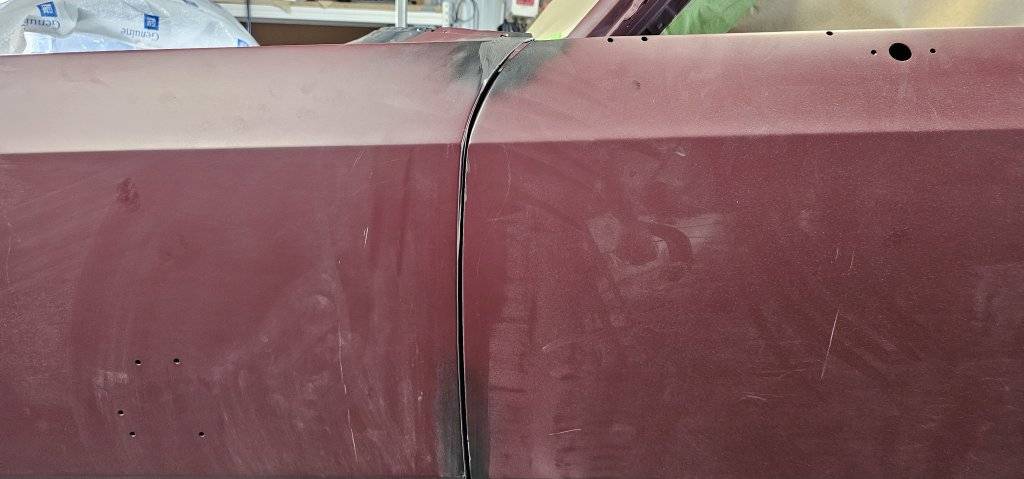

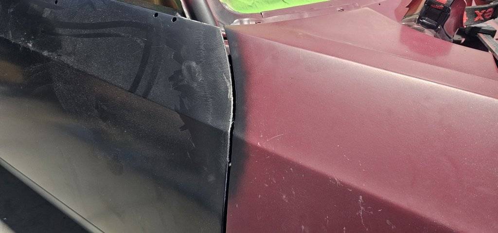

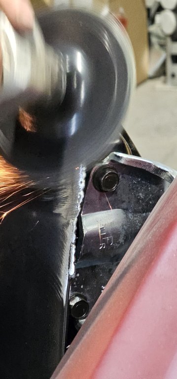

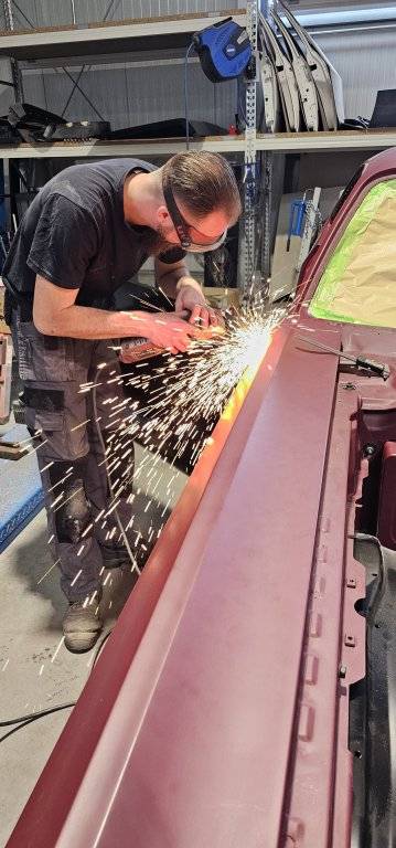

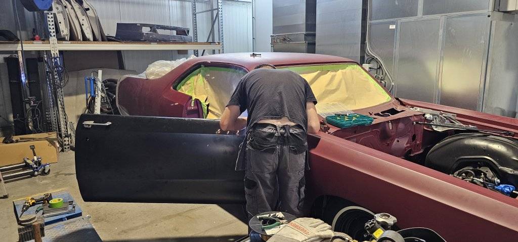

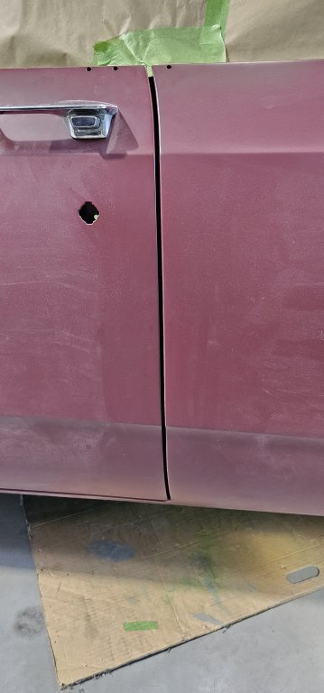

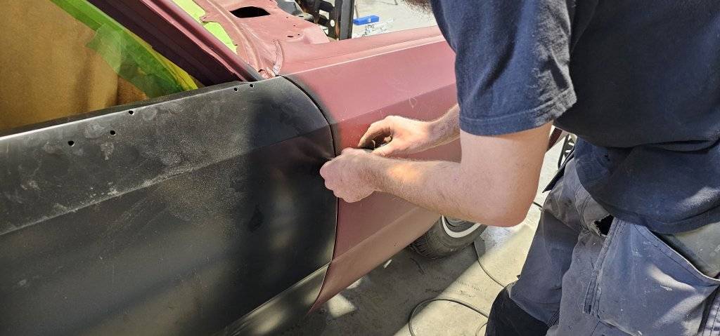

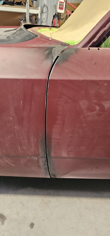

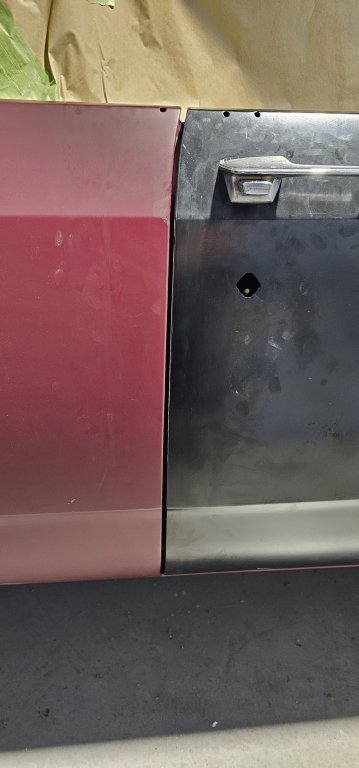

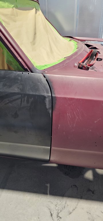

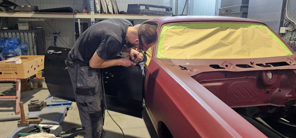

It took 10 month and almost $2000 to get the new passenger door is in its place, aligned properly and all the panel gaps as perfect as they're gonna get.
After I got the door back from e-coating, I tried to align all the doors and fenders proberly, but the gaps were all over the place. So I called my bodyman, and this saturday, he came all the way from Stuttgart (which was a 320 miles round trip for him) to work on the doors and fenders to get all the panel gaps right.
Since the new door was 3mm longer then my original door, nothing was fitting right. So he cut away metal from the front and back edges of the doors and fenders, welded the edges back up, added a bunch of material in some placed, before grinding down the edges until all the gaps were as perfect as possible.
So FINALLY the car is ready for paint...! What an odyssey...
This debacle really tested my patience to keep going!
