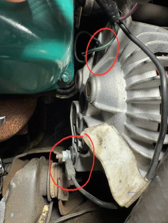

That large post circled in the bottom of the picture you posted is battery hot and the output post of the alternator. It should match the battery voltage. Trace all of that wiring out individually with an ohm meter (and the battery disconnected!).
I bet you find a poor connection somewhere under the hood.
Thanks! It seems that this black wire goes directly to the bulkhead connector. But how is it suppliee with 12v?

Hi John, at the alternator we meassure 3v. Strange. Are you sure at this black #12 wire it should be 12v?
Yes, there should be 12 volts at this point. Follow it back to the bulkhead disconnect at the firewall and it goes to #16 on that plug.

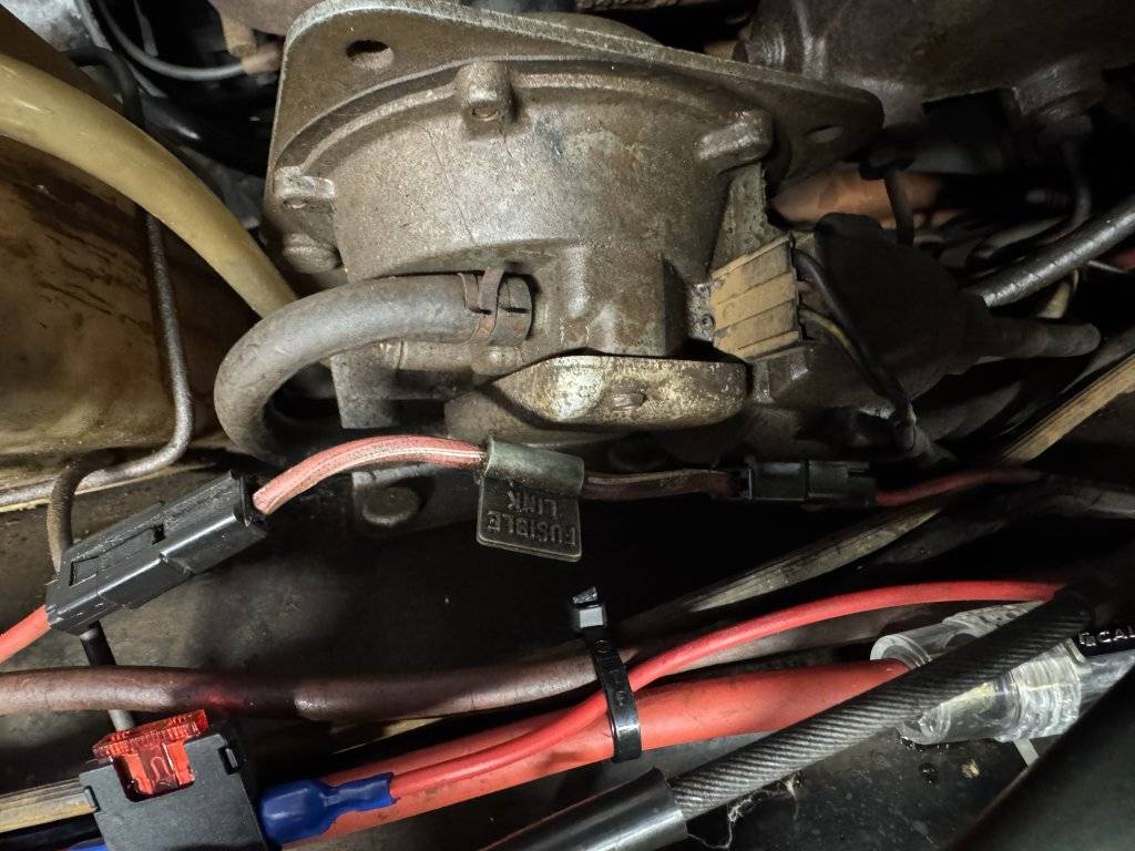

So, I would start at the battery and the fusible link. How did you check the fusible link? You can't tell if it's OK by just looking at it.
Hi john, thank you. We checked the fusible link with a Fluke. And we meassure 12v before and after the fusible link. Also on #28 we have 12v. But not on #16; here we have only 3v.

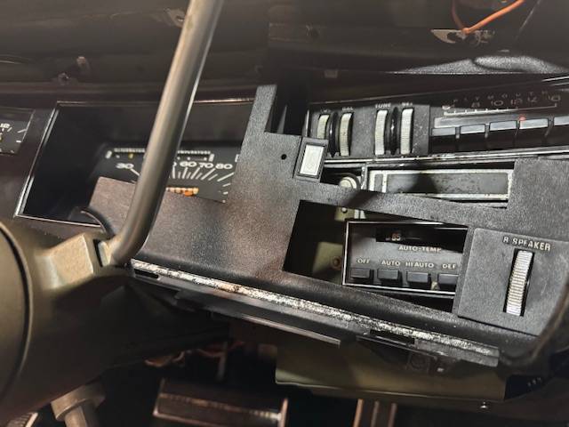

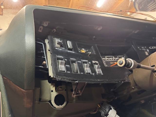

We have found the ammeter and connected the two wires on it together. But unfortunately…..smoke! So quickly disconnected ground of the battery. Could be that we touched something on the steering column as half of the dash is dismounted now. But how to proceed wisely now?

A partially burnt-out fusible link can still show 12 volts, but it won't pass enough current through it to do the job.
I would say that you have to figure out if you've shorted it. I will bet you have. Either that, or the ammeter was already burnt from a short.
I wouldn't connect any power to anything until you check for shorts.
If you got smoke only when you directly connected the ammeter leads together, then there is an excellent probability your ammeter WAS BURNT OUT TO START WITH! THIS will prevent current from passing through it, which will block most of the accessories under your dash. Read up on the "ammeter bypass." Check the resistance of that ammeter. I suspect its HIGH if not infinite by now.

Dear Mopar friends, thanks to your all for your help and advice in my problem. At last we have solved the issue. The ammeter was burned completely causing big malfunctioning in the entire electrical system. By de-assembling the instrument panel we were able to disengage the wires from them ammeter. At first we connected them together at one side of the ammeter causing the shorts we experienced. Sonnow we completely shut at the ammeter and everything works just fine. Today we will finish “rebuilding” the interior and we van headbout again. Unfortunately the weather aint that good here in Holland . Special thanks to Big John and 72Roadrunner
