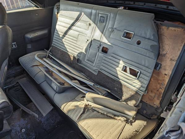

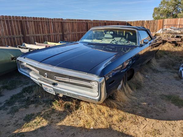

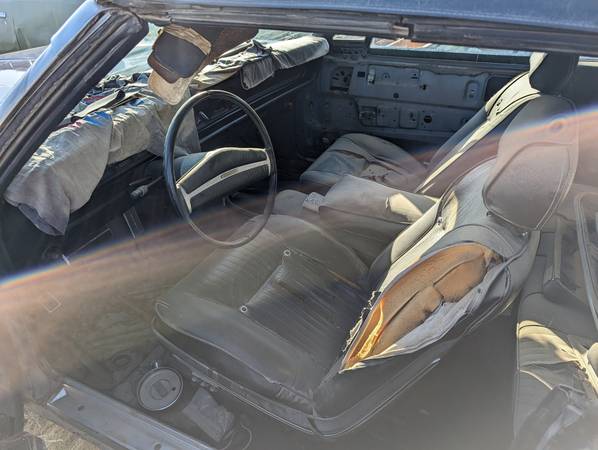

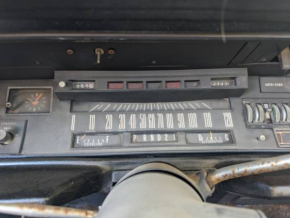

For sale: 1970 Chrysler 300 convertible, 440 engine, last year full size convertible from Chrysler, 1077 total production, dark blue metallic, black interior and black top.
All factory options except console.

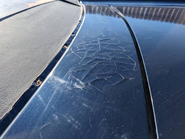

Starts, runs, drives but not driven since 2005. Needs seat covers and carpet. Bumpers need rechromed. Body and paint was done in 2008. Now paint has some defected areas. California car.
If the ad is up still available. No trades.
Clear title in my name. $16500 obo.
It’s a reasonable offer… at 1650 usd. Drop it into a restoration shop and start tearing up Franklins. Once you get past twelve hundred of them, it will begin to look very nice indeed.
It used to be a very nice car.
Responsive.

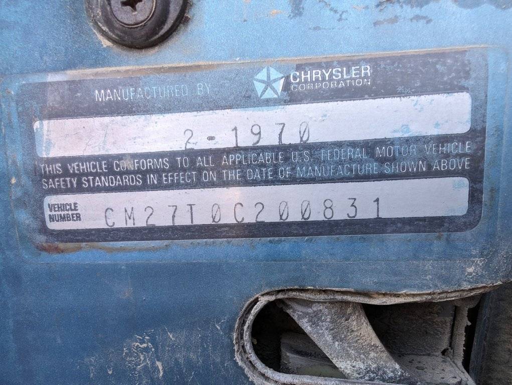

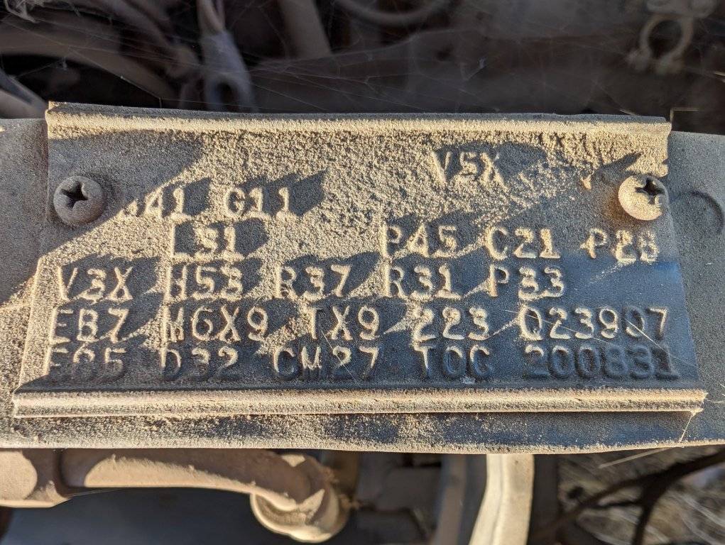

Chrysler has 440 engine with 350 horsepower. :rolleyes:
Have not found build sheet.
My question,
Wouldn't that T be either a 212 H.P. or a 225 H.P. 4 barrel engine?
Perhaps, this specific motor has been rebuilt to higher H.P. specs.
Maybe the $16500 price is AFTER the car is done. Interior, paint and so forth. Right now the original guess of $1650 is more in line with this, a borderline parts car.

in 1970 the hp rating used was gross hp so 350 hp is what the T code was rated at then.
the 212 & 225 you're using is the 1972 net hp #s.
in 71 they listed net & gross hp #s
for example, a 71 U code was rated at 370 gross & 305 net, and a 71 T code was 330 gross & 220 net.
72 they only used net hp for the most part
I concur. The '70 engines had a slightly higher compression ratio (9.7 to one versus 8.8 to one) than the '71 engines, so the horsepower rating was slightly higher, too. But what is interesting is the large difference btw the ratings, when it was in net horses.
The 1970 U-code had 375 gross, and 310 net horses (65 hp difference). The same year T-code had 350 gross, and 240 net (110 hp difference).
Same in 1971: U-code 370 gross / 305 net (65 hp difference), the T-code 330 gross / 220 net (110 hp difference).
Now, as the net horses are those that are genuine ones, and the gross hp only for the bragging rights, it is easy to see which one of those engines will leave you in the dust.
Maybe the little stick on tag for Power Locks is missing and still have the feature Who knows with that pile of parts
