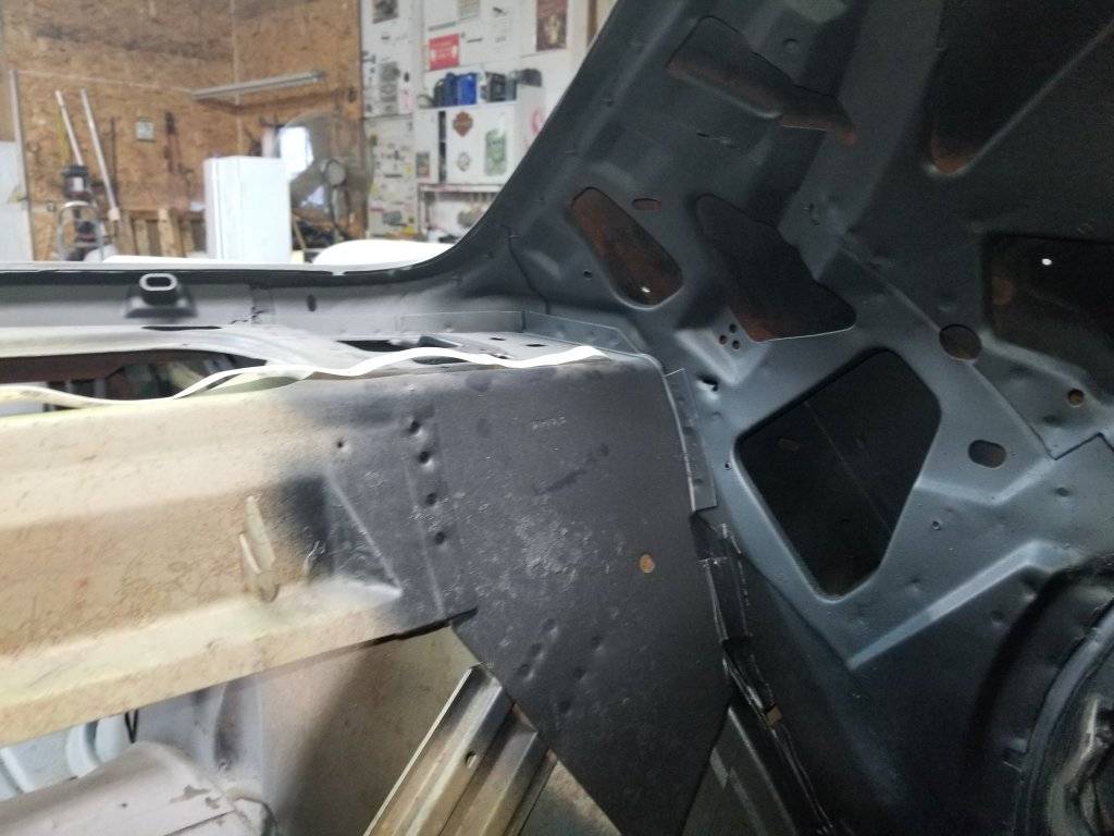

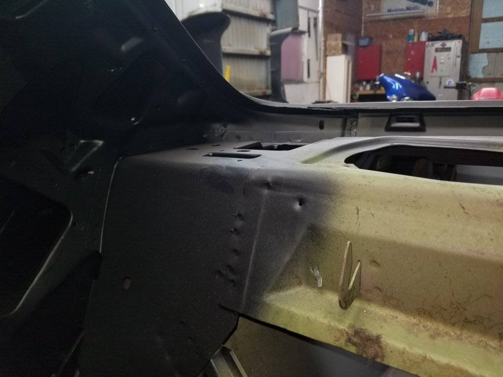

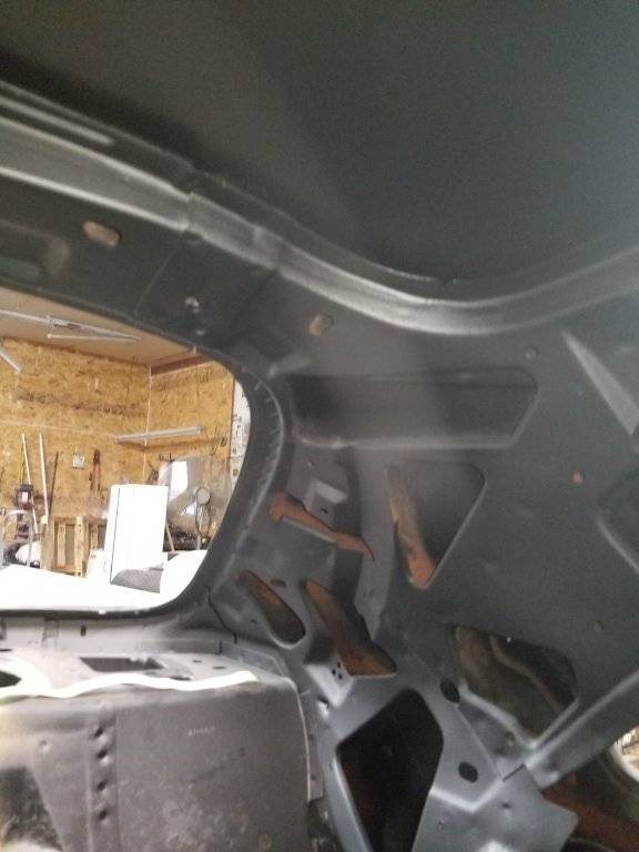

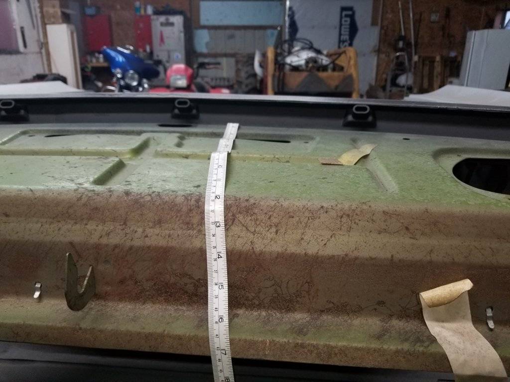

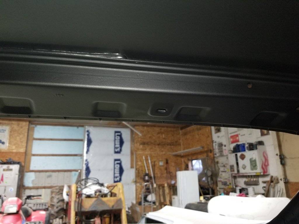

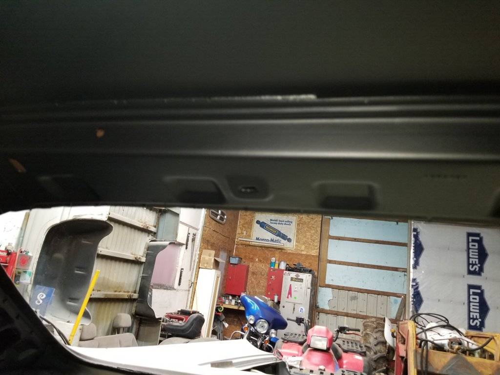

The measurements are approx 9 inches from the back toward the window off center
12 inches center. Outer edge approx 66 inches. You can convert to metric.

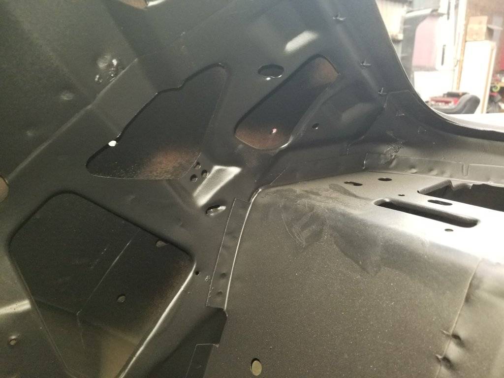

If memory serves me, the package shelf for the 4 dr is larger. That said from the pics, it appears your package shelf can be saved. It the perimeter metal around the back glass that needs to be remade.
