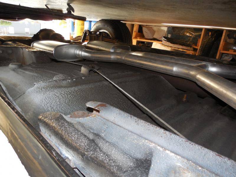

Hey Rush, nice how you manage to turn your car over to work on it, more workshops should be able to do this :poke:
The exhaust is pretty. The shop I take it to really likes to work around it actually I've haven't had to do anything under the car except for changing the starter out and I still have the stock manifolds on it so no problems .
