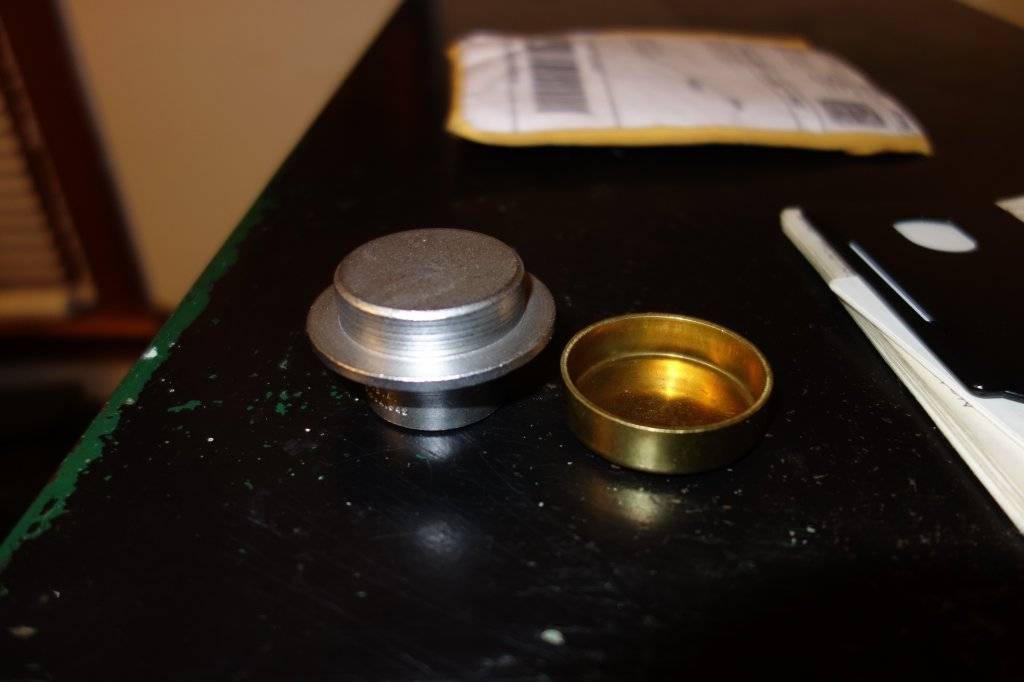

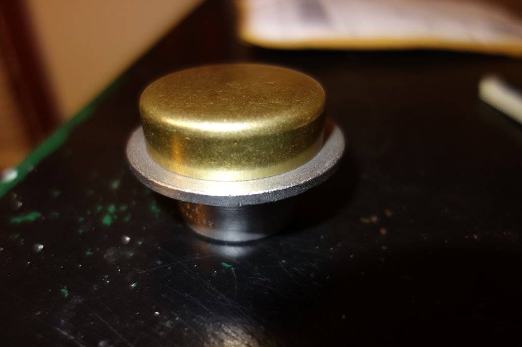

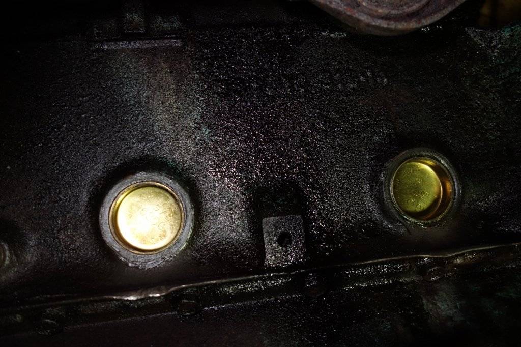

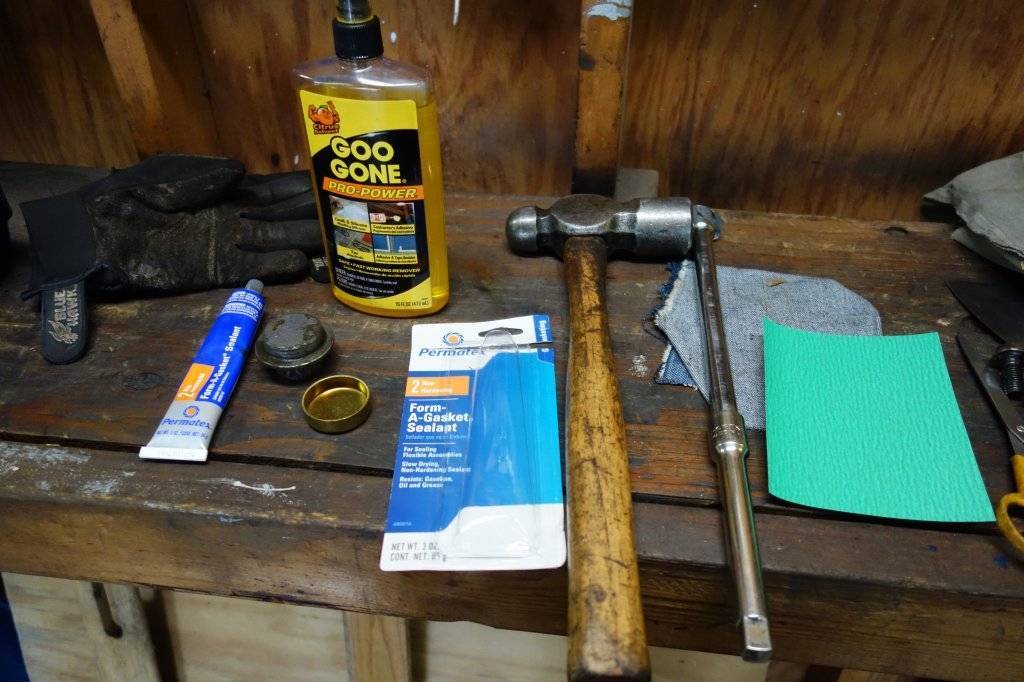

An update, I cleaned up each hole with 240 grit sandpaper. Coated mounting surface with Permatex #2 Non-Hardening Form-A-Gasket Sealant. It’s like the brush-on Aviation sealant. Then coated the mounting surface of the Dorman 1635C Brass Freeze Plug with the same sealant. I purchased the Proto 2314-4 driver on eBay for $8 including shipping (see below). I used a 10” long 1/2" extension with duct tape over end and NAPA 48 ounce sledge with Proto 2314-4 driver to drive the freeze plug in, using the outer lip of the freeze plug. I stopped when the front of the driver was flush with the side of the block. I repeated this procedure for the other holes on the side of the block. The only variation is how long I had to make the extension in order to hit it with the hammer. So far, the repair seems to be holding. Thanks 65 Sporty and Train Tech for your help.
View attachment 72867 View attachment 72868
