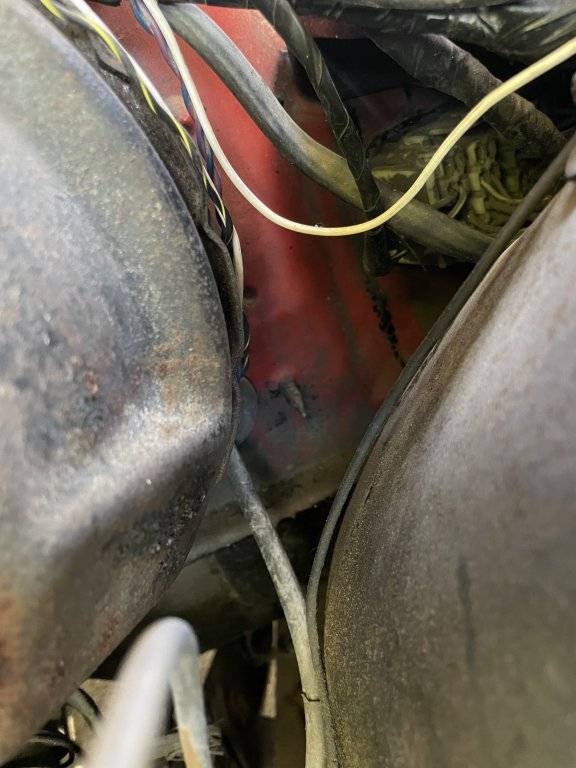

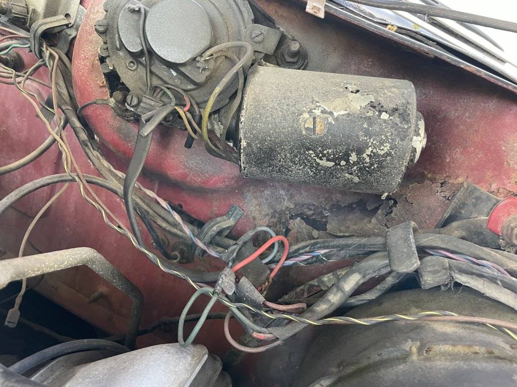

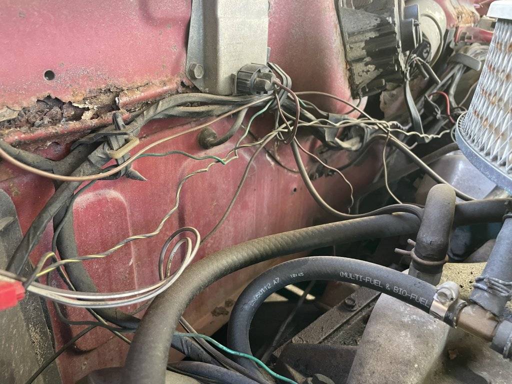

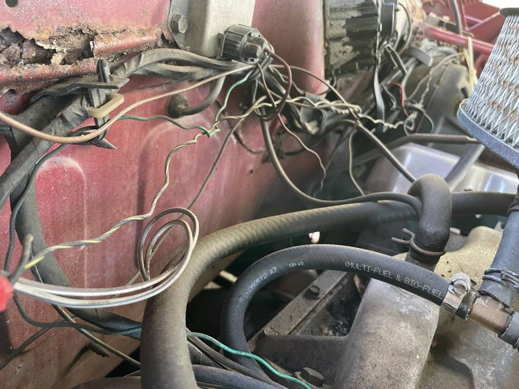

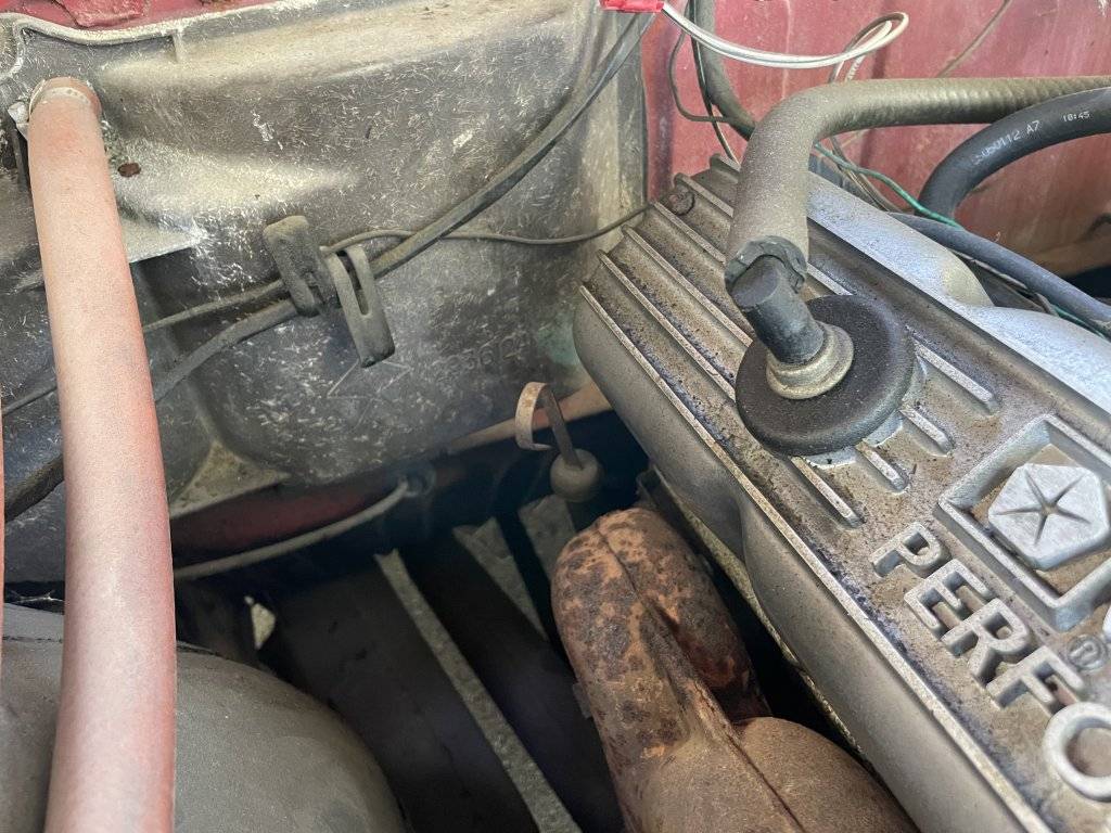

Thanks for the extra pics, pilars might be ok, trunck pics look ok also but you have to agree that the firewall is nasty.
The only thing I can suggest is remove as much as you can along the crust line, grind her down and see where you stand. asses the cancer, cut away all the bad stuff and possibly get a 3" strap that you can run the lenght of the crust line.
You may have to cut your strap in various lenghts to contour the fire wall, various lenghts would also asist in keeping the integity of the firewall . Having an anvil or I beam helps with pounding the straps into shape. Cinch down the strap (s) with tapping screws and then it would be time for some MIG welding. Princess Auto would have the metal you need.
I know it sounds tedious, but you can get this done on a budget, provided you have a MIG welder and die grinders.
Your car would present itself way better for sale.
Anyone willing to help this guy out with a possible better way of going about it; I would like to hear it also.
That is a nice car, but once they see that firewall, they get turned off.
I don't think you can fiberglass a firewall so it would have to be metal .
Just trying to help,PT
