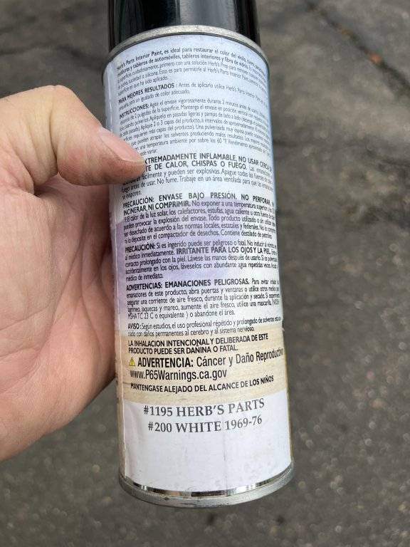

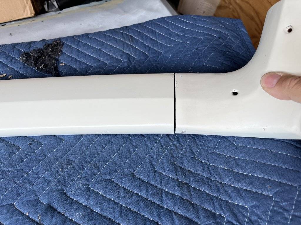

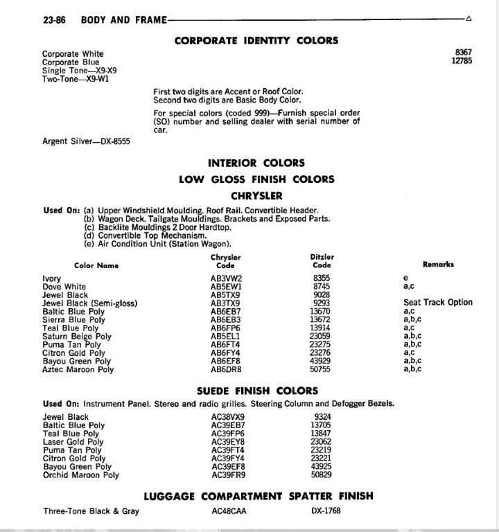

I’m going through the various white interior trim pieces and finding out a lot is discolored. A few years ago I bought a can of Herb’s paint, #200 white and decided to try it out. Just getting to spray it now and wow, this stuff is spot on. I have a few excellent original parts and the paint matches perfectly. Now I need at least 4 more cans of it.

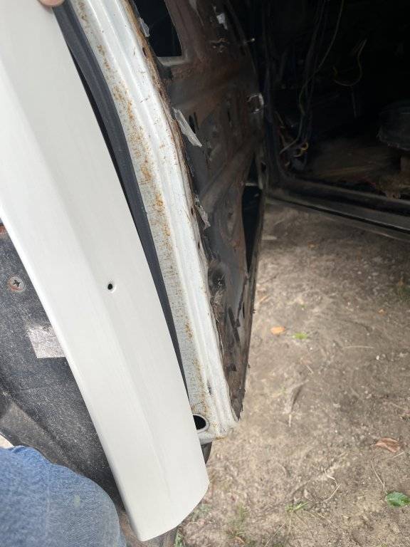

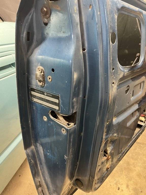

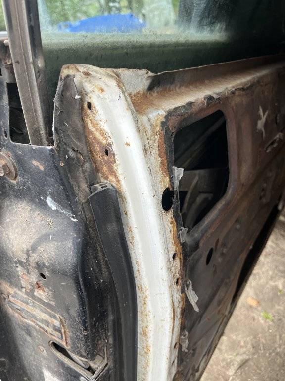

Question, is the interior trim color Spinnaker White like the white on the Hurst cars? It is certainly not bright white. I can’t find the interior trim color code in any of the paint books I have. The reason I ask is I need to jam in part of the door since I’m going with the white interior. According to the assembly book, white or black is used with white or black interior. I assumed mine would have been black, but there is no evidence of it, but the TX9 has it in white. A quick comparison of the trim and the door looks close, but Herb’s is matte finish and I need gloss.
BTW, I’ve only seen two Chryslers with the trimmed out door, my TX9, and a B7 in a for sale ad. Maybe it was eliminated mid model year to save some money. The TX9 is October ‘69 and the vert is June 70. it is a detail I don’t see and I have been looking.

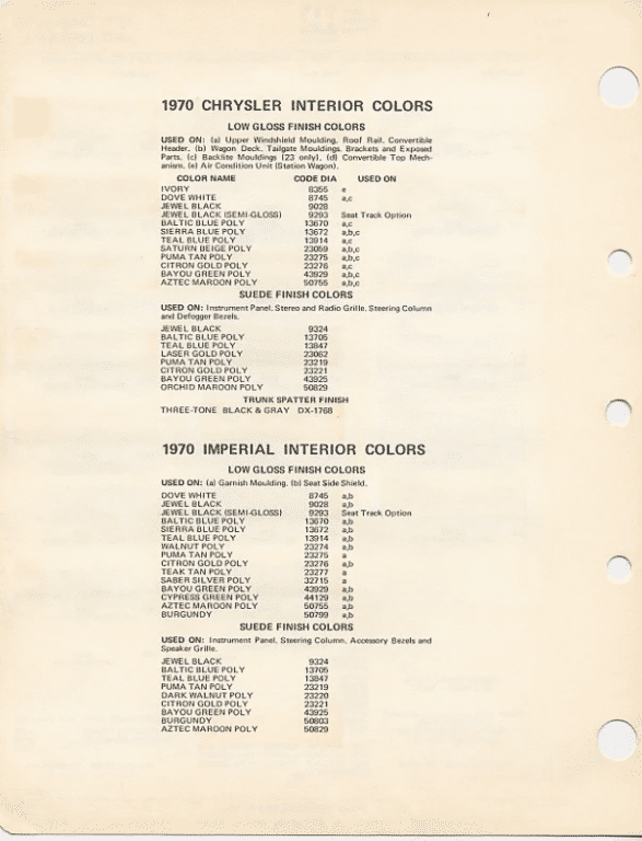

Thanks, I didn’t think to look on the back of the color chart pages. I don’t detect any evidence of Pearl coating on the seats or trim, it’s a matte off white. Question is, is it Dove or Ivory white. I’m thinking ivory. As for the door jams, I’d venture to guess that it is Spinnaker since it is on the body.
