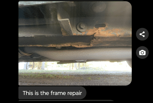

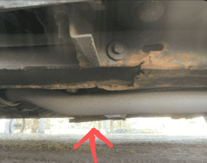

should read: This is the frame repair?!
shame. it's steel. cut out the rotten parts and weld in new steel. if done correctly it can be better than original and look like it belongs there. if that had been the case here and the buyer correctly informed, this might have been a sale.
should read: This is the frame repair?! View attachment 611021shame. it's steel. cut out the rotten parts and weld in new steel. if done correctly it can be better than original and look like it belongs there. if that had been the case here and the buyer correctly informed, this might have been a sale.
Should there not be another section of steel on the other side of the vertical bolt at the top to complete the bracing of the rail, flared towards the front and welded to the new section of steel.Looks incomplete! Looks like two different types of repairs done on either side, you see the dangle on the other side from this view.
Would these repairs pass a safety? Looks like a stub swap is possibly in order, pros please chim in!
without seeing it directly, i don't know what should or shouldn't be there other than to say that it all should be discarded. depending on so many circumstances, discarded in favor of all new work or most likely a complete subframe. what it looks like is a hacked up mess.
Yep, two different artistically licenced "repairs", the dangler is seen towards the background.
I can't imagine any competent mechanic signing their name on that safety.
Too bad for the seller that this is the case, the car looks good otherwise, I know the fella I recently used for my safety would not have passed this neither.

If u look closely in the other thread with pics of the engine bay, there is plenty of rust spots on the firewall. This stub frame deal must be just a tip of the iceberg.
I'm sure there's much more rust lurking around in hard to reach places!
If the stub looks like this, think of what the sheet metal looks like where the stub attaches. There's a lot of hidden cavities that can hold lots of accumulated dirt, gravel, salt, and all those trap moisture so the critical floor structure areas are probably compromised....
Thank you to everyone who chimed in, I ended up going with another car that I am very pleased with.
