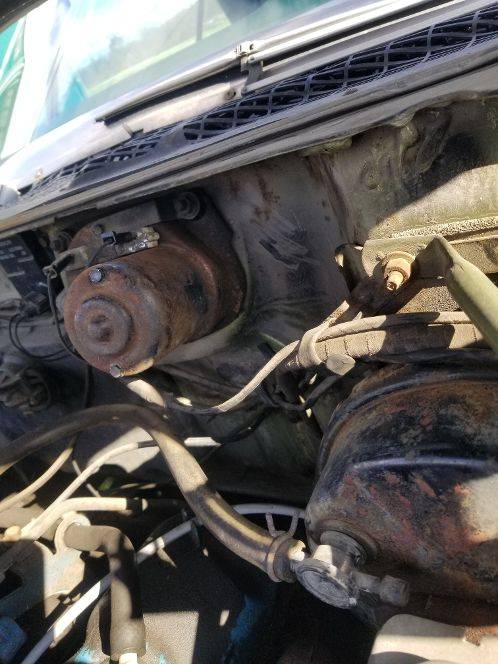

The engine is covered with oil residue .

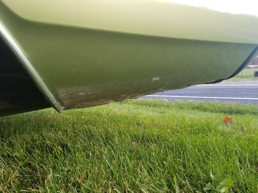

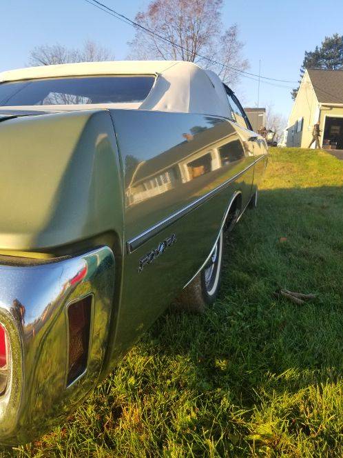

Rust starting in both quarters, not bad but its already there .

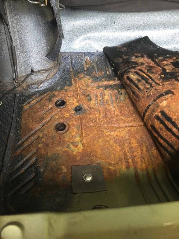

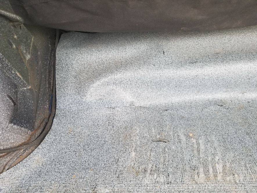

Trunk pan is starting to rust but nothing through and still very solid .

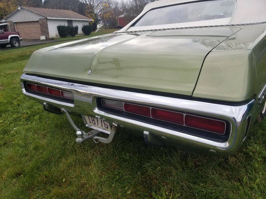

Trailer hitch bolted through the frame and trunk floor . ( Ad shows rear bumper)

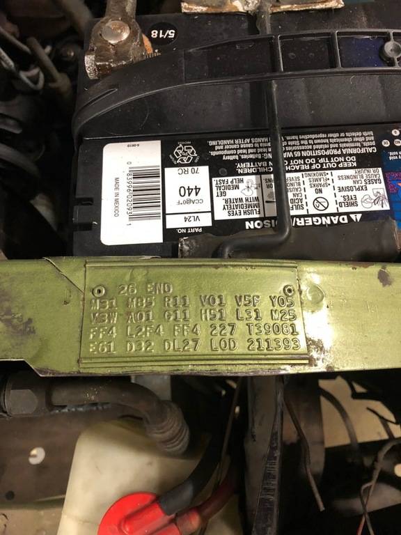

Why is thd order number have a T at the beginning? Anyone know what that means?
