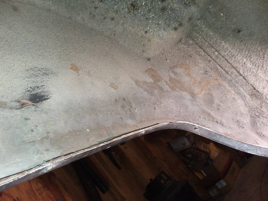

Installed Cooper Cobra 275/60 R15 tires on my 1970 Fury convertible, stock 8.75 rear. I installed them after reading on FCBO that they would fit. The one on the right side fit just fine, but the one on the left side, not so much. I installed the tire and rim, took the car for a test drive, and heard rubbing noises every time I made a left turn. I had never noticed evidence of body damage in the left rear quarter, so I was puzzled.

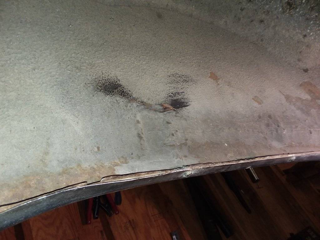

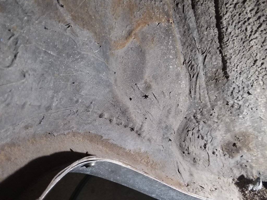

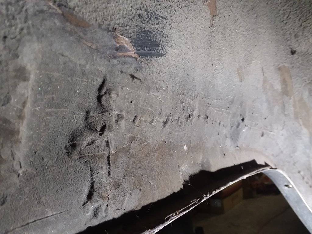

I jacked up the rear of the car, took the tire off, and looked closely at the wheel well. I got a reminder of what body repair looks like. You can also see the rub marks above the repair.

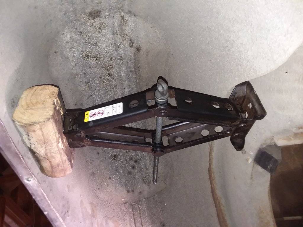

Bill @Fury440 suggested this solution. In my case, luckily, after 2 tries the rubbing stopped.
Thanks Bill for the advice. I'm also grateful that whoever hung the quarter did, at least in my opinion, a really good job. And for anyone who runs into tire rub, the pictures may indicate your problem. Just thought I'd post this is FYI.
I would like to interject here and only because I really can't get a good understanding of the photo.
Convertibles had the top of the wheel well chopped off and the vertical piece welded on to make room for the top to fold up into the trunk . I'm not sure how cleanly that was done .
I've also had in the past a couple cars that the tire ( 275) would rub on one side. Presuming the cars had some repair or damage at sometime, but one was a survivor of 30,000 miles. After posting questions on several boards it was clear to me that rears were not always 100% identical. There must have been a tolerance where it could have been 1/2 " off center or what would be considered normal and still be acceptable. .
That may not apply here as she certainly could have been damaged. I'm only offering an other view ...or possibility.
Hi Dave. @polara71 I think the seam/ridge in the left side wheel well indicates a past crash.
I certainly could be wrong, but the same area on the other side is clean and smooth.
I was just expressing my gratitude to Bill for a cheap solution to the tire rub in the left side wheel well.

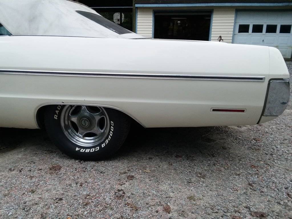

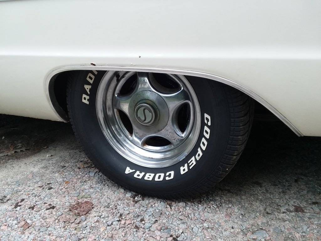

Pics of non-rubbing tire today
I have to say that @Aidan1976 rec for rear tire size filled the wheel wheel nicely. Thanks, Aidan.

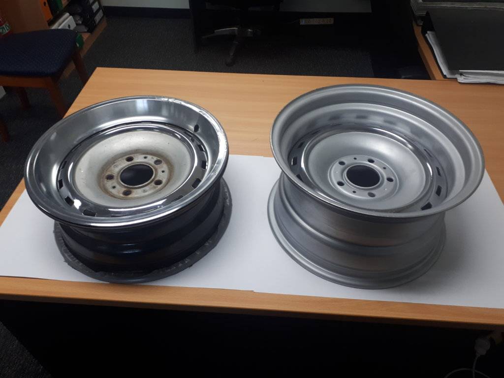

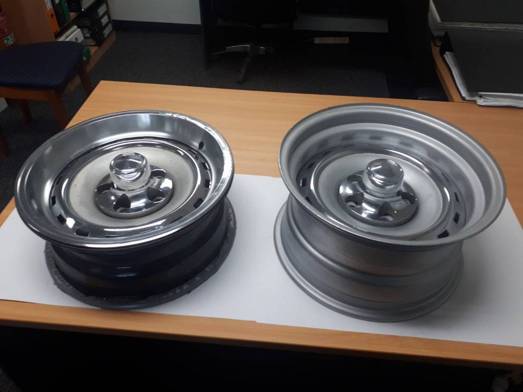

Older thread but seems like a good place to add my experience on my 69. I used one of those $ wheelrite plastic tools to measure correctly. I didn't. In the back is 275/55-17 (29" tall tire) on a 17X9 rim and I got greedy and wanted as deep a wheel as I could get. I could do this because I bought a tool damn it. Measured many times with weight on the axle and got 4.5" back space. So on 10" wide wheel (includes lip) it was 5.5" front depth and 4.5" back depth. Drivers side fit good but I was worried that tire bulge might rub on SS wheel trim so took a grinder to $$ trim and lip. The passenger side rubbed no matter the trimming. Turns out I did most of measuring on the drivers side not thinking the rear end might not be centered. Another wheel at 5.25" back space fixed it. In retrospect 5" backspace on a 17X9 wheel would have worked on both sides. Don't be greedy! I had no issues with rubbing other than the lip. Of course I have not loaded it with 6 people or bags of mulch!
Fronts were 255/55-17 (28" tall) on 17X8 with 4" backspace. So on 9" wide wheel (includes lip) it was 5" front depth and 4" back depth. Worked great. No rubbing even at full lock. For both front and back I was less worried about overall height and more worried about getting some sidewall. Back has 6" sidewall and front 5". Very close to stock. For reference a 235/75-15 is also 29" tall with almost 7" sidewall. Fronts look a bit big but backs are exactly as I wanted them. When you cover part of the tire with body or skirt it masks the overall diameter.

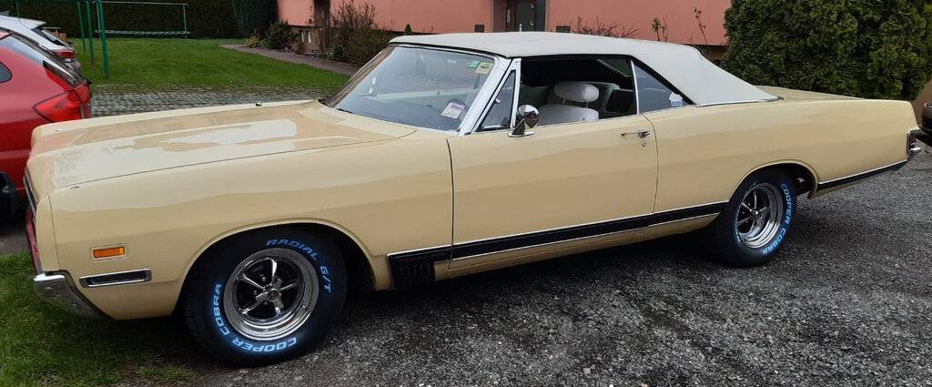

@1970FuryConv how happy are you with the Cooper Cobra tires? I´m getting ready to replace my BFGoodride after 10 years and this Cooper brand is their alternative. I run the same size, 235/70R15 in front and 275/60R15 in the back. No clearance issues, the 69 models have a narrower rear end.

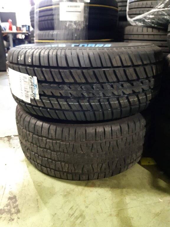

I finally replaced BFgs with a new Cooper Cobras. The weather was close to freezing, so it was just a quick ride to the shop and back. Will remove the blue colour from the letters once warm up.
One detail I want to point out is the tire pattern being different. Cooper Cobras pattern is like a modern tire compare to BFgs and they have also 1 step higher max speed rating T.
