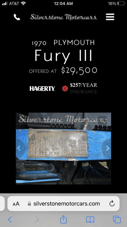

1970 Plymouth Fury III Convertible | eBay

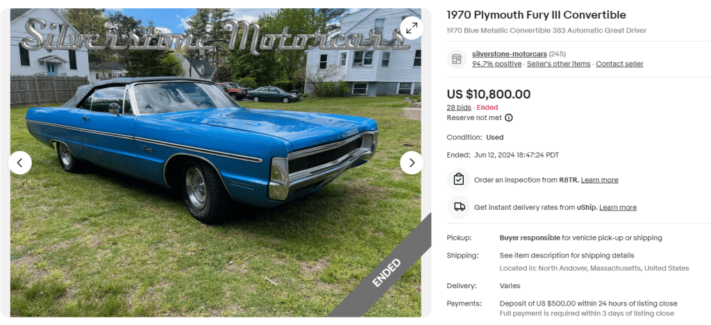

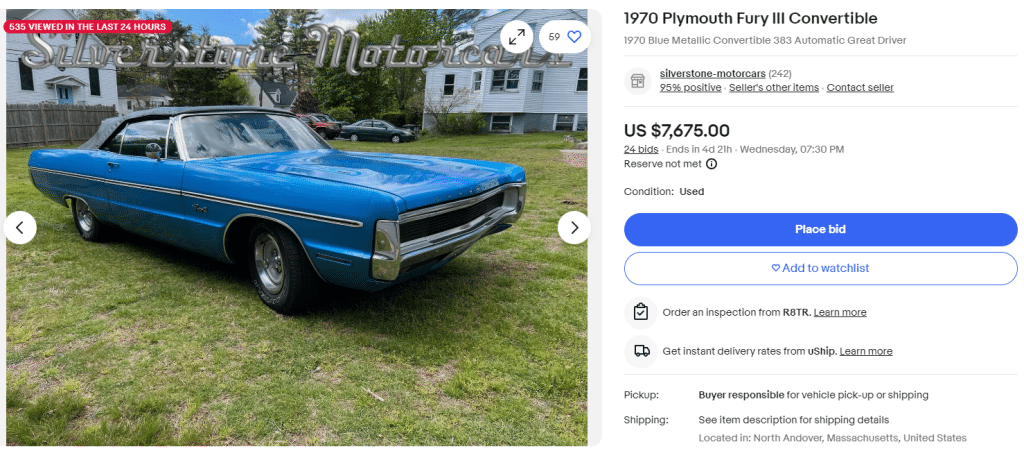

Seems like they are being more realistic and now auctioning it, albeit the reserve might be that ridiculous $29,500.

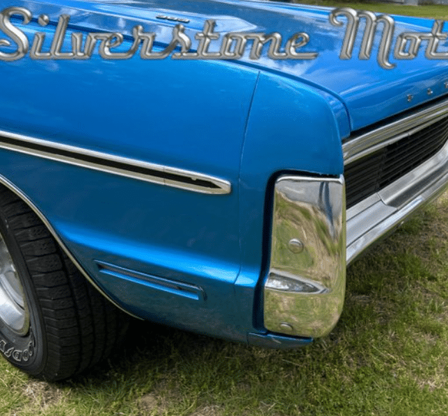

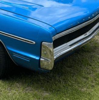

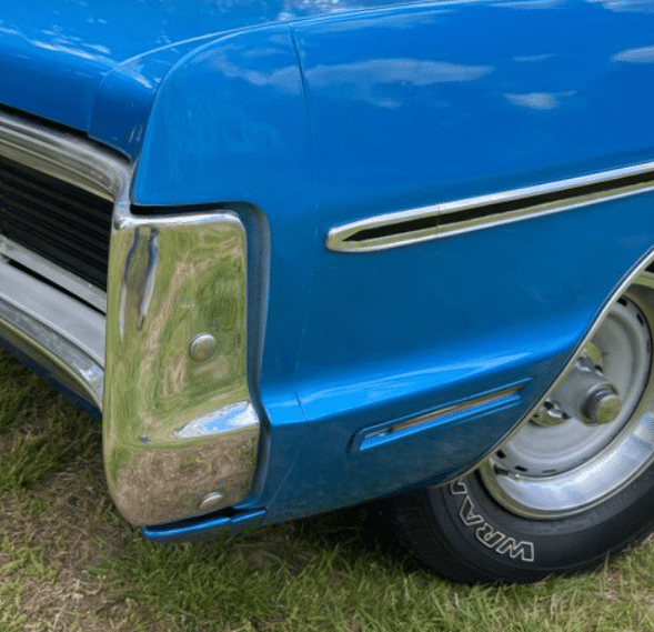

Both bumpers are slightly twisted. Passenger front corner, drivers rear corner.
Poor paint coverage behind drivers front bumper corner.
Body side molding inserts are missing and painted black.

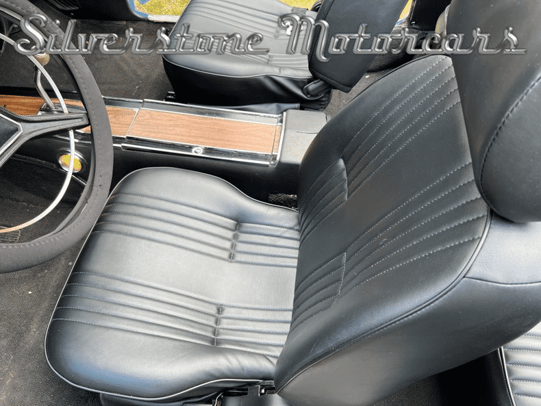

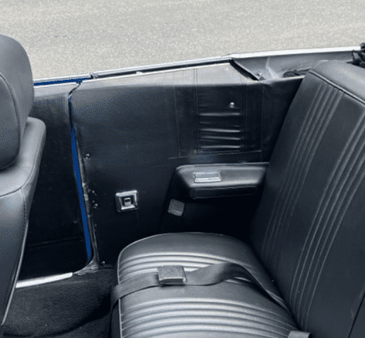

Front seats are incorrect but at least back seat recovered to match. This is the only improvement I see from last time it was for sale. Loss of orig front seats deletes the value of recovering, though.

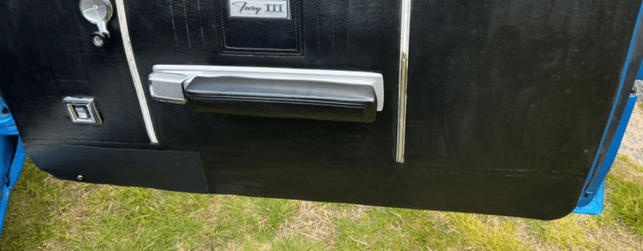

Door panels in poor condition, look like they've been shiny-wiped with dust still on them.
Screws holding the PW master switch.

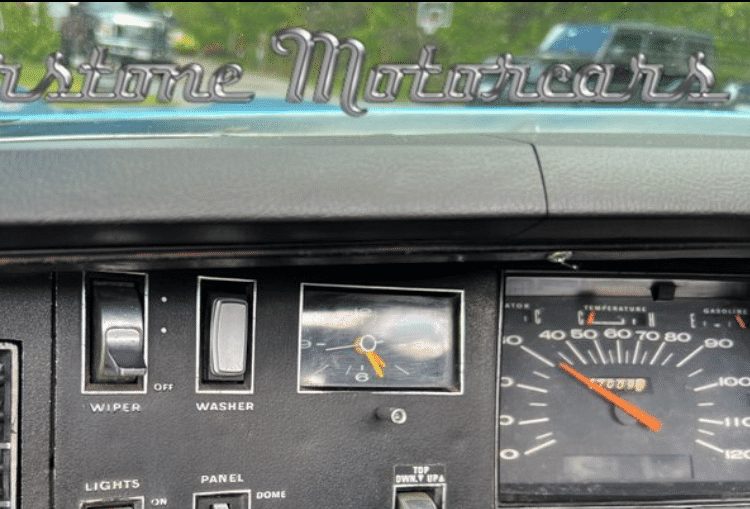

Car's doing 30mph while sitting still.

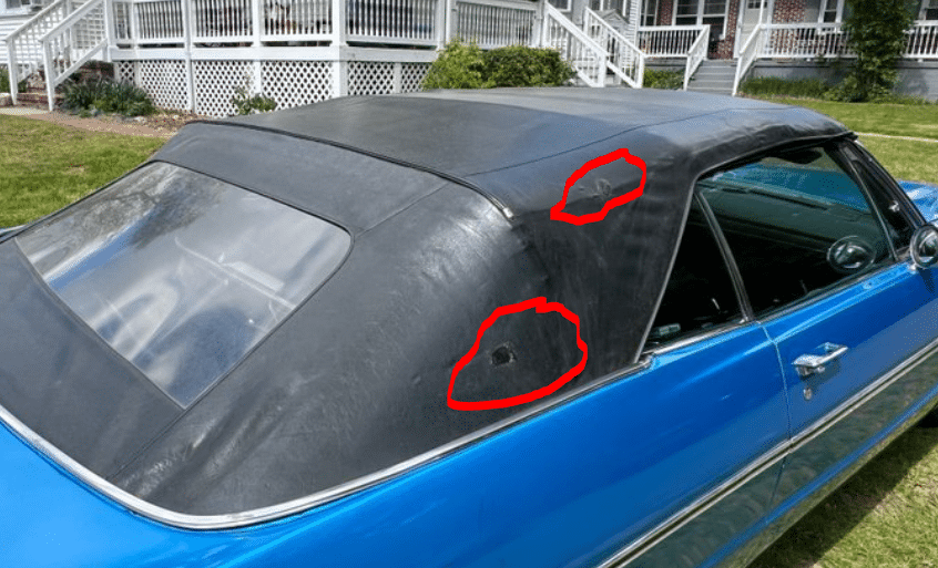

Top is serviceable but not appropriate for a higher-dollar car.
Non-seller, in May and then in June.

PM27N0D106955
