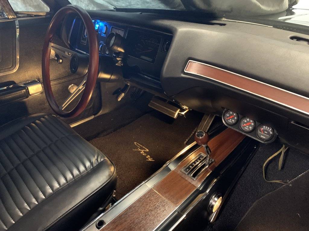

I redid my insert when I got a new pad from Bob. One of locating studs was cracked off so I glued it. Sanded the original lumpy cracked vinyl down trying to avoid the edges. Painted gloss black but had a couple problems with whatever residue/adhesive was behind the original vinyl and had to repaint with primer and a little glazing putty. I wanted a smooth surface because the new vinyl shows a lot. Chrome edges redone with Molotow chrome pen. For new vinyl I wasn’t trying to match original, just looked for something with a red tinge between my reddish aftermarket steering wheel and my kinda faded brown console. I bought 2 kinds before finding the right color and woodgrain type – less lines more dots. I didn’t trust the adhesive on the vinyl alone so painted on some weldwood permanent contact cement first. Got the shape close with scissors and then a new exacto blade. I still ended with a few not great edges and not entirely original but I’m happy.
