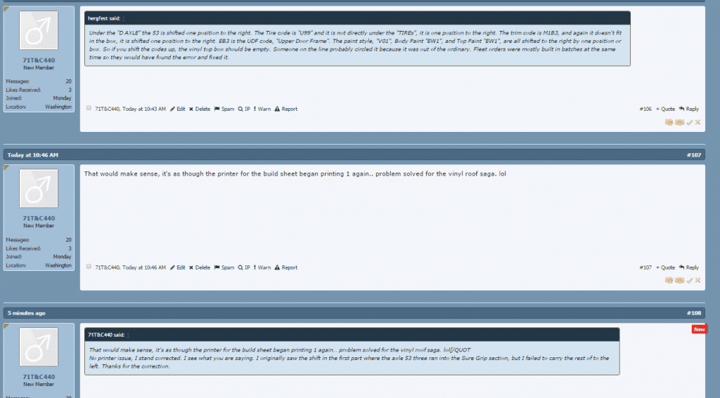

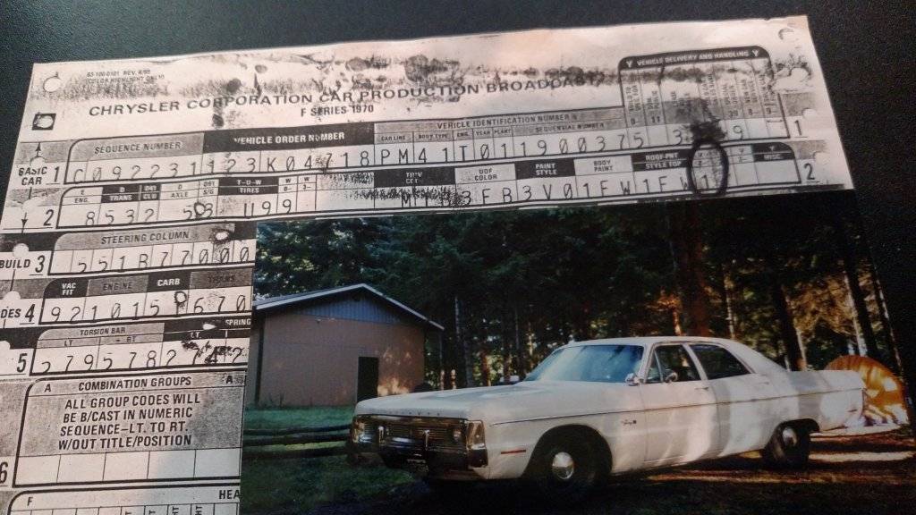

I triple checked the info by Galen Govier and it does not mention a vinyl roof at all. That is what I went by in determining to replace the cars vinyl roof or not. Does anyone know if a supervisors car had the blue vinyl roof in that year. I did also check and it came with rear bumper guards like the front ones. I'm glad I found a NOS pair on Ebay years ago.

what are the chances that the vinyl roof was put on when the car was taken out of service to cover antenna and spotlight holes before being sold to the public?
