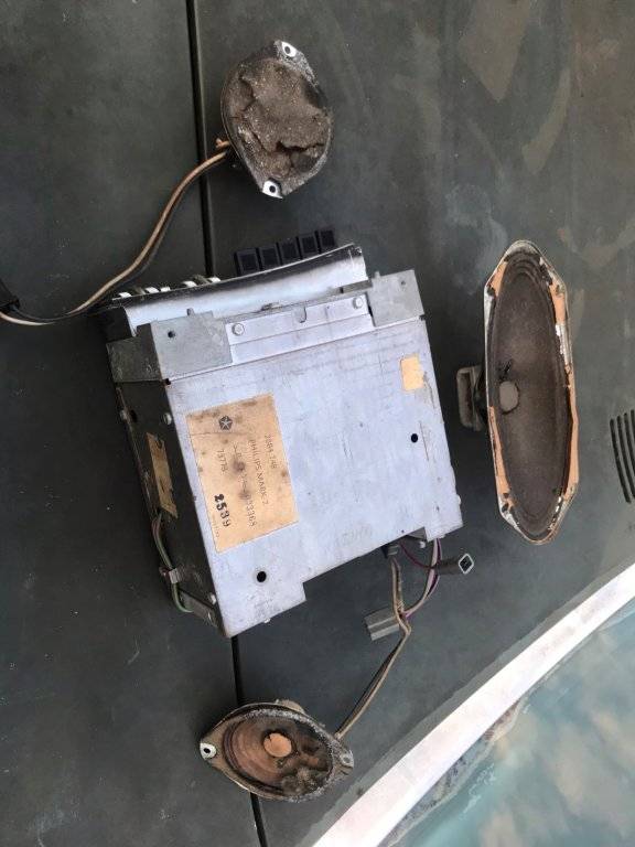

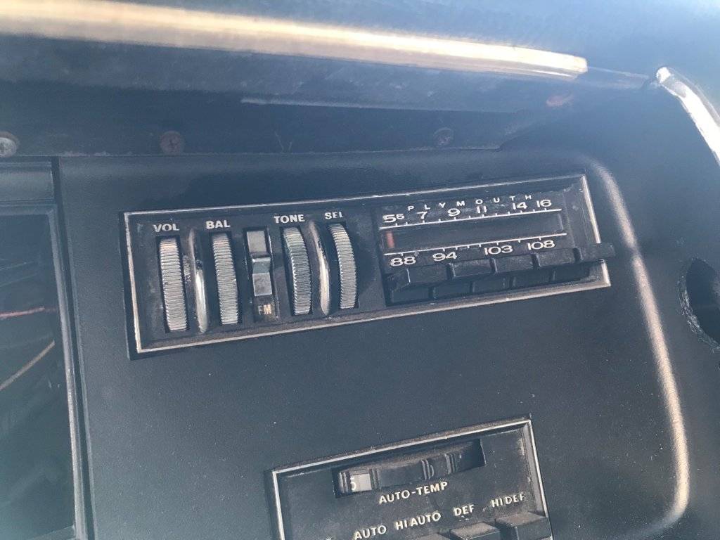

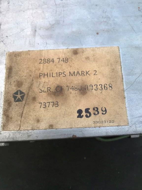

Thinking about selling the original stereo for the Sport Fury. With my gauge modification the dash isn't going to look stock anyway so I figured someone that is trying to restore to original could use it.
I would like to know if it works before I list it for sale. My question is how can I bench test it? It is still in the car and when I turn the ignition on or off it has a small pop sound in the speaker. Turning any of the wheels doesn't change anything.
I think the car has all the original speakers also so will probably sell everything as a set.

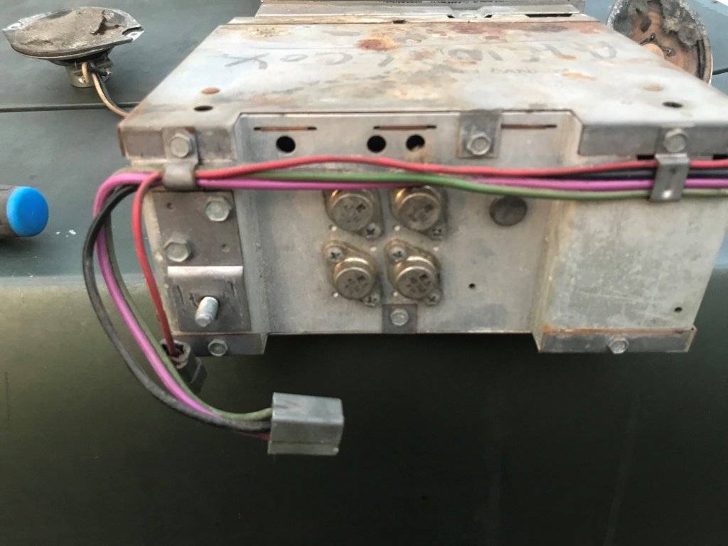

Usually on the rear of the radio there are 4 round metal covered transistors back there if it is a stereo and only 2 if it not stereo. If you still have the dashpanel that radio came out of it will have a 3 speaker dash panel if stereo, and not just the single speaker.

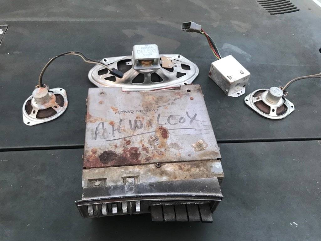

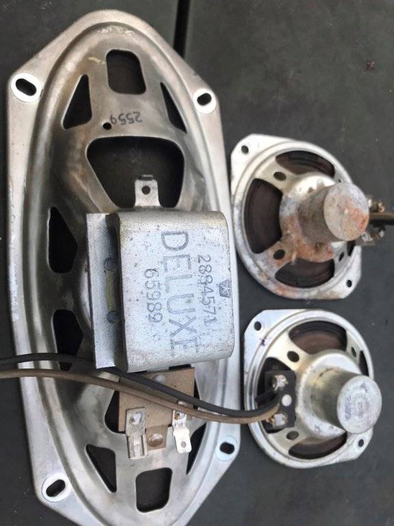

Ok it is a 4 transistor with 3 speakers and a cross over.
I pulled it out and with power on the red lead, ground on the case and a spare antenna hooked up I got a 3 ohm house speaker to buzz but I can't say it will pick up any stations. I don't know if a 3 ohm speaker is the problem or it is the stereo.
The selector moves the needle and all the push buttons work.

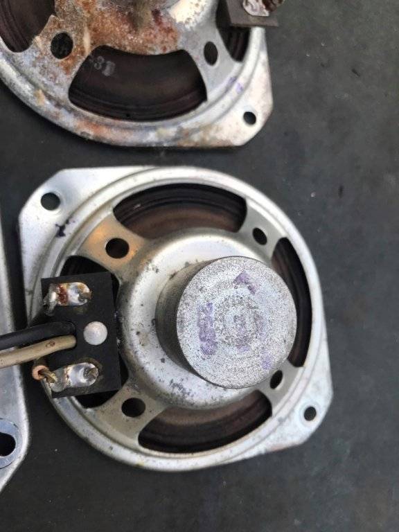

All 3 speakers the paper cones are shot.
I don't know how to test the cross over.
